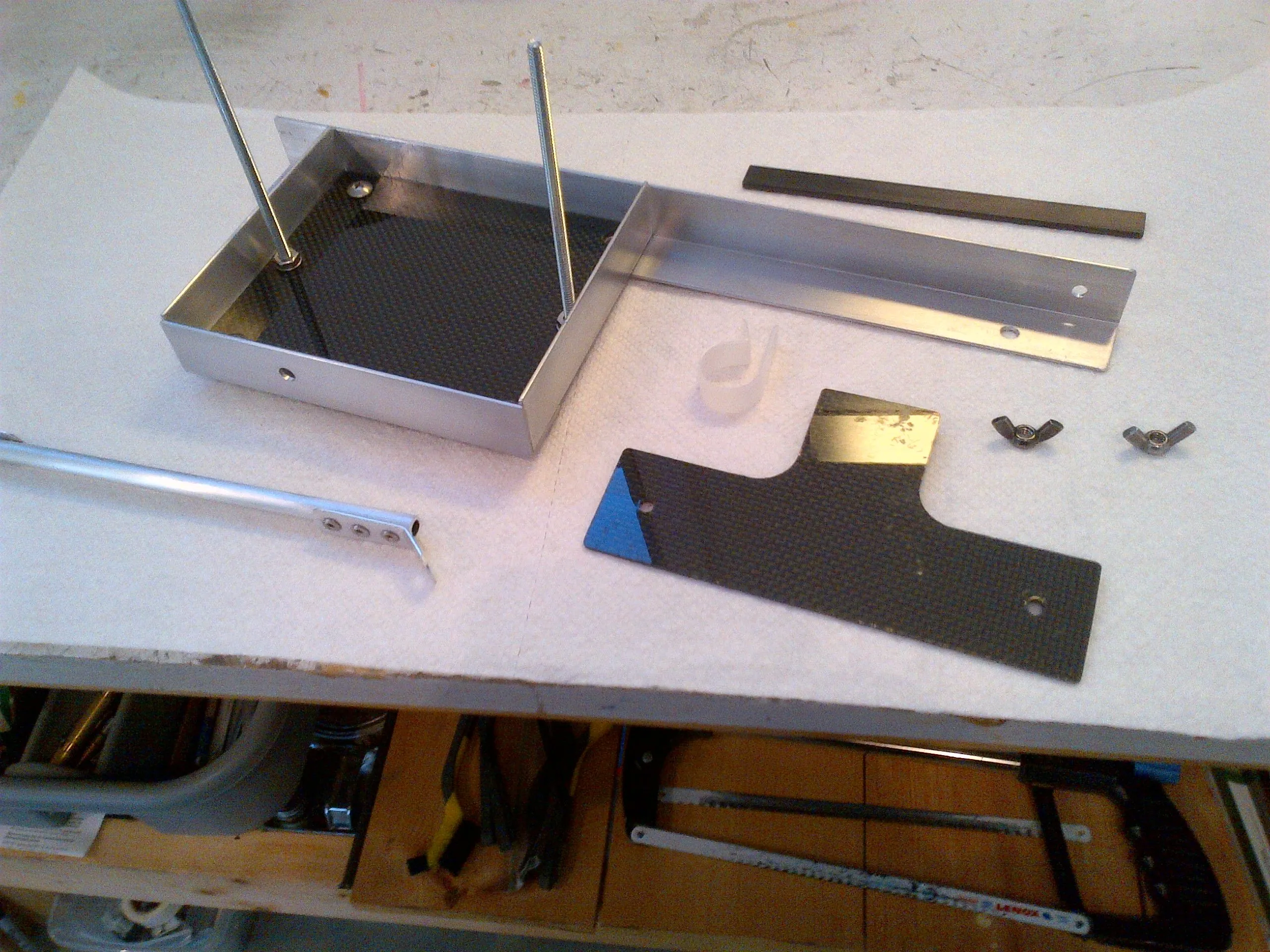

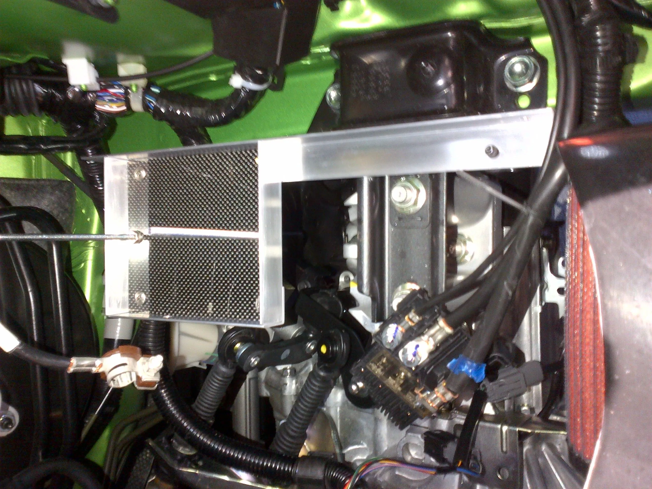

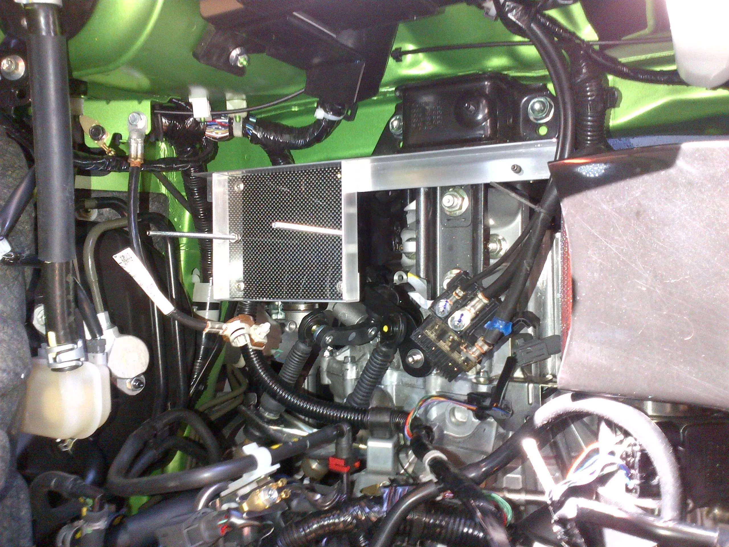

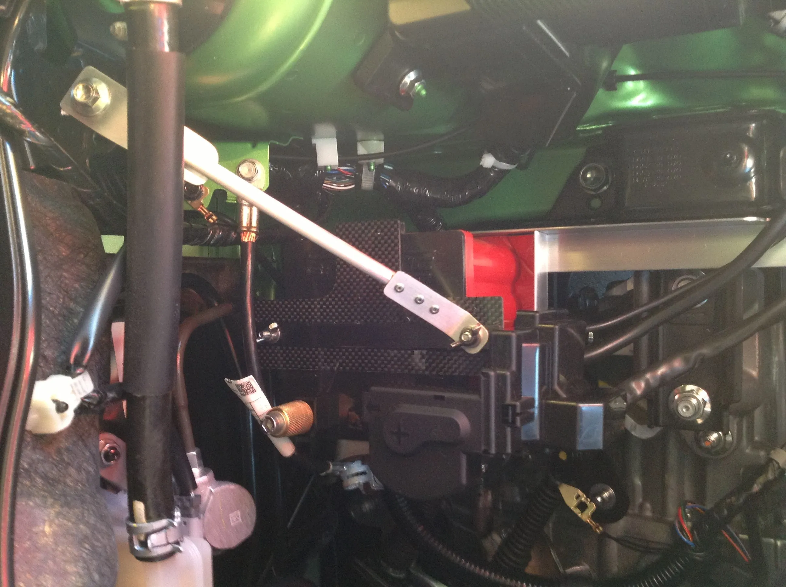

I made this aluminum and carbon fiber battery mount for a Ballistic 3.5 lb. battery - net savings 25 lbs.

I have a Braille in my current daily driver 11.5 lbs., 3 or 4 years old, never fails to start the car no matter how cold. Along with reducing weight I was trying to free up space for a future project and the lithium battery is very small. The lithium batteries are expensive but if you look at the cost per pound of weight savings they are pretty good. I was also able to move the battery back a bit.
Very pretty, and solid work. I've never thought about using flat stock & tubing like that.
It seems like a missed opportunity though, unless I'm just not seeing it in your pictures, to move the battery much lower in addition to farther back. Was there not as much room back there as I'm thinking?
The problem is length and routing of the pos. cables, Could be overcome with rerouting or fabricating an extension plate on the battery post. I am simply running out of time, as I noted elseware I have 2 major engine builds underway and I want to have the 2 ready for track duty by spring. I have a list of parts that I plan to fabricate to reduce weight as time permits.
Mine is probably overkill but I stole it out of my Mazda 3 just to get the project done. Looking at different lithium for the 3. I used a 1.25 lb lith. in my 250 honda all summer and it worked flawlessly. Great technology.
