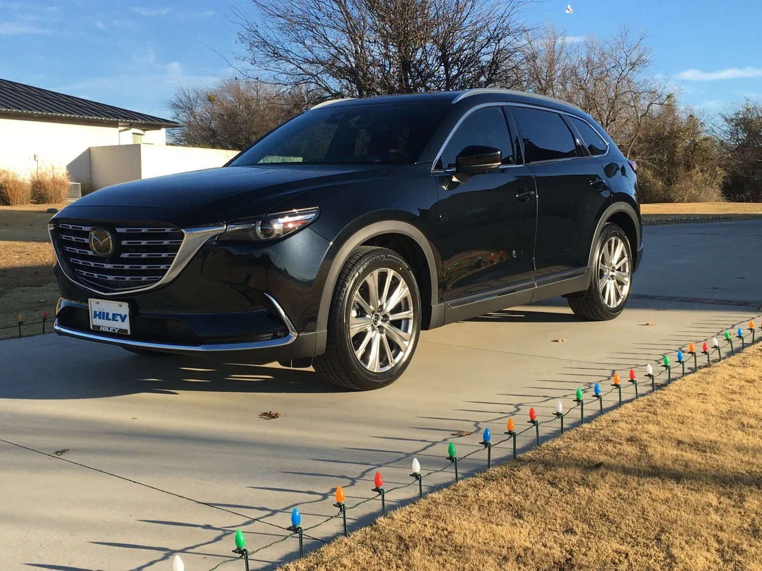

I just picked up a 2021 Black CX-9 Signature and I love it! I was overlooking Mazda as I’ve been car searching for the past 3-4 months. All it took was one visit to the dealer and I was in love. I test drove a few different models, and then had the wife test drive the CX-9 too a few days later. Got the deal done last night!

congrats on the new ride! Looks really nice...you’ll enjoy it as I have mine (4years now).
