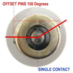

I guess the joke is on me. For whatever reason the 1156 Amber didn't work. Looks like the little pins on the bulb need to be at a slight angle with the diameter, if that makes sense.
I guess it makes sense, so you can't stick a clear bulb into the amber socket. The euro code for it is PY21W. Probably can't get it locally. For whatever reason, some sources equate this bulb with an 1156, but it's not the same in practice.

I think Reg had the same issue. They are 1056 I believe. If the socket fits, my solution would be to get an 1156 socket (from your oem tails) and solder it to the JDM tails.

Local parts store has the 7507 bulbs. They are the offset pin bulbs. I'll go get them over lunch and report back.
From what I understand, it's a pretty common euro bulb that goes into Audi/VW and the like.

Yes, it's the turn signal. The 7507 bulbs I got over lunch worked in the turn signal. My lights are ready for installation. Now I just hope they light up like they're supposed to ;)
