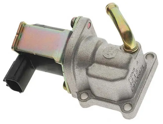

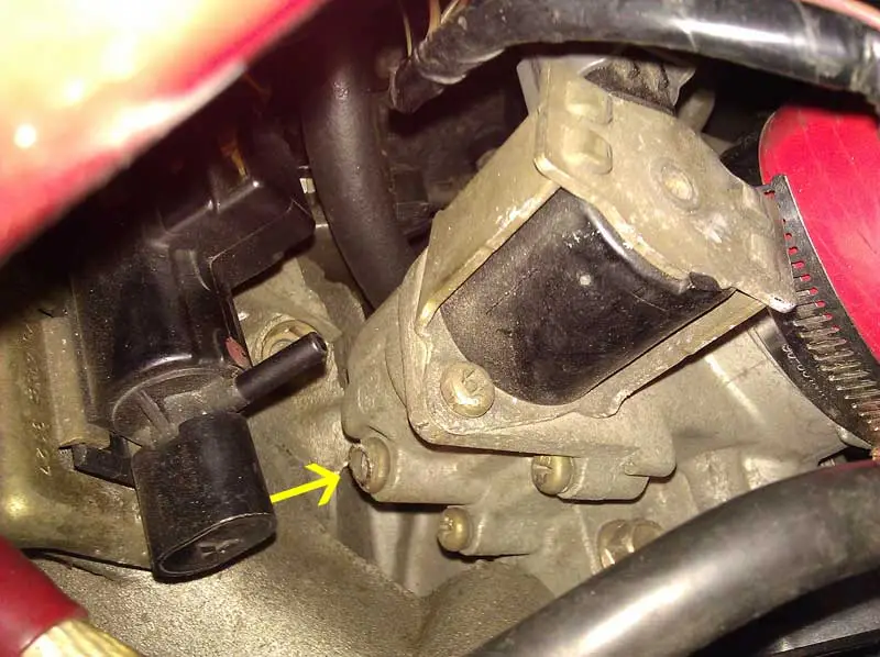

Okay, I went out to clean it and I noticed there is a piece broken off of the IAC Valve.
Here is a pic of one I found online compared to mine. You can see where I drew the yellow arrow there is a piece missing, which looks like it would have a hose attached to it. What would the other end of that hose be attached to?
(btw on the pic of my IAC the black nub above it is missing a rubber hose-- I know, I slid it off to get a better picture-- it's not really missing).

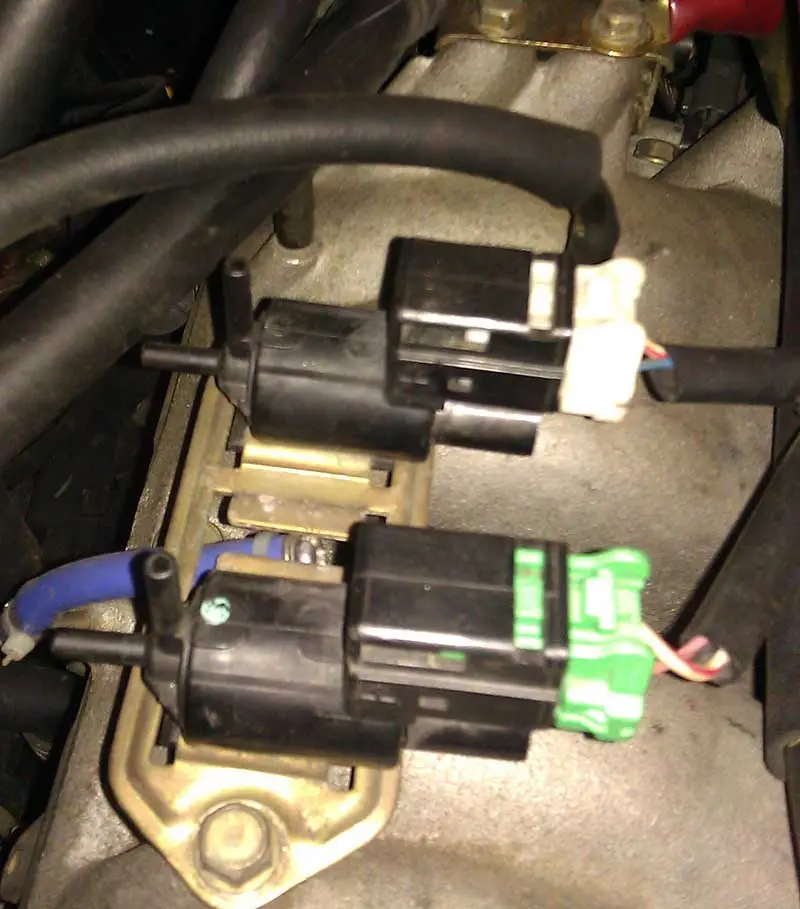

its supposed to keep the throttle plate from sticking in cold weather, i bypassed mine and use that line for my coolant temp sender, take a quick look at the passneger side of your intake manifold, there should be 2 sensors that look exactly the same right above the mani
yeah, they are there and the electrical connectors are attached, but there are no hoses attached to them.
hmmm im gonna say that may be your problem, it could also be a bad sensor, i assume you have no cel, maybe run a scanner and see if you have any codes that wont cause a cel, i had the same problem i replaced both of those sensors and never had a problem ever again, i believe the stored code was a p0660 or something like that something about manifold pressure bla h blah dont quiet remember the full details
thanks. you are correct, i have no CEL. i'll see if i can get it scanned, of course I unhooked the battery and reset everything, so I'll wait and make sure it does it again first. do you think i should have hoses hooked up to them or just replace them and leave them attached to nothing if I have the stored code? thanks again for your help and input.
let me go take a quick pic of mine because i believe they are linked to the intake mani....brb
