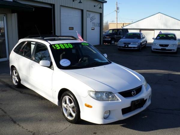

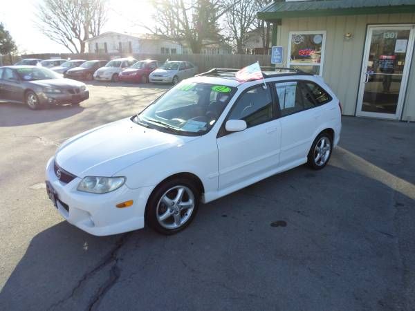

Here are some of the dealer photos of the car. I won't be paying anything remotely close to the sticker price. It's got a clean carfax, 3 owners, and dealer maintenance up until 100k.

I fixed the photos.

That is a really clean looking protege5.

Probably looks really good compared to what rolls around in your neck of the woods. :D I'm really glad to not be in the major rust belt.
The dealer is supposed to call tomorrow and tell me whether it passes inspection or not. If it passes, the deal is done and I will pick it up later this week. If not, we'll go from there. We don't have emissions testing here so I don't see any reason why it wouldn't pass.

I need to move to your state :p
Although, these cars typically have no issue passing emissions. It is usually safety due to wheel bearings or rust that they fail to pass.
