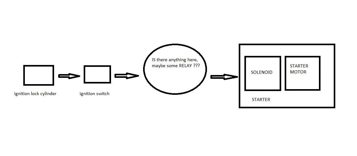

I looked everywhere, shop manual, forums, you name it. I'm exhausted, i was thinking maybe starter has intermittent problem, i don't know. Is there a some kind of a relay on our cars that it located in between starter and ignition switch.

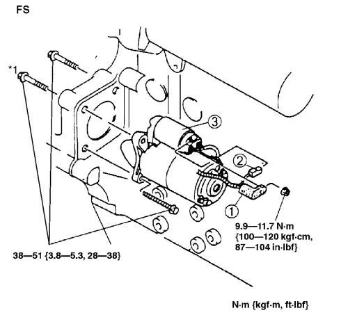

Replaced ignition switch yesterday, Problem is still there, so should I pony up cash for new starter, can I test it some how while its on the car, maybe measure voltage on Terminal 1 and 2 on pic below, how is that done by the way.

Test the terminals, forgot that I have had the power wire going from switch to starter mess up in both my protege and 323. Although if it is the starter there's no way to tell. Make sure it's supported and tap the starter with a hammer next time

test the voltage to the starter, if it's weak try using it to trigger a relay for good solid power to starter.
Or bypass everything like I did. Run a wire from battery to button to starter. Saves the hassle of any sort of diagnosis
It could also be a bad ground connection at the opposite end of the battery cable.
Sent from my Windows Phone 8X by HTC using Tapatalk
There should be 12 volts to the starter when turning the ignition switch. If there isn't, make sure the ignition switch has 12 volts (input). Backtrack until you find the problem area. Worse case - take it to an auto electric shop. They are the pros.
