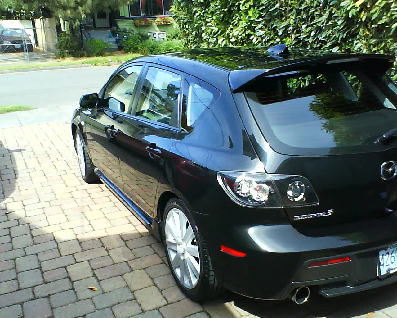

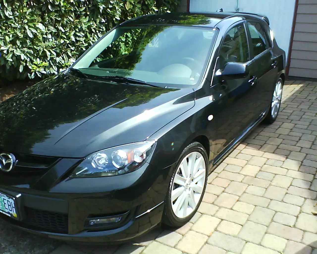

I did this yesterday. Just parked it in the sun for a couple of hours, then pulled them off slowly. After a wash and a wax, you'd never know they were there.

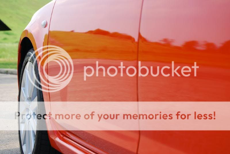

Saskatchewan17's How to on removing side moldings:
Grip and rip!
You'll get results like this:
(that one spot is wax I didn't take off right haha)
I also tried the "Grip and Rip" method and ended up spending approx. 2 hours removing alllll of the adhesive that was left on my car. "Goof Off" is a must if you do this little project. Also patience.
