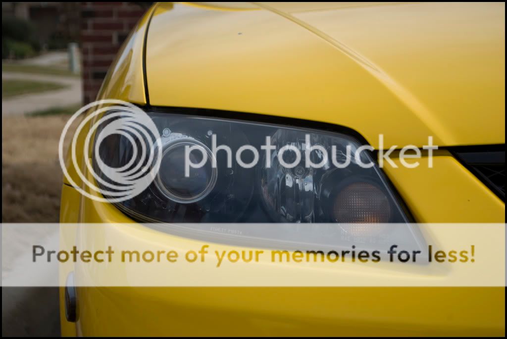

Some more daytime pics:

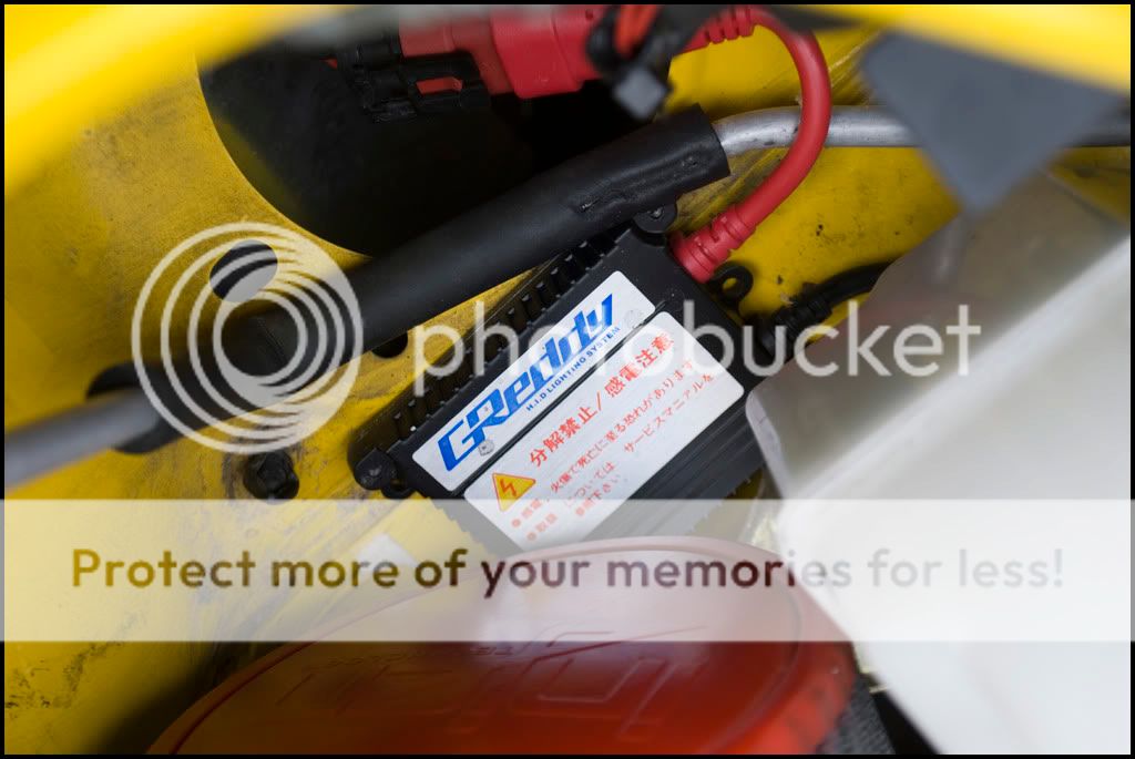

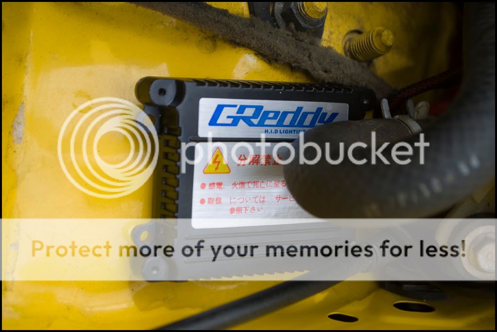

You probably could've secured those ballasts better. There's a nice spot on both sides behind the bumper, right above the washer fluid tank on the passenger side and above the fog light on the driver side. There are a couple bolts on both sides that you can just slip the ballast onto and secure it with a couple nuts. Just a thought..
I would put them there, however having to take a bumper off to get to the ballasts isn't very practical. The ballasts are double sticky taped onto the body and they aren't going anywhere. It may not look pretty but they are easily accessible.
exactly why I didn't do this.

It can be done but it's really a waste of time. If you saw my lights in person you would know why. I'm gonna try to get a driving video tonight.
Sorry but I'm a little confused about this whole bi-xenon thing. Did you not put the HID bulb inside the projector housing? What are you using for your high and low beams?
BTW, those are by far the nicest headlights i've seen on a P5 anywhere.
