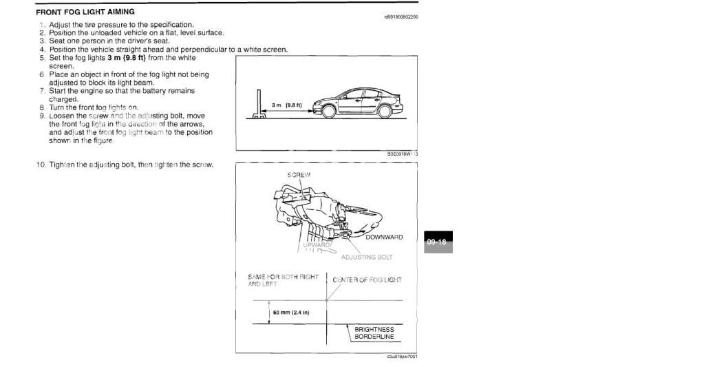

well i finaly have info on how to on fogs
