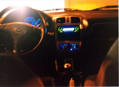

heres a pic from a while back.
<img src="http://www.msprotege.com/forum/attachment.php?attachmentid=30023">
i snap some pics after it gets dark, everything but the cruise, CEL, and seatbelt lights is blue definitely need the string for side brightness
awesome man, do you have a larger pic? i would like to see it in a bit better detail
thanks!

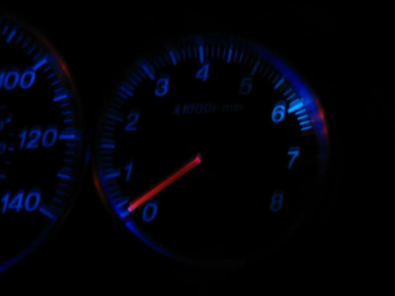

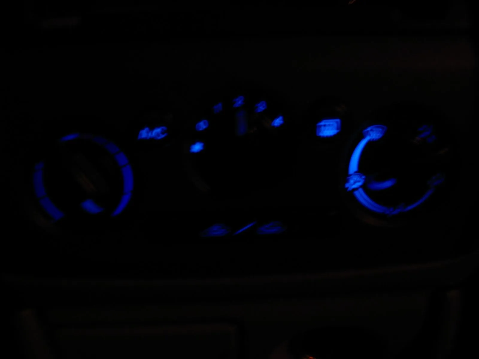

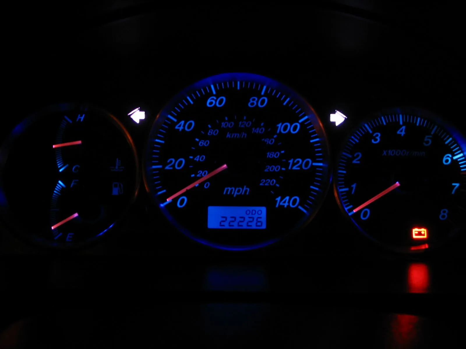

pics as promised. The two behind the speedo are the superbrightled 5 way which helped alot for brightness and clarity. The sides are the flat tipped single leds which are also in the hvac controls. The turns signals are white but required sanding on the gauge overlay, i have a gauge bezel so you cant see that the indicators are actually circles.
Going to get a couple of the led strings and try it out in the hvac as well.
once again thanks for the idea Rism (headbang)
