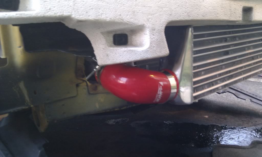

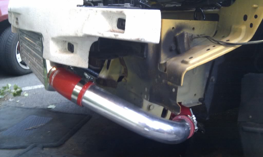

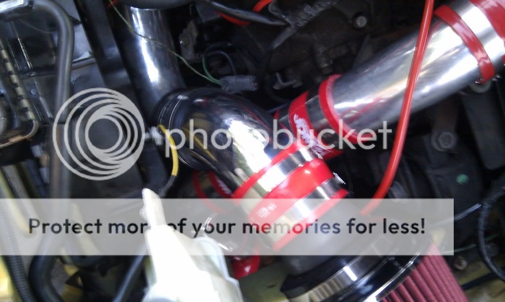

This is the hot side of my set up, today i will finish with it and post some pictures.
Good stuff :) Hopefully mine will look closer to that once I clean it up.
One suggestion on what I did, cut the silver heat wrap off the stock hot pipe and wrap some around the AC line that touches the piping. Should ensure there wont be any heat transfer there and keep your AC cool.
Speedpx: now that looks different. Post more pics of the hot side once u are done with it. I see that u were able to keep your stock fan that way. I guess we have all been use to seeing it done with the U pipe that we really didn't bother to try another way lol

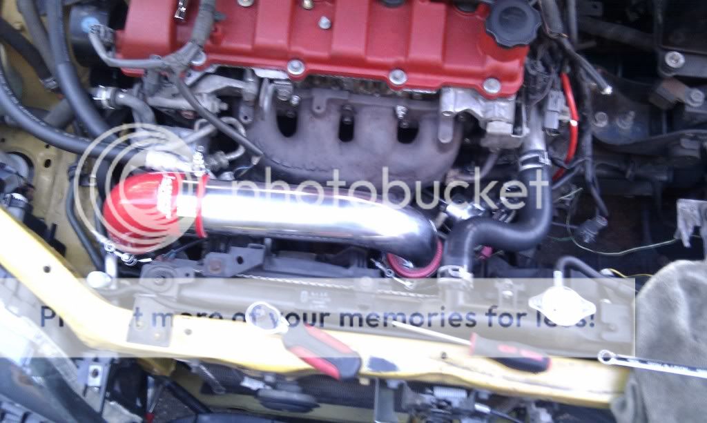

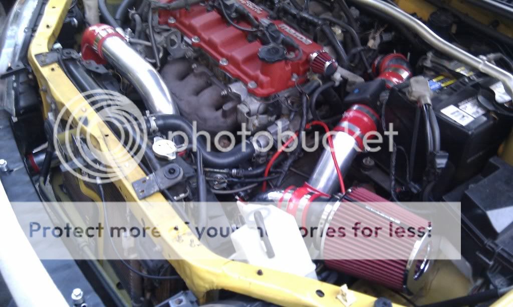

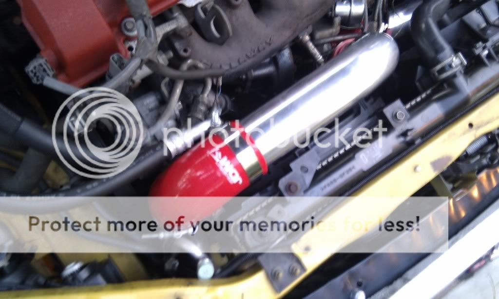

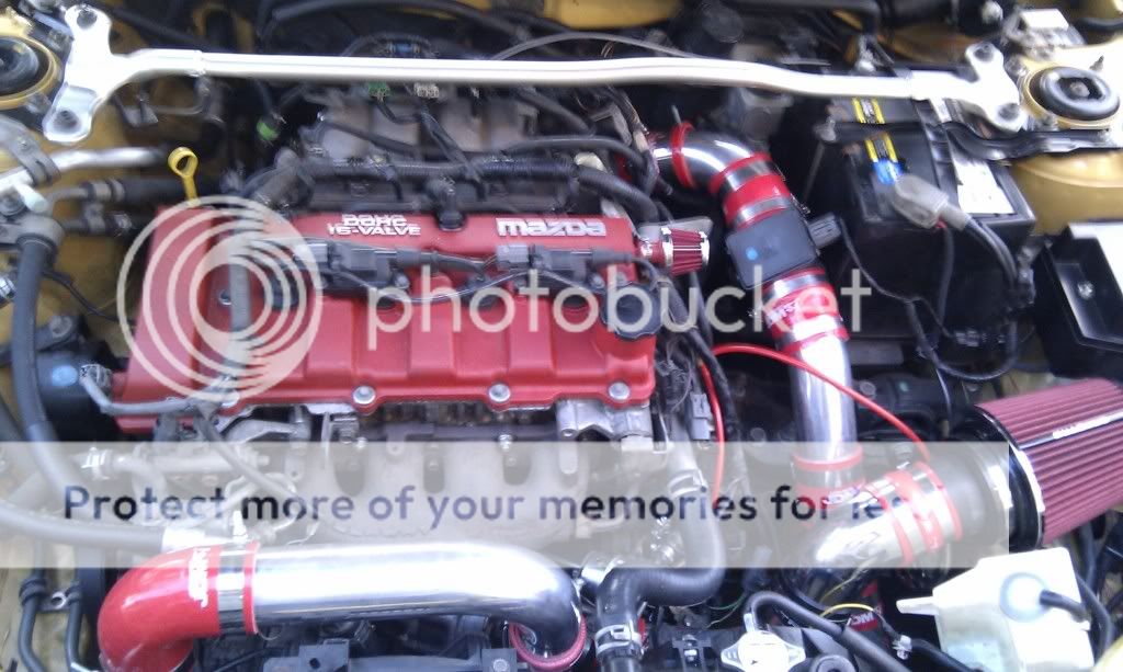

lol guess you didnt see my pics above? I did the same thing when I rerouted over the past weekend.
Theres a perfect channel running up there if you get the coupler right. Works perfect. Mine is just a mess becuase I had already slaughtered all my pipes and had to use what I had lol
I'd say this is the way to go for anyone else taking this on...no need for wasting money on slim fans.
It's a nice idea. I Think I still have the same pipe that he used. Just incase if someone wants to buy it and route their setup this way. I also have a 45*,90* and a 2-2.5 inch reducer,1 straight coupler . All brand new. just throwing it out there since u guys can use some of these parts

I have this idea on mind but i was waiting for some couplers to come , they send me the wrong ones then a had to wait for 3 weeks to get them; this way you keep stock fans in their locations, I'll post pictures when I finished, just need the intake pipe to finish.
