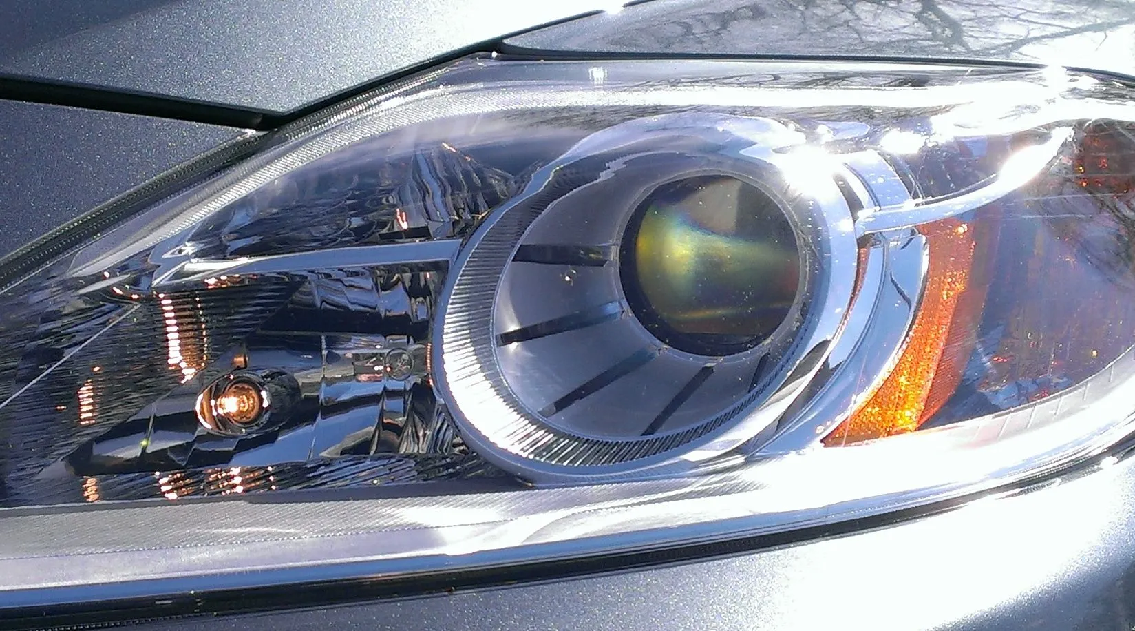

I did a little more research and am still not quite sure how these function. Attached is a pic of my DRL and it clearly shows that the Parking lamp is lit. If I turn the light switch to the park light position with the engine off nothing happens. If I start the car then the parking light comes on and stays on and the light switch has no effect on the parking light whatsoever! It's like they totally did away with the function on the light switch.
Of course you are confused--CX-9's manufactured for the US pre-2013 don't come with DRLs. So someone jerry-rigged this set up you have.
Parking light bulbs, at normal intensity, don't really provide sufficient brightness to function as a DRL that can be easily seen during the day. My Lexus, and an old Saturn that I had, used the high-beam bulb, but at a lower intensity. If your parking lights are on in the front, are the tail lights on too? Maybe someone just wired the set up so that the parking lights are always on--that would explain why the dash indicates that the lights are on.
Tex....I believe you are right! Since I purchased this car new, directly from the Mazda dealer, I couldn't think of how that could be. But, he had an outside service install an aftermarket remote starter and I think they wired it to the wrong points. It should turn on the parking lights at first, but then when the ignition switch is turned to the run position, the parking lights should go out. I have a call in to them to get this corrected. Thanks.
