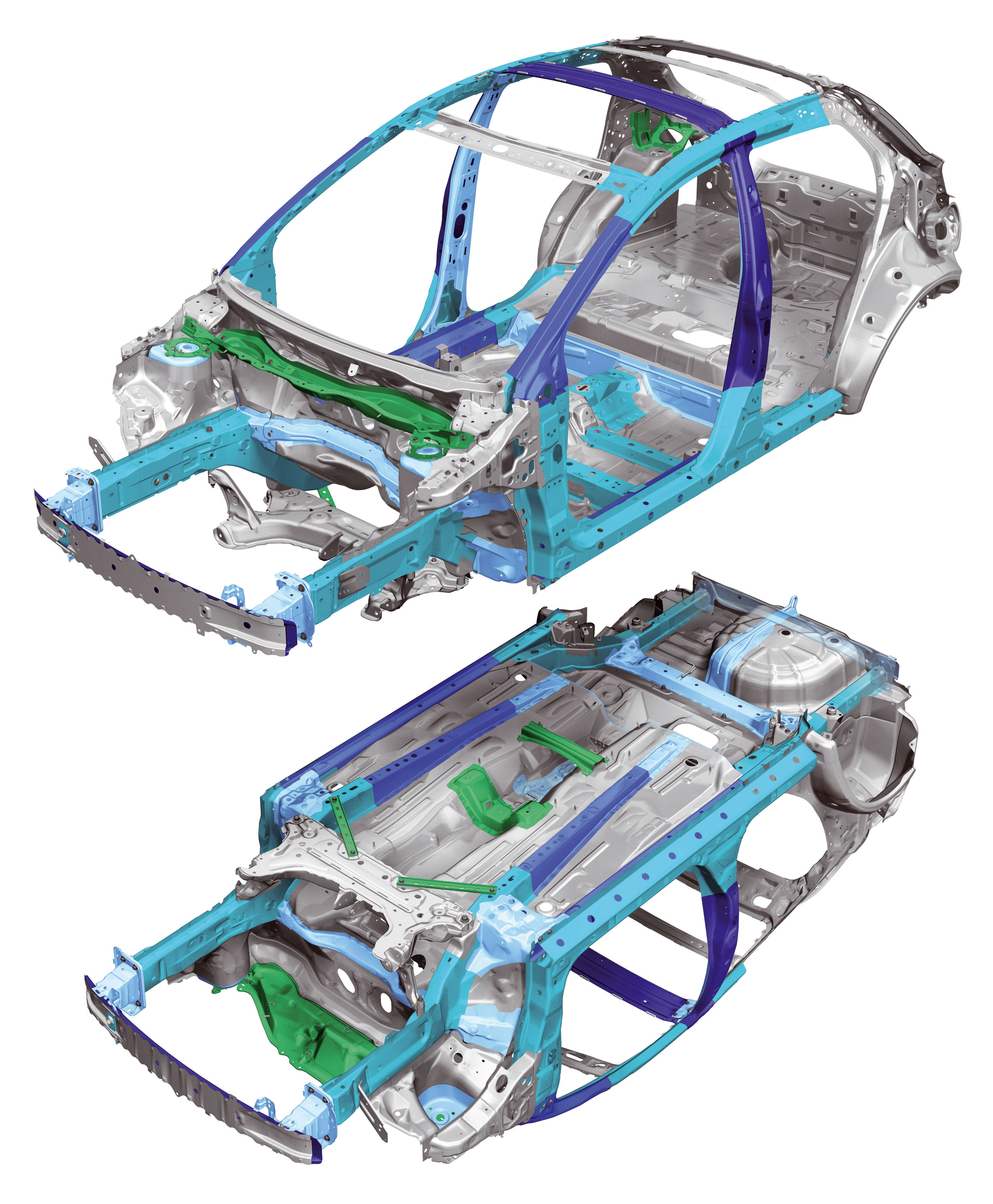

won't work in our cars. Here's an image everybody should have :
