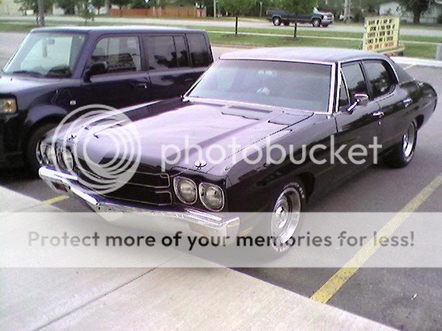

And nice Malibu. Too bad it's not a 2-door though.
How did you know it was a Malibu package? Its been stripped of its original trim. Heres a before shot in case your interested
It's a Malibu because it's a 4-door. There were no sedan SS's back then. Nice job on the car though. What engine do you have in there?
