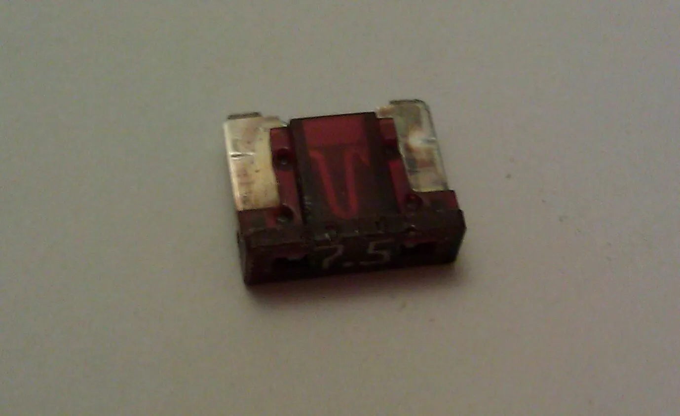

Hi guys,
i'm tryin to direct wire my beltronic radar detector to my car. there r a few ways to go abt it, but i want to use an add-a-circuit to the radio fuse for the power. the advantage of that is so ur radar detector only powers up when you turn on the car's power.

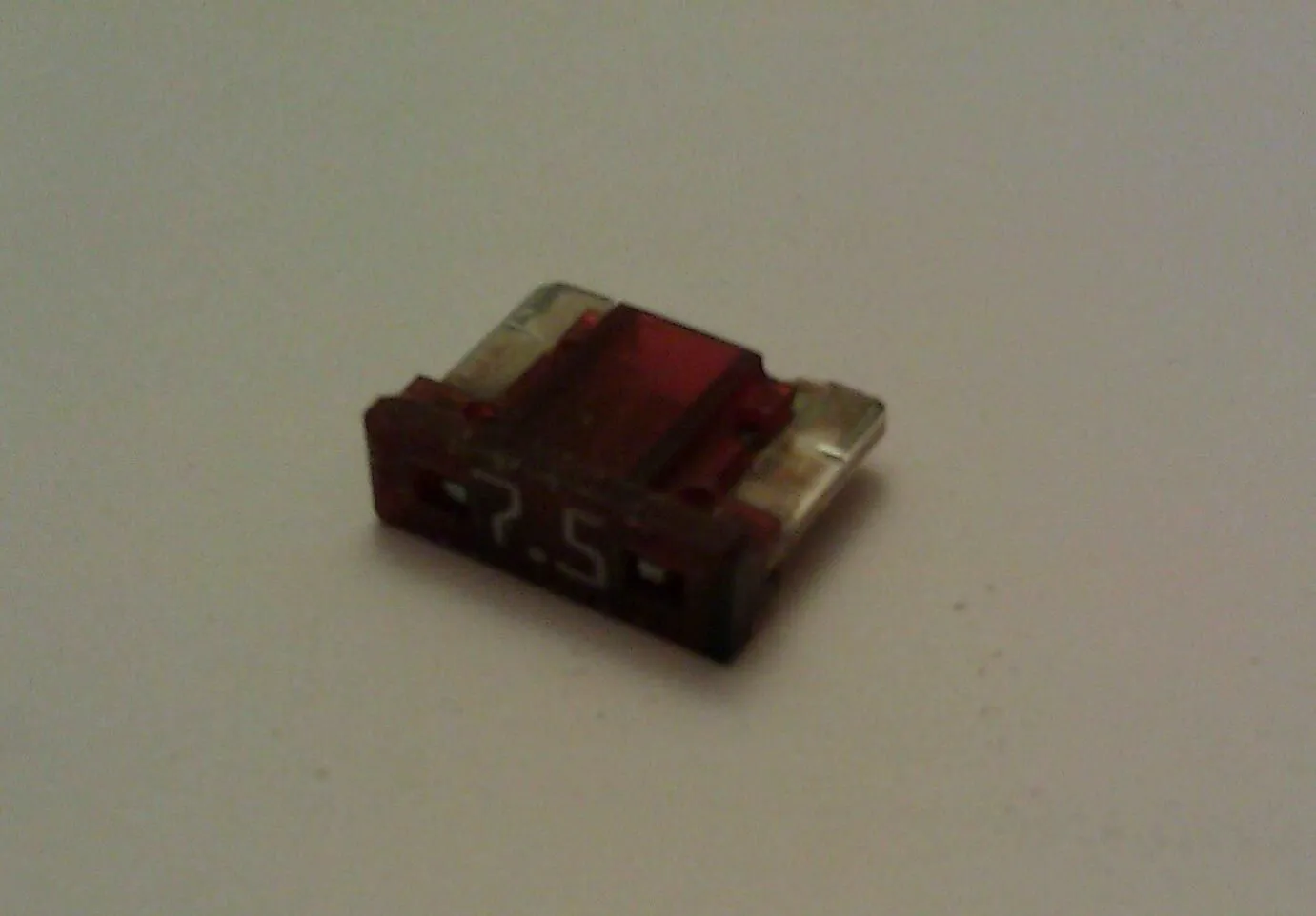

it should be a very straight forward install, but the difficult part is that our fuse is not the normal fuse...it's even smaller than the mini fuse that is normally used in other vehicles. i heard newer cars all come w/this type of fuse.
here's a pic of it:
does anyone kno if they make any add-a-circuit for this type of fuse? i've searched online, but no luck just yet.

thx, but the amazon link add-a-circuit is a size up. i found the same one in autozone...i would tap into the auto-dim rear-view mirror too if i had one XD
o, no, i didn't find the correct size, sorry for the confusion lol. i meant i found the same one with the amazon link you provided in autozone. i haven't found one for that size of fuse yet. i'll try my luck at fry's i guess.

i added my valentine radar to my mz3 sgt. using an add a fuse. and the kit off the website. painless installation.
