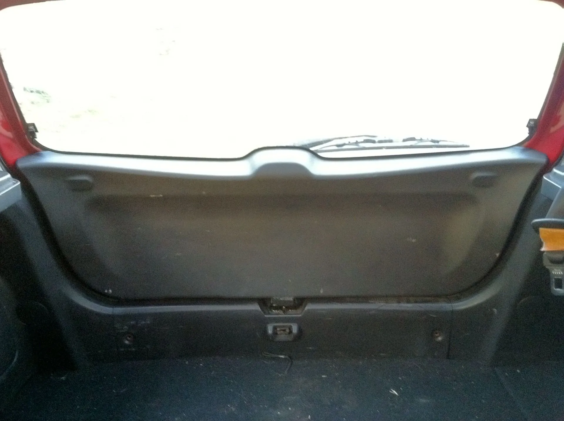

Sitting in my trunk area, I pulled off the inside trunk panel. This is NOT necessary.
Picture 1 shows the view of trunk from the inside.

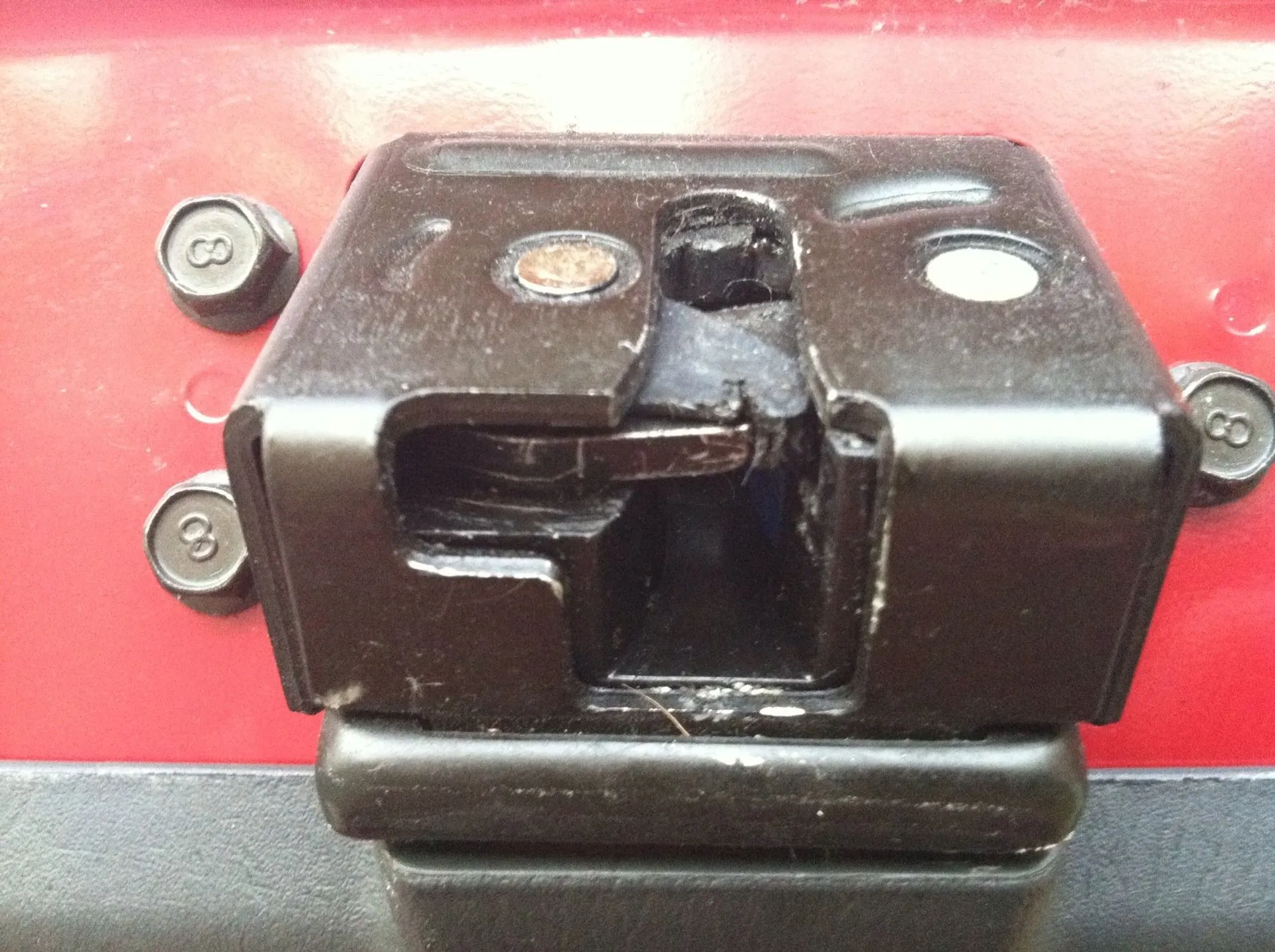

Picture 2 shows the locking mechanism up close. Look and you'll see the spinning U-plate that swings around the center bar. To the left of the bar you'll see the where the U-plate has a little notch and meets up with a plastic piece. Hard to see from the picture.

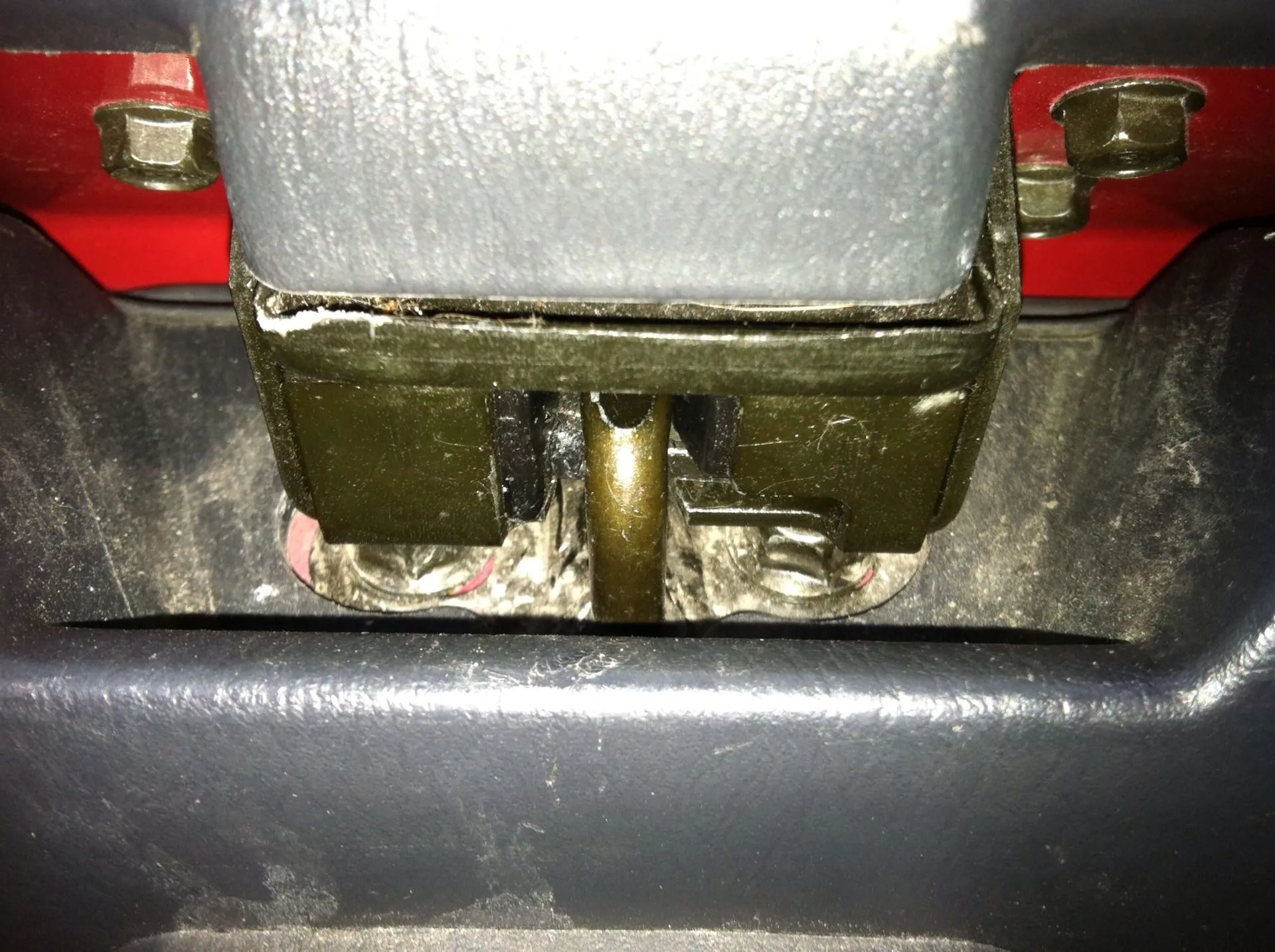

Picture 3 shows where where to stick the flathead screwdriver, which is where the notch is. Push the screwdriver in to the left of that notch. The plastic may fight you but wedge it in there. I had to use a lot of force. I was sitting in my trunk but had to put my shoulder into it. It'll make a nice loud POP when it frees us.

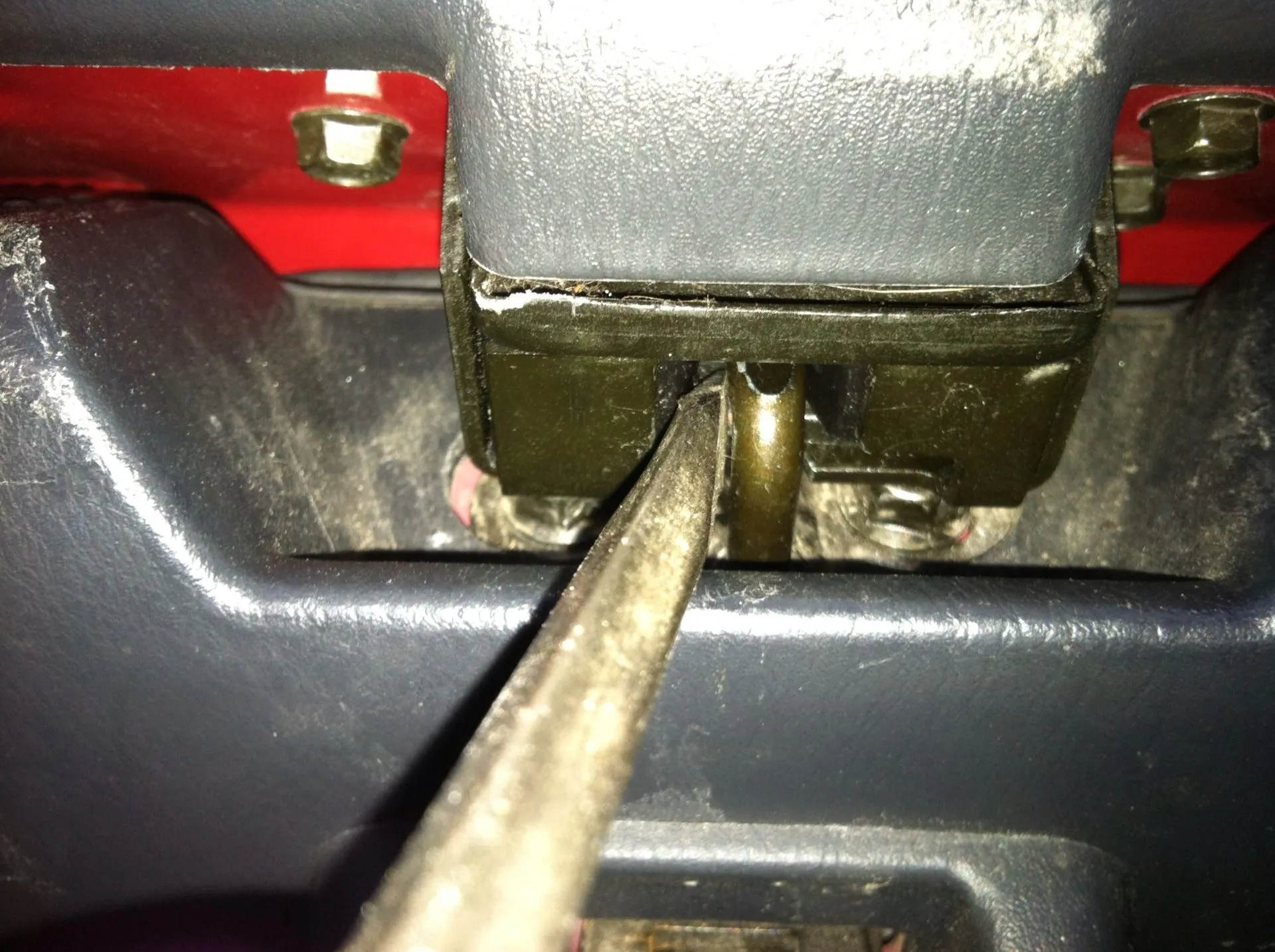

Picture 4 shows the locking mechanism with the trunk open. I spun the plate around as if it were closed. You can see the plastic layer that had risen up and jammed my lock.
