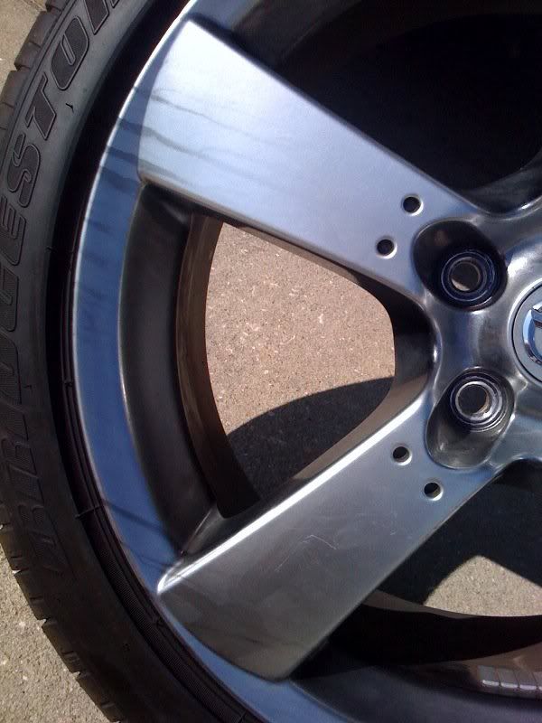

Picked up our 2015 CX-9 GT (CPO with 5k miles) earlier this year and am concerned with the finish / quality of the OEM 20" gunmetal wheels. IMO they are indeed quite good looking, but they've all got some form of discoloration thing going on, which in my best guess is either due to lack of adequate cleaning by the P.O. (maybe brake dust & dirt got embedded?) or a defective / low quality finish. I initially brought it up to dealer but they said it wasn't a warrantable item. I beg to differ, as I believe there's really no reason for them to be in this condition so easily and so quickly. Had many cars in the past with silver or gunmetal aluminum alloy wheels but never had this situation before.
Tried cleaning with just soap and water, and used Sonax on one wheel with no effect. Been meaning to bring it by the detail shop to get their take on it as well. Couple of Q's:

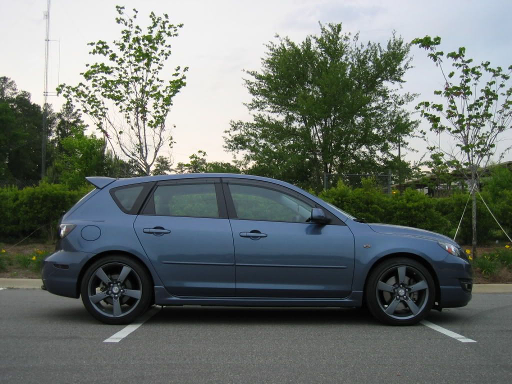

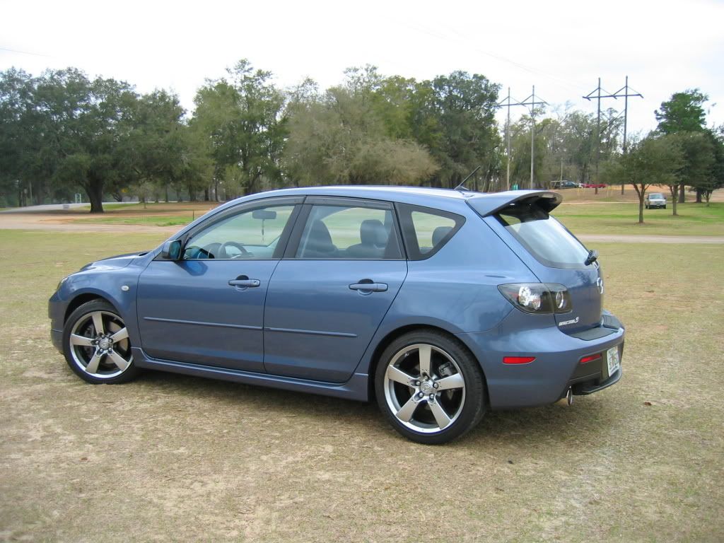

I purchased a set of RX-8 Shinka rims a few years back that had these marks on them. I ultimately winded up getting them sandblasted and powdercoated after they were professionally re-painted.
Shinkas w/original finish:
Repainted:
Powdercoated:

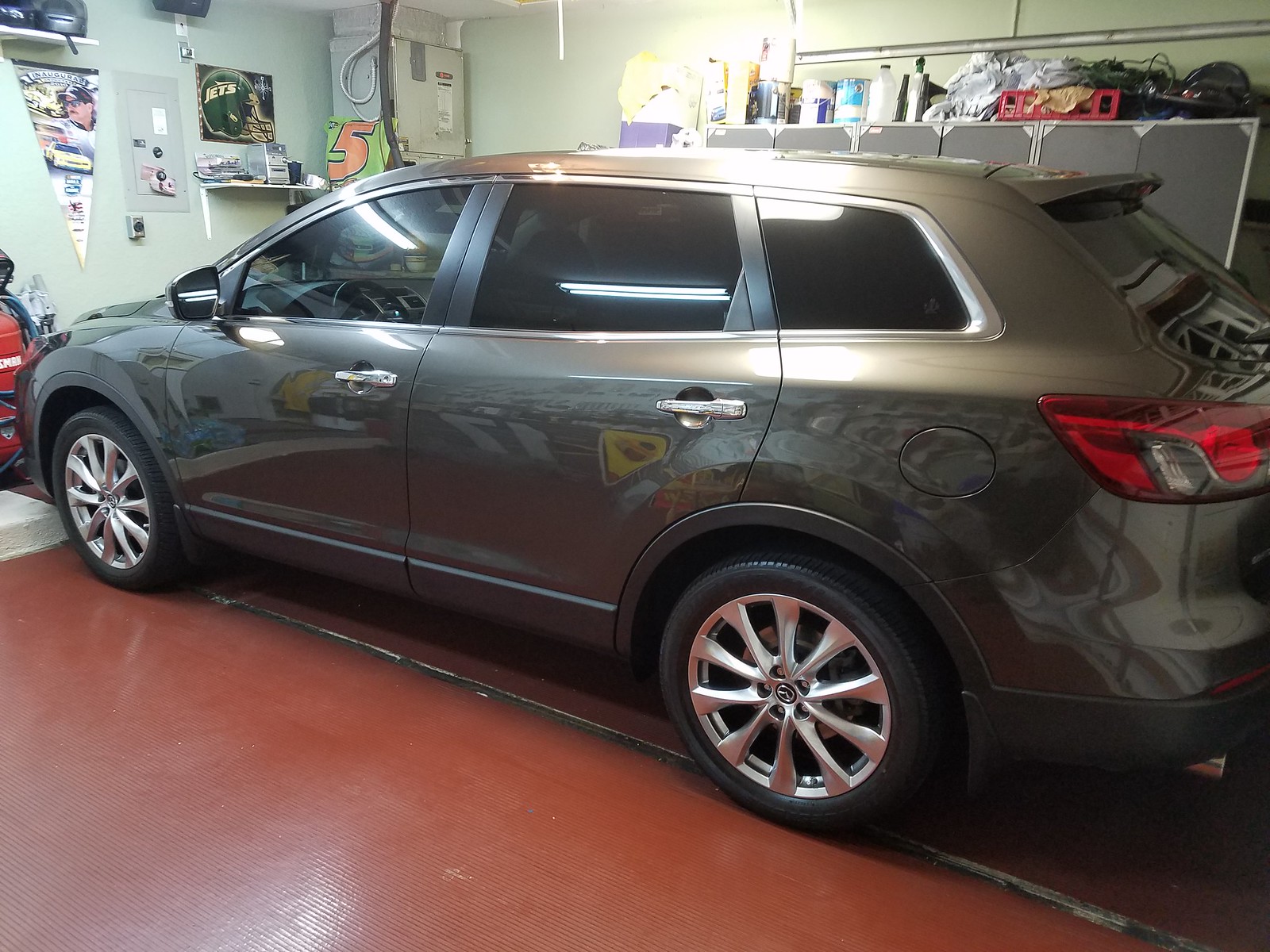

I know exactly what you experiencing because Mazda just refinished the same wheels.
So I bought my truck at night, thought the wheels were just dirty the next day I called and wanted to return the truck due to the wheels, also had a few other issues.
The General Manager comes out, we go over the truck and lastly I say why are the front wheels darker than the rears? His reply, "they are just dirty" which was exactly what I was hoping he'd say. I walk over and drag my fingers across the rim and they were clean.
So they decided to retint all the windows, change the brake rotors, refinish all 4 rims, replace the rear bumper and rebuff the car to mirror.
I do have a pic of the night I bought it, not very clear tho.
The wheels came out gorgeous, they got rid of most of the black and they look better than the stock silver color. It's still sorta gun metal but much brighter.
