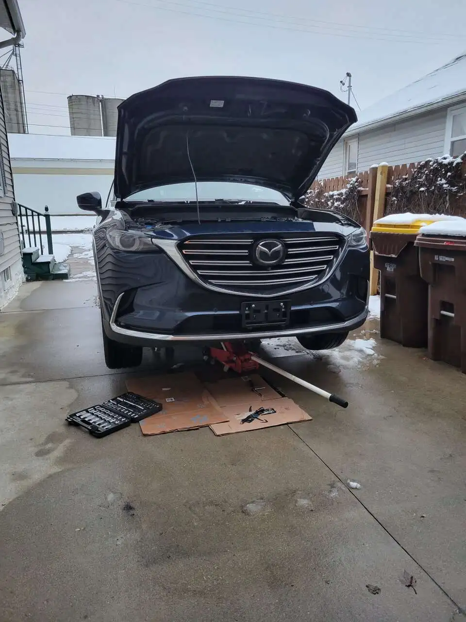

Anyone want to loan me their clean, dry garage so I don't have to roll around on my cement driveway? LOL

Jacked her up and took the engine plastics off. Might have broke a couple push pins in the process 😆

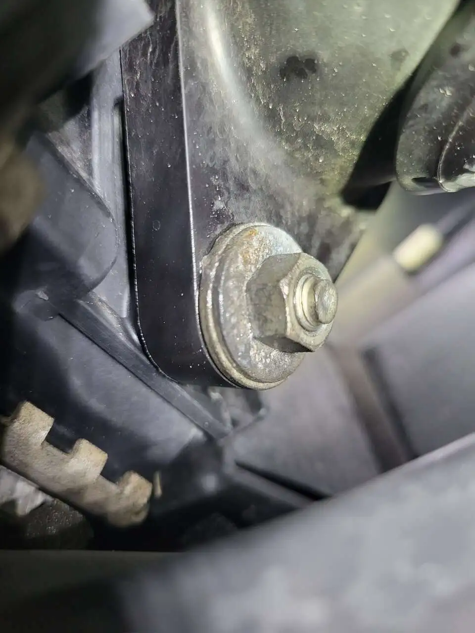

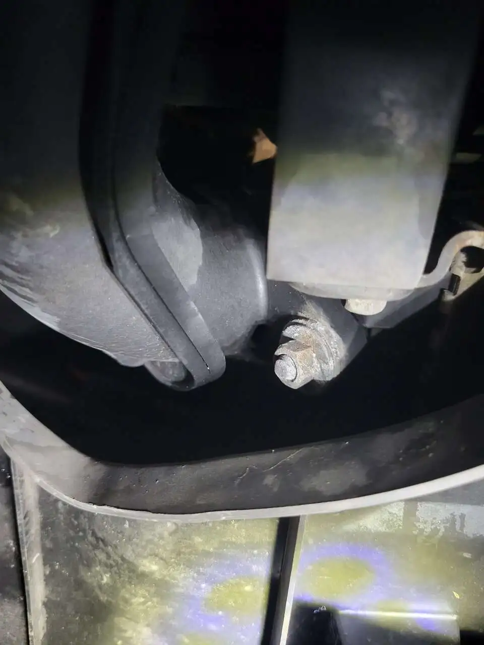

I found one leaking spot, not sure if it's the only spot but it's something. It's the right "collar" at the bottom of the radiator that connects the hose to the radiator. It was definitely wet with coolant. The left side was bone dry. I'll dry it and check again in the morning to confirm. Gonna leave the plastics off and lay some cardboard to see if I can find any other leaks.
Do I just replace the "collar" and move on with my life? Anyone know how much of a job that is for a DIY'r?
Wet
Dry
