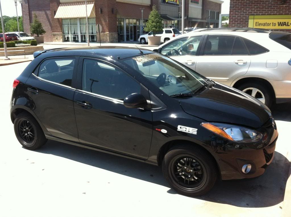

I'm just completely fed up with this car. I've been through 3 sets of tires and I can't get it to stop shaking at >60 mph. It wouldn't bother me so bad, but it's a brand new car- it shouldn't shake. Plus, I have the rx7 for fun, the s10 for winter, and the metro for mileage and short trips, so the only thing I use the 2 for is long trips (interstate), which it can't do without vibrating me half to death. Ive put $3-4k into trying to make it into something it isn't (sports car) and I'm really starting to regret putting basically $20k into a car that is less fun than a $200 rx7 and uses more gas than a $375 geo. Sorry guys, I just need to vent.

Just buy some good quality lighter wheels (see the latest issue of Grassroots Motorsports for some choices). The difference between 90 dollar wheels and ones ranging from 125-200 is huge. The Mazda2 like the MX-5 Miata is quite sensitive to unsprung weight. Also the quality of the tires matters. That being said I assume that you had the front end bits carefully checked out and that you never had any curbing or other impact with the car. Also the bearings were checked for play, right?
I have had some impacts, but everything has been checked and it has had a recent 4 wheel alignment. The BFG tires helped a lot. I may get some wheels and try it but I'm just so sick of throwing money at this car.

If I were you, I'd try to get to the root of the vibration/shaking problem first. Buy/borrow a set of factory wheels and run them without spacers if you can, just to see if the harshness is there. If it is, the problem is with the car and you'd need to dig deeper (maybe return to factory suspension as a test). If not, you know the problem is specifically with your wheels. I wouldn't throw money at new wheels if you don't know for sure that they will fix the problem.
