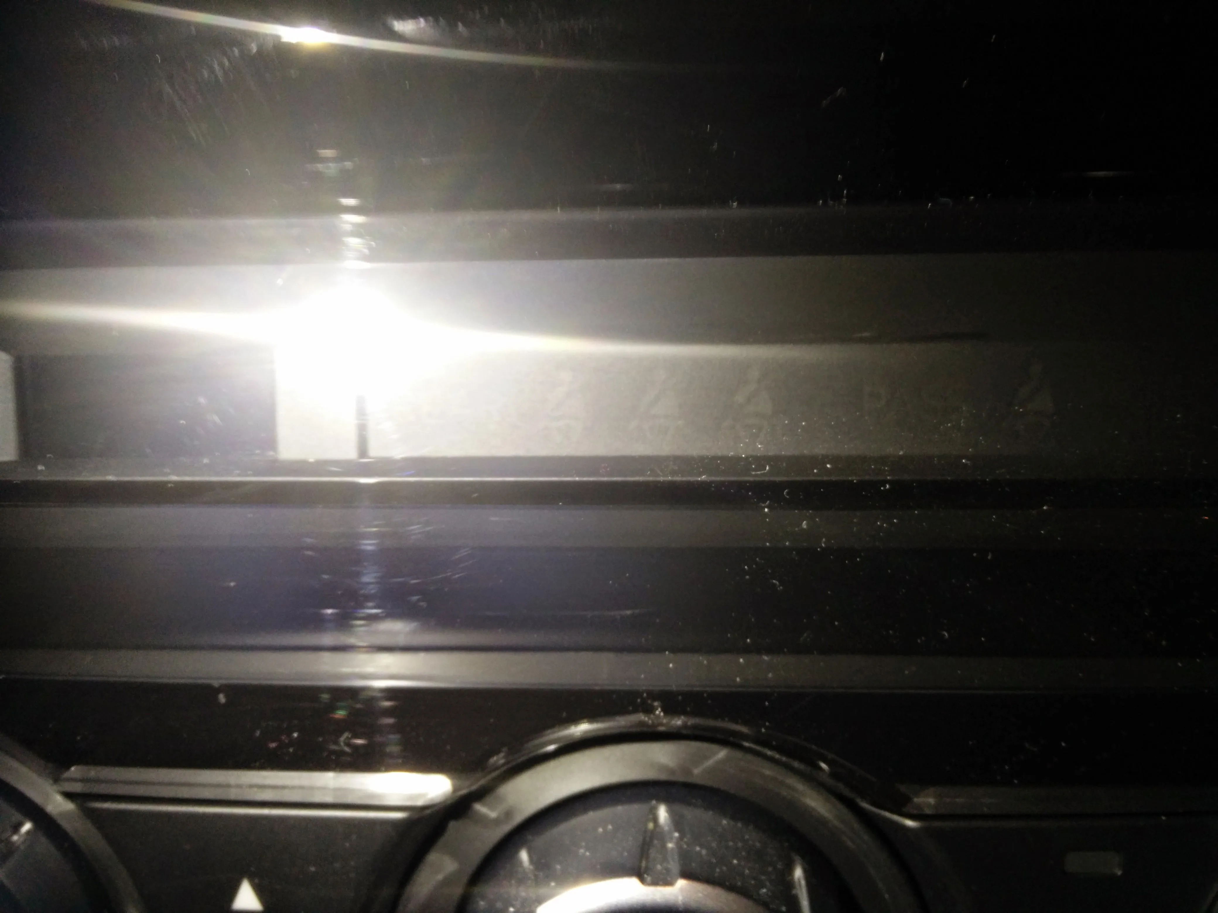

With the seat belt warning lights, if you look closely at that panel, shine a light on it, you'll see on the left side near the clock that there are 3 seat belt warning icons, and the word "rear." In the photo, you can see the 3 seat belt warning icons, and the word "rear" is to the left. I had a hard time getting the lighting right for the photo. I'm just curious if this is a feature that's there, but Mazda decided not to activate it.
Yours is a '15 and the passenger seat belt warning lights could be different. As wearing the seat belt on rear seat with a adult is not mandated in US, I haven't seen any cars has rear seat belt warning lights for rear passengers. The observation you've found could be just reserved for future use or for regions where wearing the seat belt is required for rear passengers.
You're right, it is an option for a different region, you can see them illuminated here, above where it says, "Pax seat heating control." http://www.mazdas247.com/forum/show...YOU-NOT-LIKE&p=6395788&viewfull=1#post6395788
