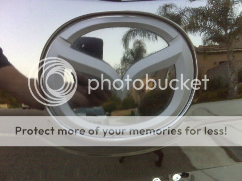

hope this pic will help you...

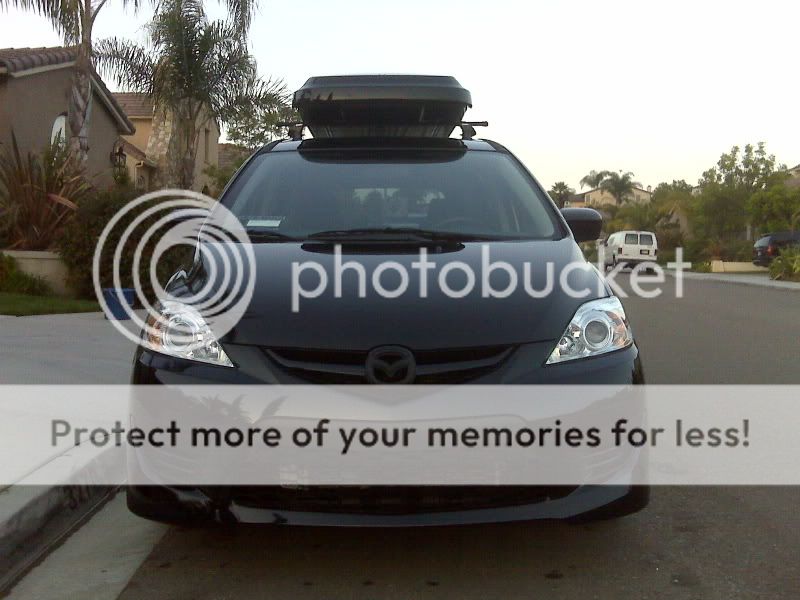

Well so I spent the second half of my Saturday last weekend painting the emblems black. Since I couldn't get to the screws behind the front emblem, I took the whole front bumper off. Once I took the screws out, I found out that the emblem isn't even screwed in. It's snapped in by five snaps - one on top, one on each side, and two on the bottom. You can only get to the top snap from behind the emblem. So I basically forced the thing out, breaking the two snaps on the side. But it's no problem because the top and two bottom snaps hold the emblem in just fine.
I opted for some flat black and here are the results:
Close up front (I just washed the car so the emblem is still a little wet around the edges)

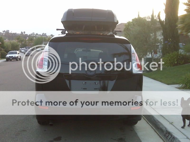

Close up rear
