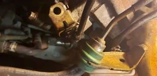

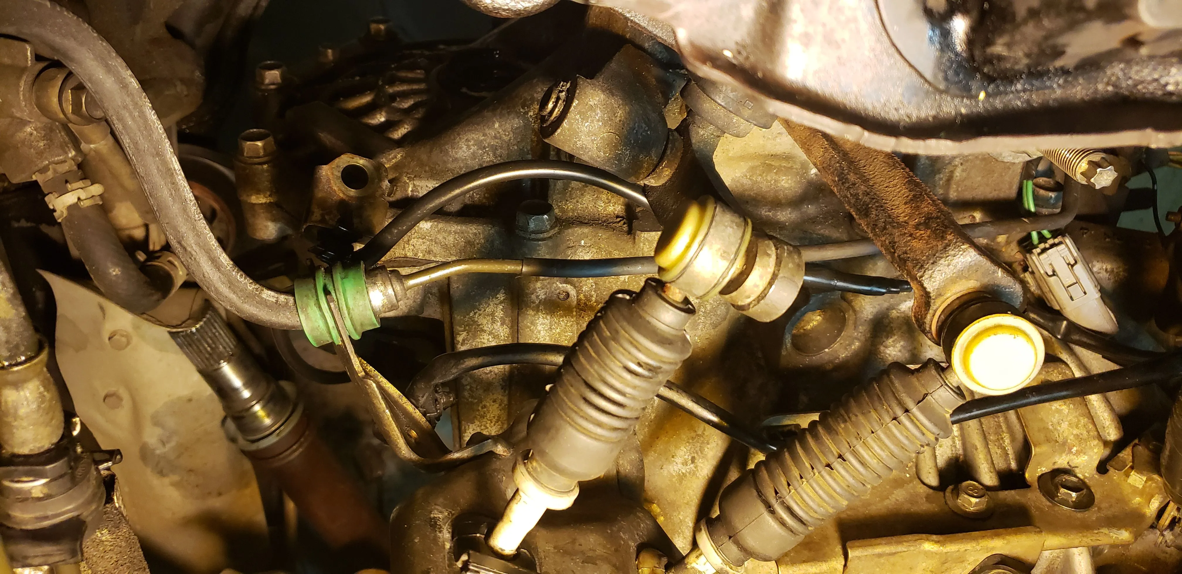

The engine is back in, and now I'm in the process of connecting the wiring harness. My first question here has to do with the step I'm in in this process: Two cables that I'm unsure how the routing goes for them. One is the speed sensor cable. It has a plastic snap, but the closest bracket it could go in, the shift cables bracket, doesn't really leave it close enough. This ties with the second cable, which is the neutral switch cable. That one has a metal bracket that I'm unsure where it goes.
Obviously, I hope that someone here knows the answer to my questions. Thanks in advance.
