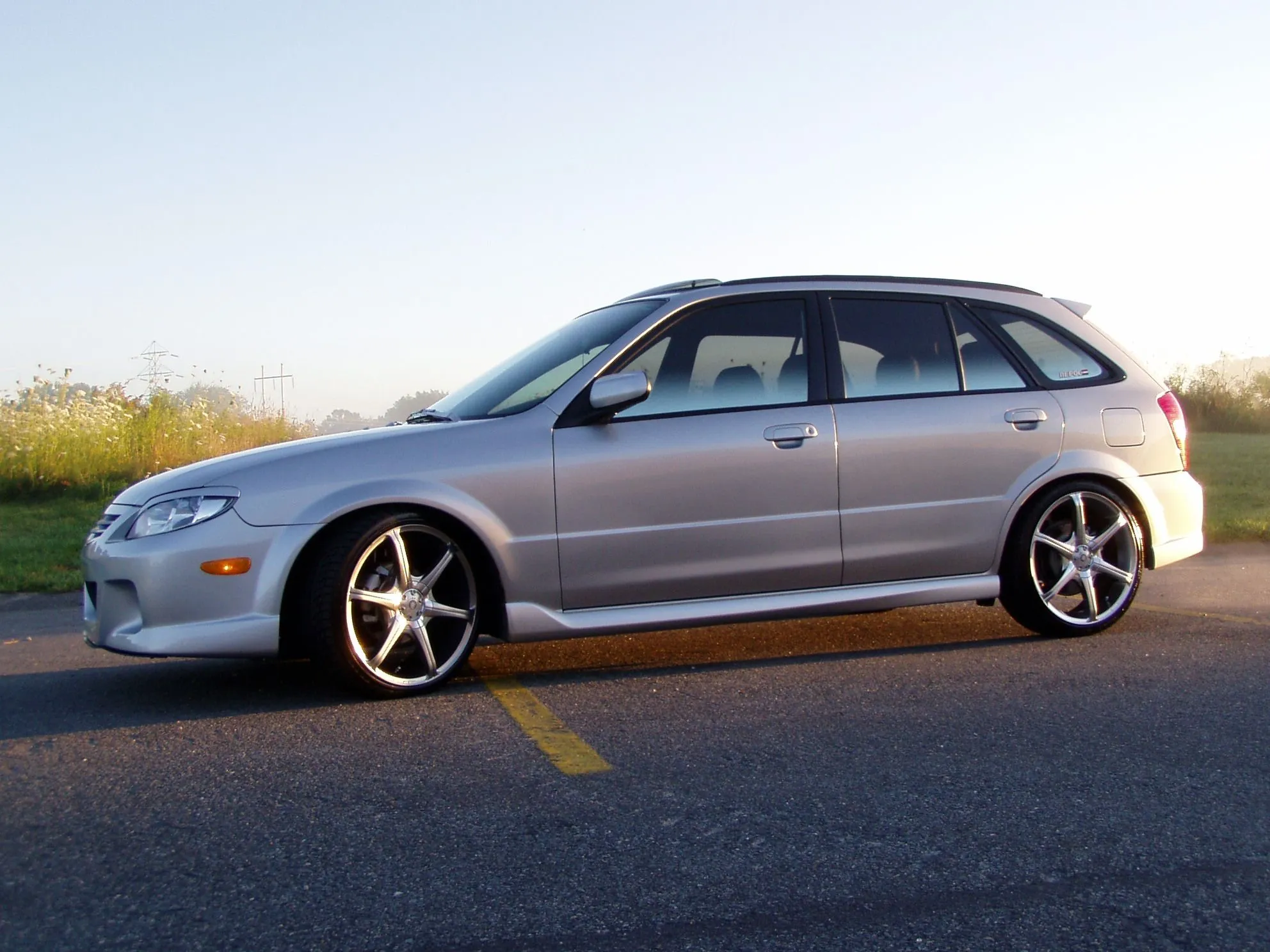

okay

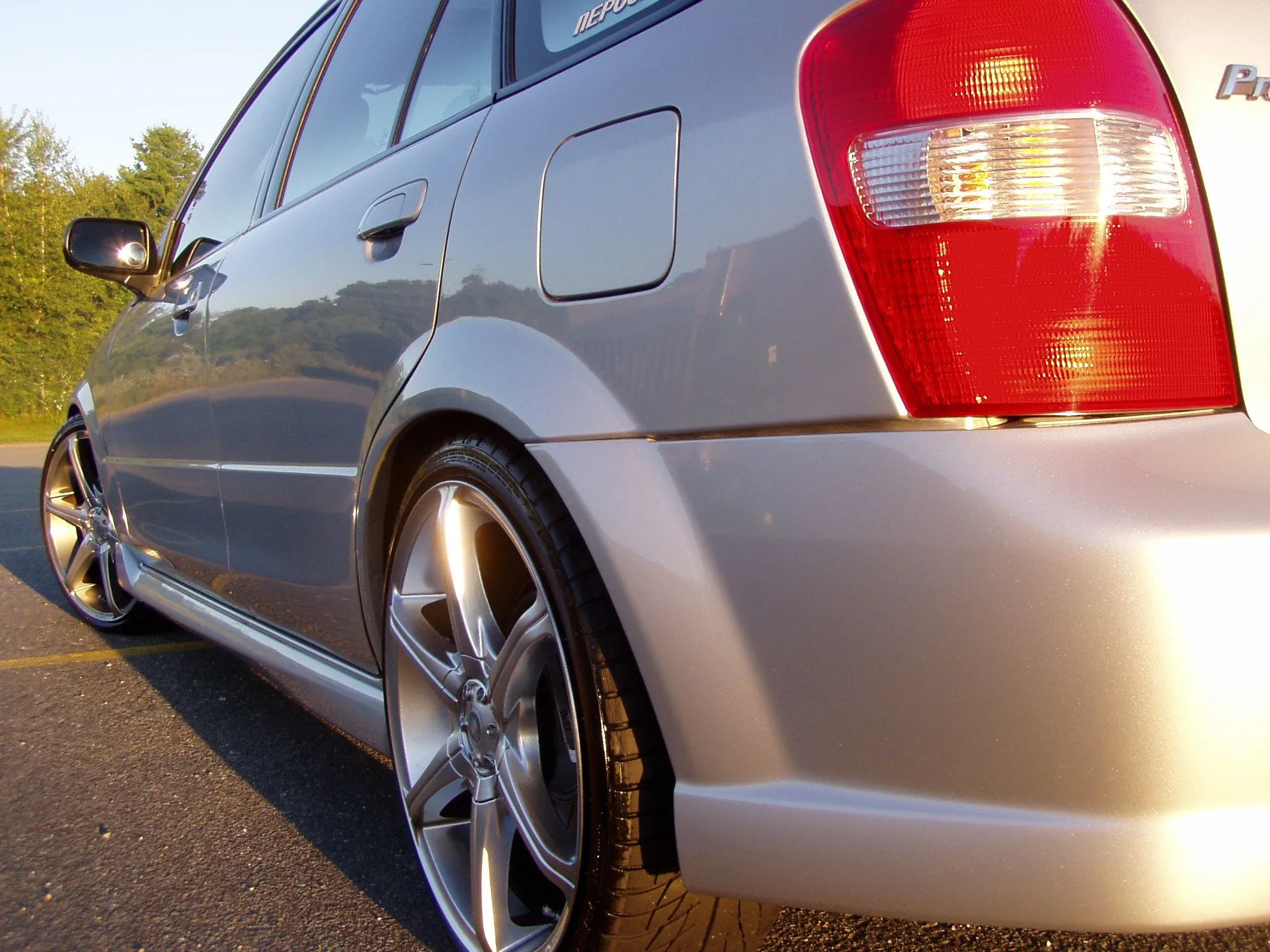

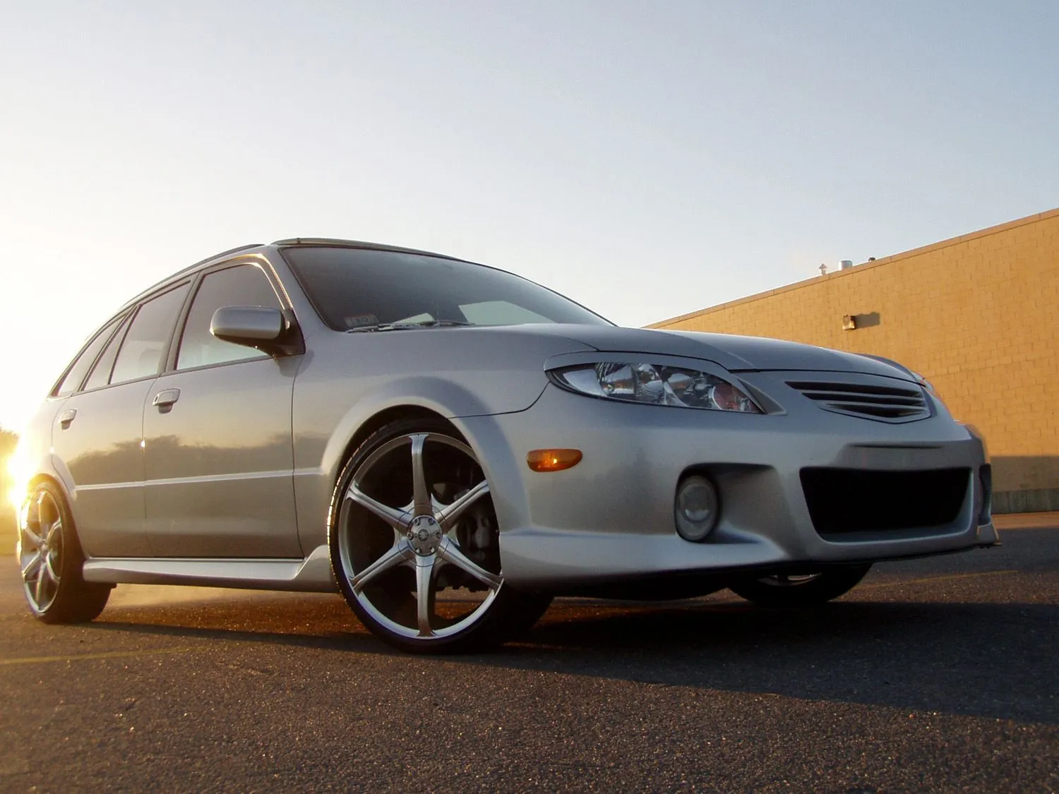

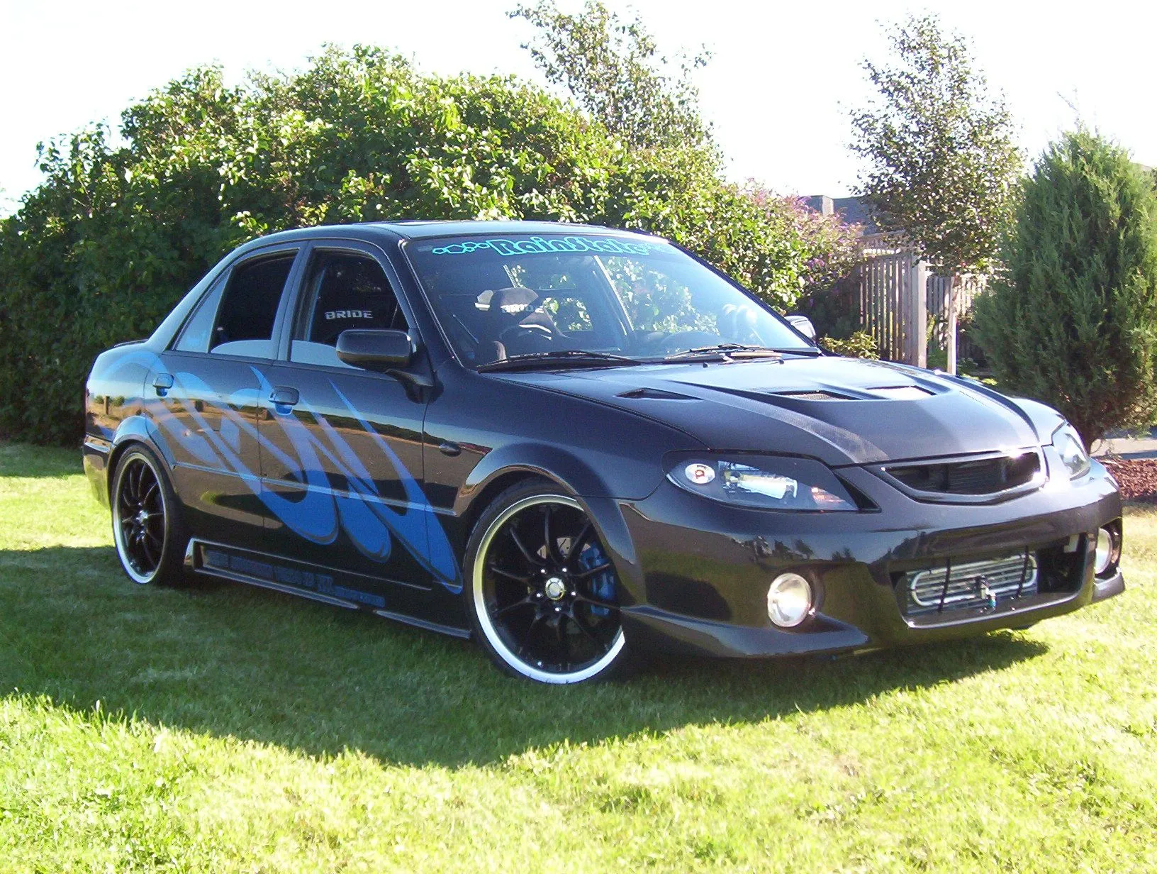

it is 3m adhesive remover and a sore ass thumb. i used heat to soften the glue then pulled them off little by little.... then just soak the glue with adhesive remover and start taking it off with your nail or thumb. it takes a while but isn't hard. here is a pic of a black one with the sides removed......

I removed mine. Be prepared for some nice thumb and forefinger blisters. =P But it is worth it, in my oppinion. Makes the car look pretty smooth. In particular, black ones look rockin' with shaved sides.
