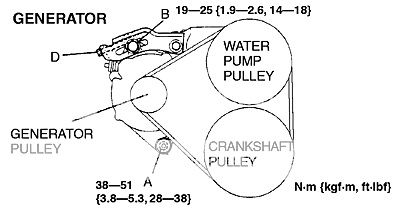

There is no tensioner... the alternator is pivoted to tighten or loosen the belt.. The manual suggests this should be done with the engine cold.. 6.5mm to 7.5mm of deflection for a new belt, or 7.0mm to 9.0mm for a used belt. It doesn't say, but my impression from reading this is that they are assuming the new belt will stretch to the 7.0 to 9.0 range and this shouldn't need to be re-done if performed according to these instructions. If I were to follow this to the letter, I'de get an OEM belt just in case...

This is the alternator setup for our FS engine:
This is what I think our setup should look like.
Just a solid mounted idler wheel,... tentioned the same way.
