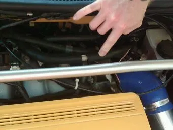

the check valve is in the middle of the brake boost line u can feel a little lump just before the last curve in the line cut about 1 to 2 inches to the left of it and youll be good
pics

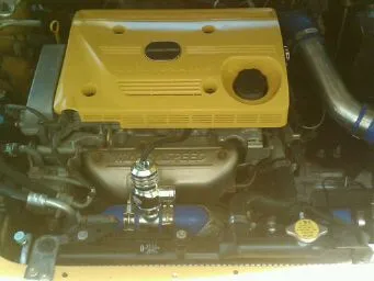

im pointing at the check valve i used a pair of plyers to squeez the brake boost line to find it cuz the hose is hard but dont squeez it to hard u might break the check valve u can also feel it in the hose as a little lump but its kinda hard to feel cut it about 2" in front of the check valve u also want to run the VAC hose as short as possible i ran it under my motor as u can see in the other pic i had to cut a slot in the motor cover on the underside so it would fit its a nice clean look
