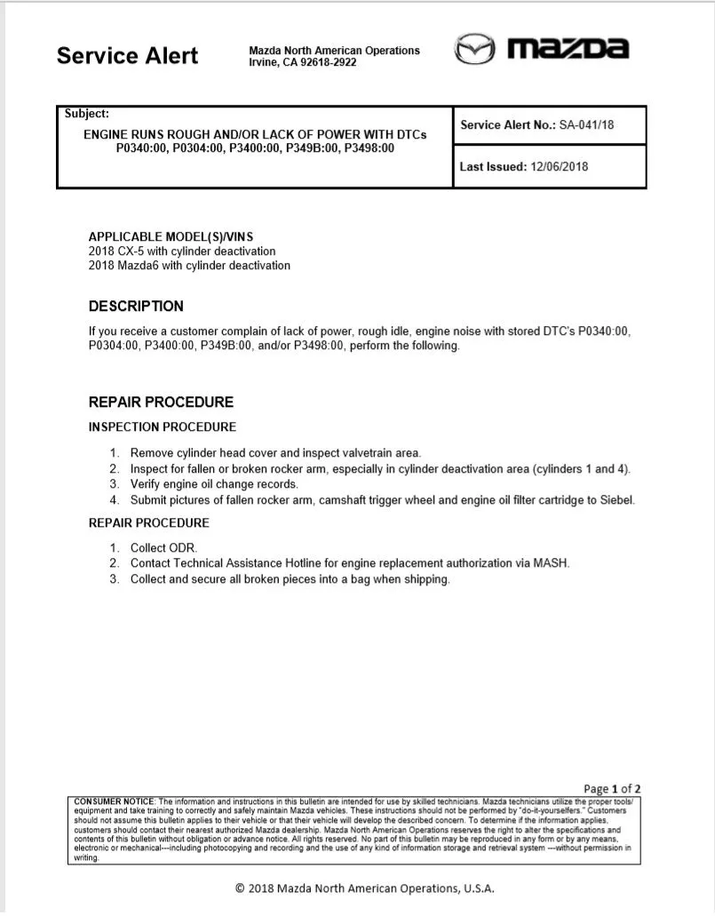

Dangerous cylinder deactivation trouble on 2018 CX-5 and Mazda6 models
Note the reference to SA-041/18 in the above under Repair Procedure in the event of discovered broken/dislocated rocker arms.
Here it is on the NHTSA website. It outlines the steps the mechanic/dealer is to take.

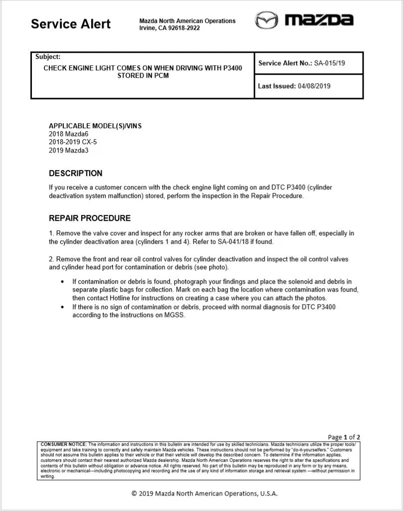

Mazda Service Alert no. SA-041/18 issued on 12/06/2018 where you posted from NHTSA is for fallen or broken rocker arm with cylinder deactivation. The Service Alert no: SA-015/19 issued on 04/08/2019 where t.suv posted earlier from NHTSA is for fallen or broken rocker arm AND broken front and rear oil control valves with cylinder deactivation. For broken control valve, the Service Alert doesn't say the engine replacement is required. This makes me further believe there's more involved on rocker arm falling problem.

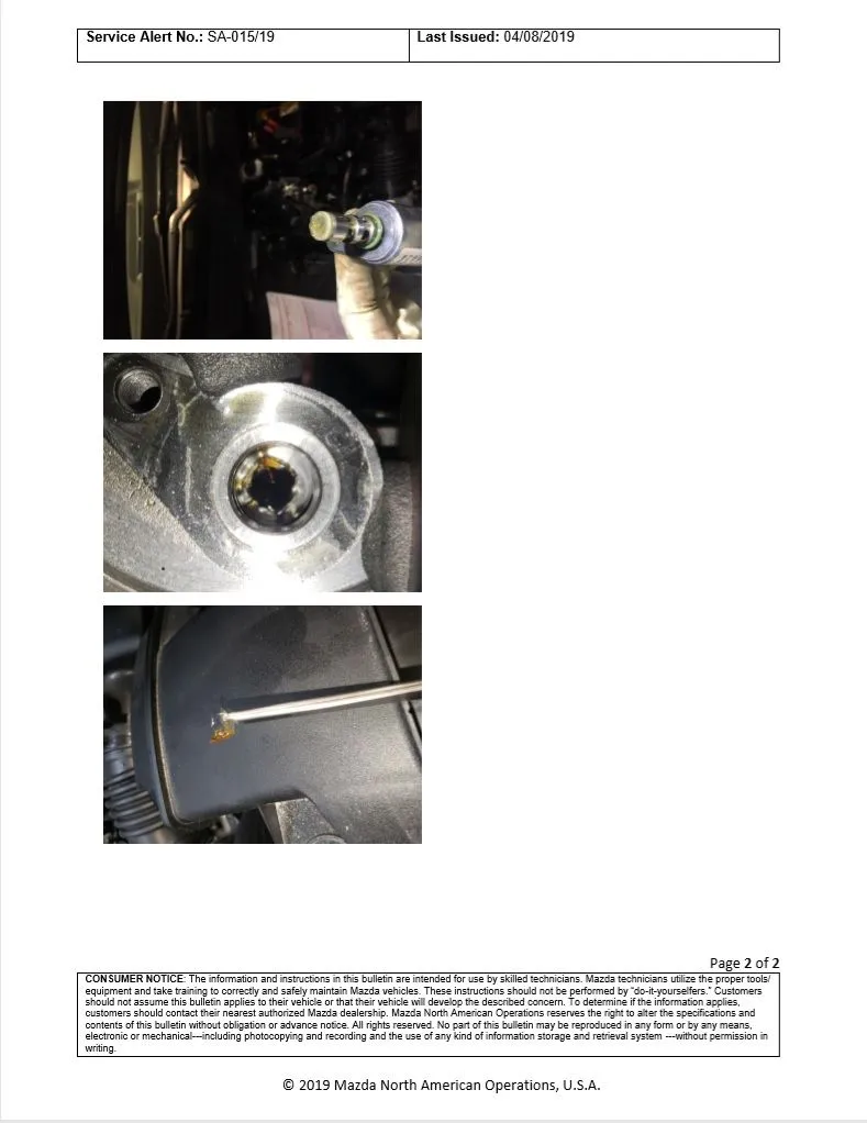

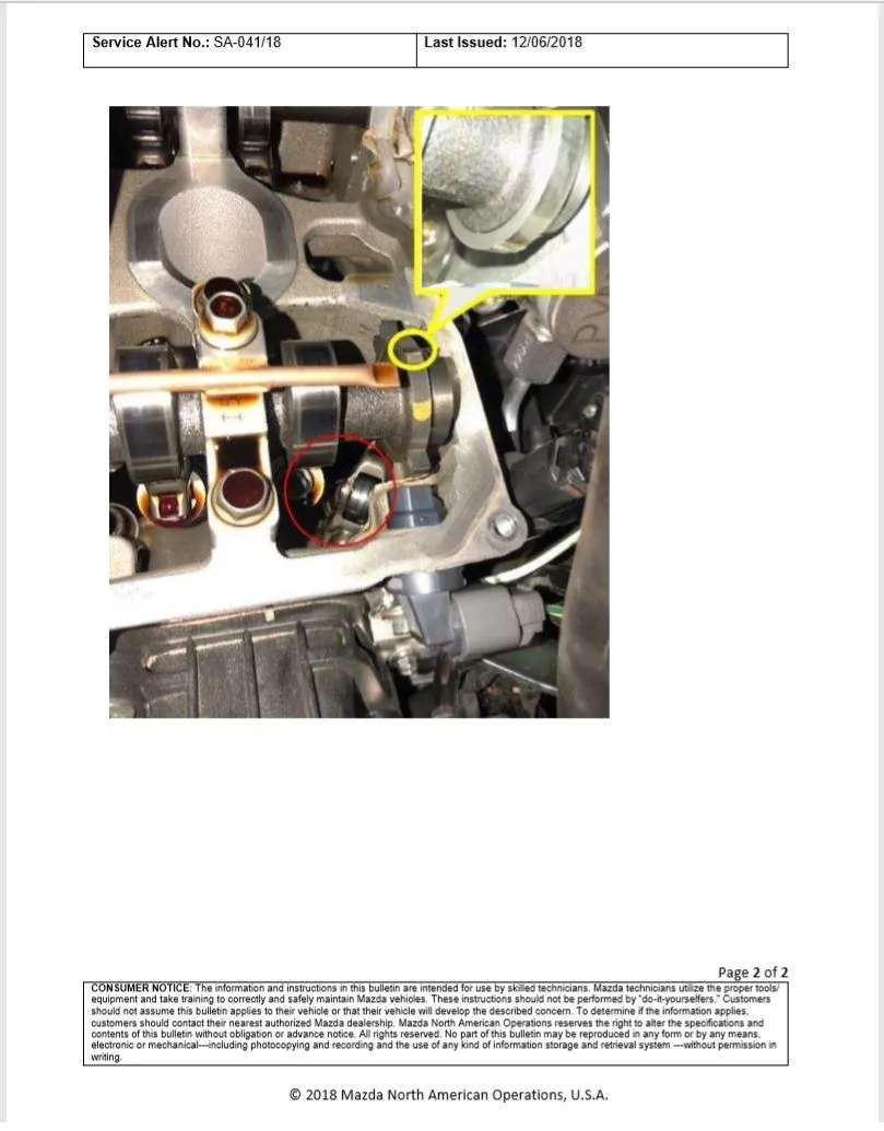

From owner's point of view of course we want a new engine. But for Mazda, replacing a new engine is costly, and they won't replace it unless it's really necessary. Looking at the picture with fallen rocker arm in Service Alert, the rocker arm seems sitting there harmlessly and can't cause any other damages.
The same picture shows it's one of the intake rocker arm fallen off. There's another intake valve for cylinder #4 which is still functioning. That's why cylinder #4 is having no issues during the lower rpm's, and it only feels lack of air during higher rpm's.
