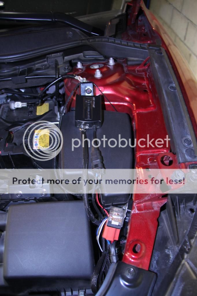

I installed mine today. I bought it from the ebay link and it's from a Taiwan company named topsage. Very quality product and I love the LED light output, it's pretty bright.
Mine is a 13 Touring non tech package.
I removed the bumper to work on it, I also believe removing the foglight assembly to allow the LED DRL wire to go through make things easier.
I used the fuse tap provided in the package with a 10A and 5A on it and install into the instrument panel fuse slot (the only one with a red 10A).
The rest of wiring is pretty straight forward. But I decided to tap the LED to my fog light instead of my low beam because I have HID on it and i don't want to mess with the voltage and this allows me to choose to use LED or foglight during the night, which I believe I will stick with the foglight at night most of the time. Also, I avoided the dim LED option since I heard LED is better to be full on or full off.
here are some pictures:

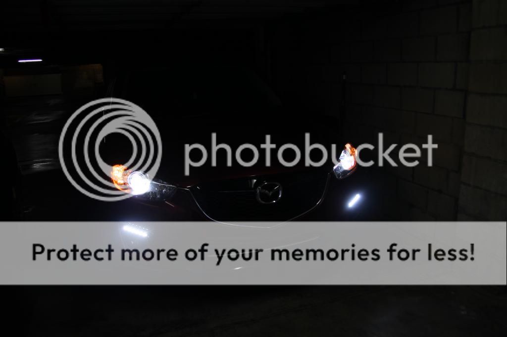

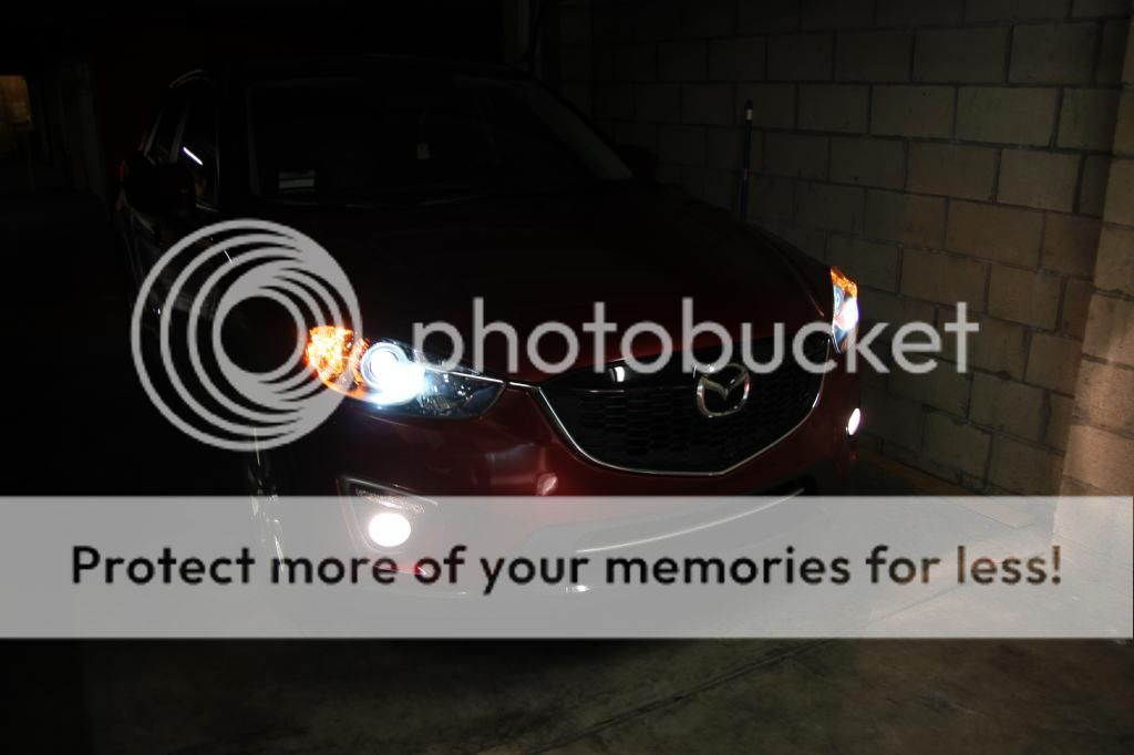

regular low beam with foglight on

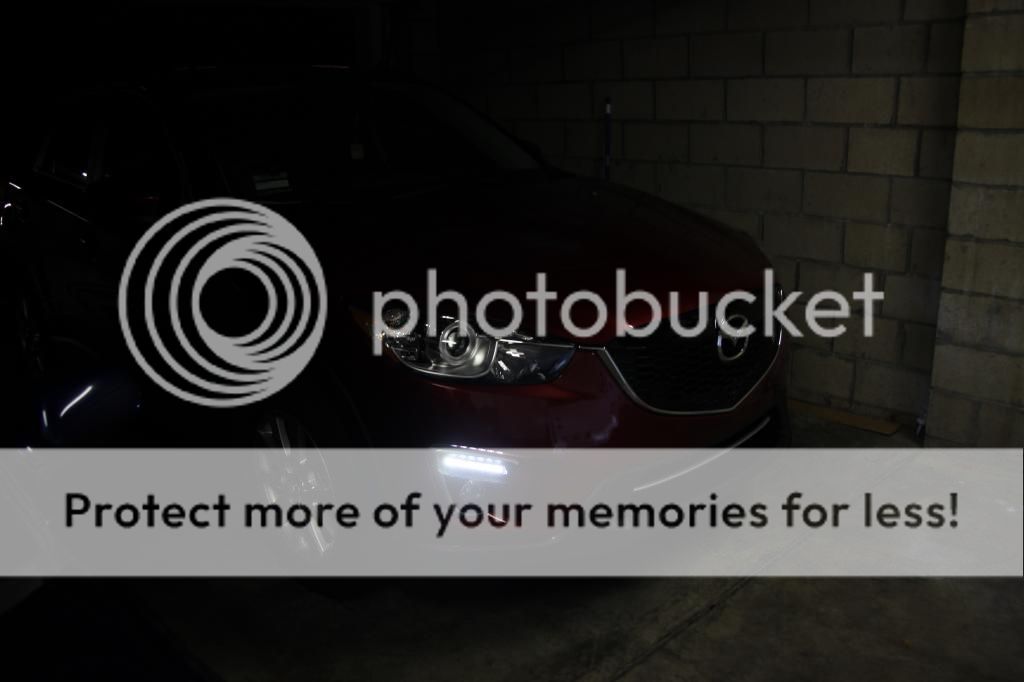

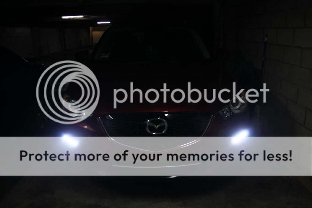

low beam with LED on (My HID is 4300k and the LED is about 5000k color temp.)
the red wire out from the fuse box is the fuse tap.

Do you find the Fog strips overly blue compared to the HID? The pics show it fairly blue but photographs can be deceiving.
I think the led strip is fairly close to those OEM quality led from Benz or Audi. It's just my hid is very close to white with a tint of yellow, that makes the led a bit blue, but I say they are are very white overall. The result should be exactly like the original thread starter's picture in post #1.
Audi uses 5500k (don't know about MB as I used to have an Audi.) The HID on the CX-5 is supposed to be Philips 4300k though there are reports to incongruous temperatures between HID and LED which is why I ask the question. It seems not all 5000k is the same. However 4300k is supposed to put out the most light (obviously advantageous.) I'd just like the lights to match up between the two lights that would be on at the same time.
It looks like you have tech package, I assume your HID will be whiter than my HID since my 4300k is aftermarket, I feel my HID is bright but just a little whiter than OEM halogen but not a white as more factory OEM HID.
The LED DRL is more of LED white, you can have a pair of LED bulb for the license plate light, I feel that they are more like that color which is about 5000k.
I can shoot another picture tomorrow during the day time, that color is closer to real.
