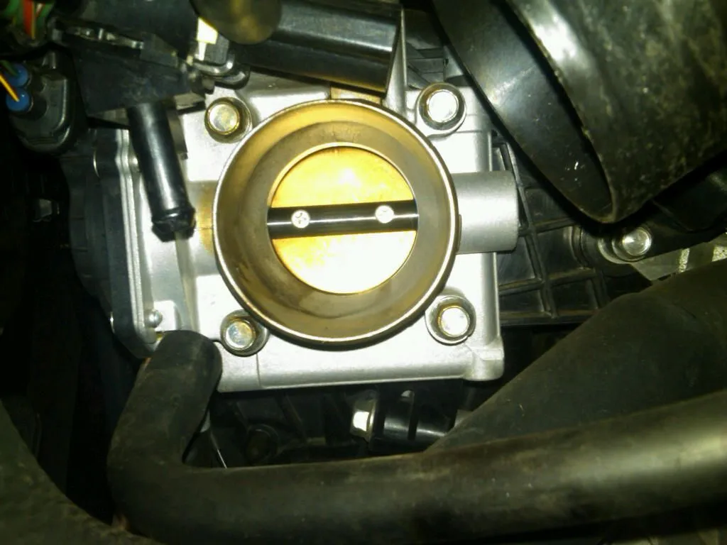

So last night I was working on the 2 and I got a good look at the throttle body. It is so tiny. I doubt that it is a restriction for the intake given how our cars flow so well up top. It is just one of the smallest I have seen in the US. It is in the range of 1.5"-1.75". Given how it is so small I wouldn't be surprised if there was a larger option which would bolt in. Again I don't think there would really be any gains there, but I figure I might just look into it to see. Anyone knows what one of the Mazda 3 throttle bodies look like?

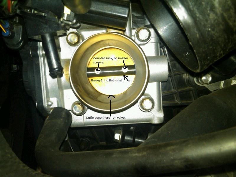

If you wanna do something to your throttle body, and getting a bigger one isn't an option, or you just don't have/don't want to put the money in, you can just optimize the stock throttle body... i.e. Knife-edge the butterfly valve, shave down the counter-shaft (I think that's what it's called lol), countersunk screws, etc. Stock throttle body, with better flow properties.
That was a big thing to do in the CDW-27/Contour world when I owned one before. Definitely made a difference in response
The correct size of the throttle body is 2.25 inches and it is more than enough , i'm currently turbocharging my 2 not cosidering any mod to the TB unless installing an aluminuim inlet manifold , which is not feesable at the moment
The ID of the TB is around 38mm, sadly I don't remember it exactly.
AN7 beat me to it. The OD is 2.25", but the ID is much smaller. From what I remember the screws are countersunk.

You'd be surprised how little effect tuning up a TB for ideal flow has on flow through it. It's turbulent as hell, having some random smooth edges in there does next to nothing.
