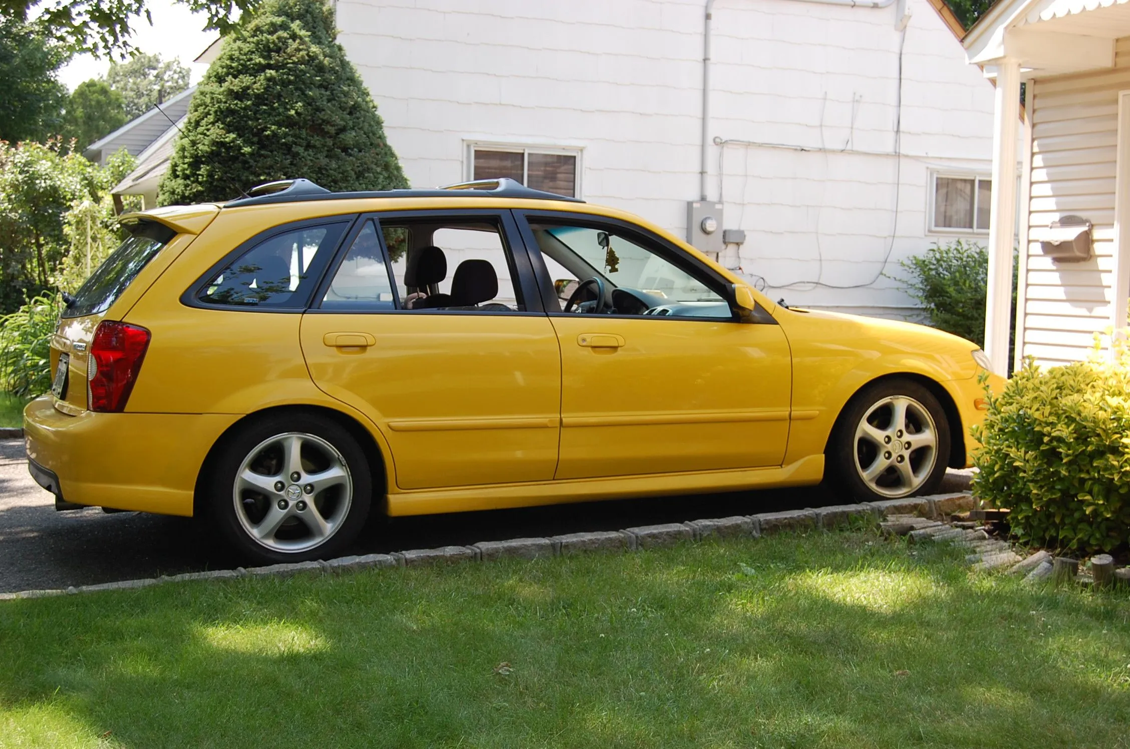

I recently put the Tokico kit from Protege Garage on my car. Nice drop, softer ride than I anticipated. Good for a daily driver. FYI ..I needed 2 washers on top each rear strut as spacers. When fully tight there was 1/8 inch of space left so it would clunk over bumps. Keep some handy when you install in case you have the same issue.
