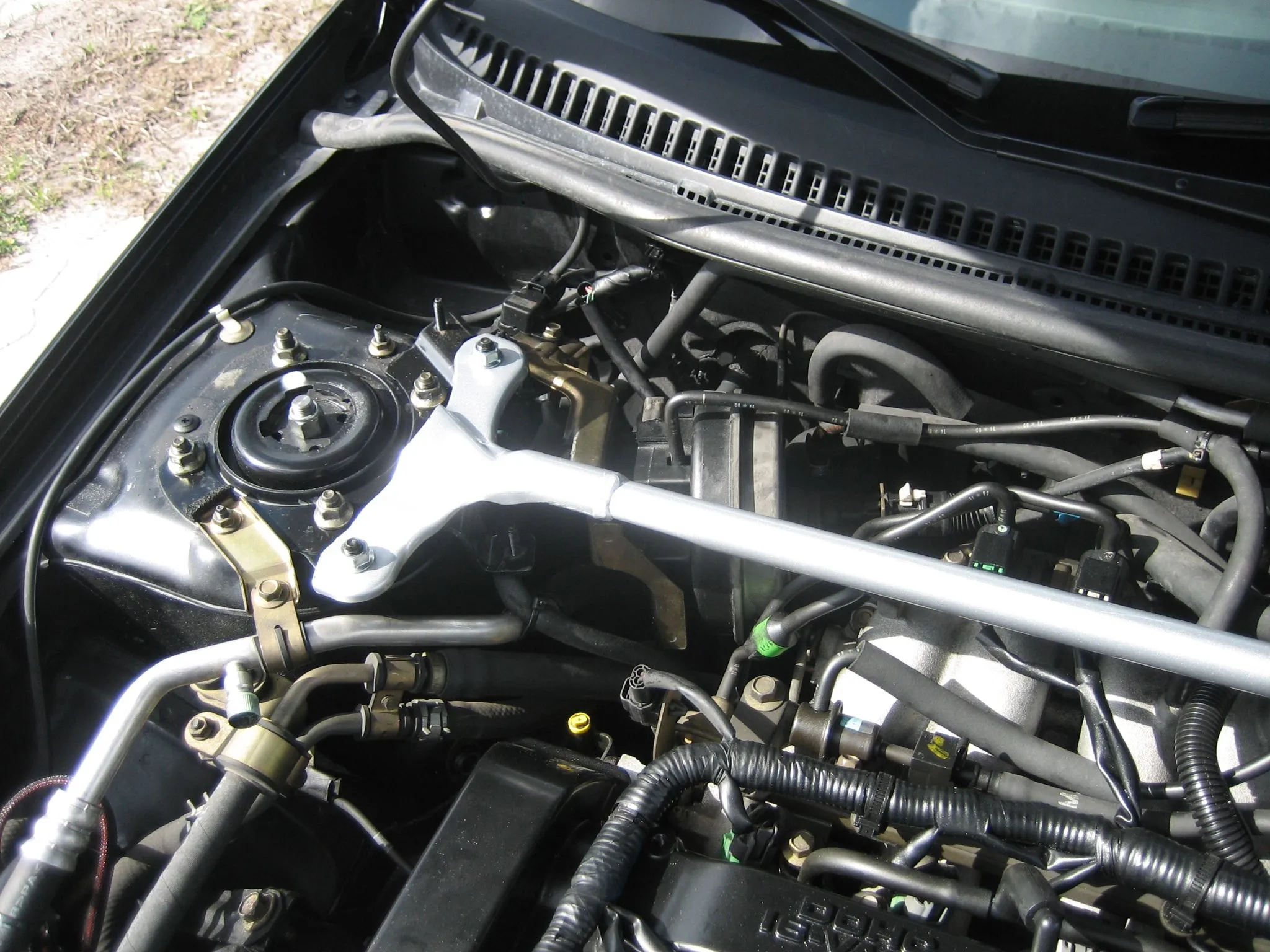

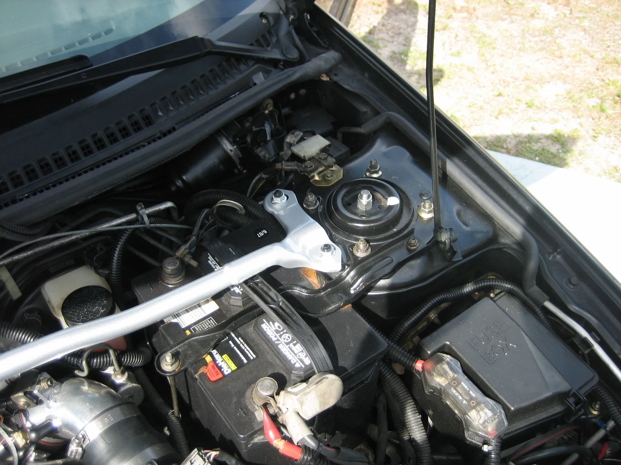

Mazdaspeed strut bar intalled on ES
I finished installing the strut bar from a mazdaspeed to my ES. It wasnt to bad... I bought all the parts from cheapmazdaparts.com and the only problem I ran into is that i had to move the cruise control out of the way and some other minor parts but it worked. You can see the pic below:

All front links are the same.
