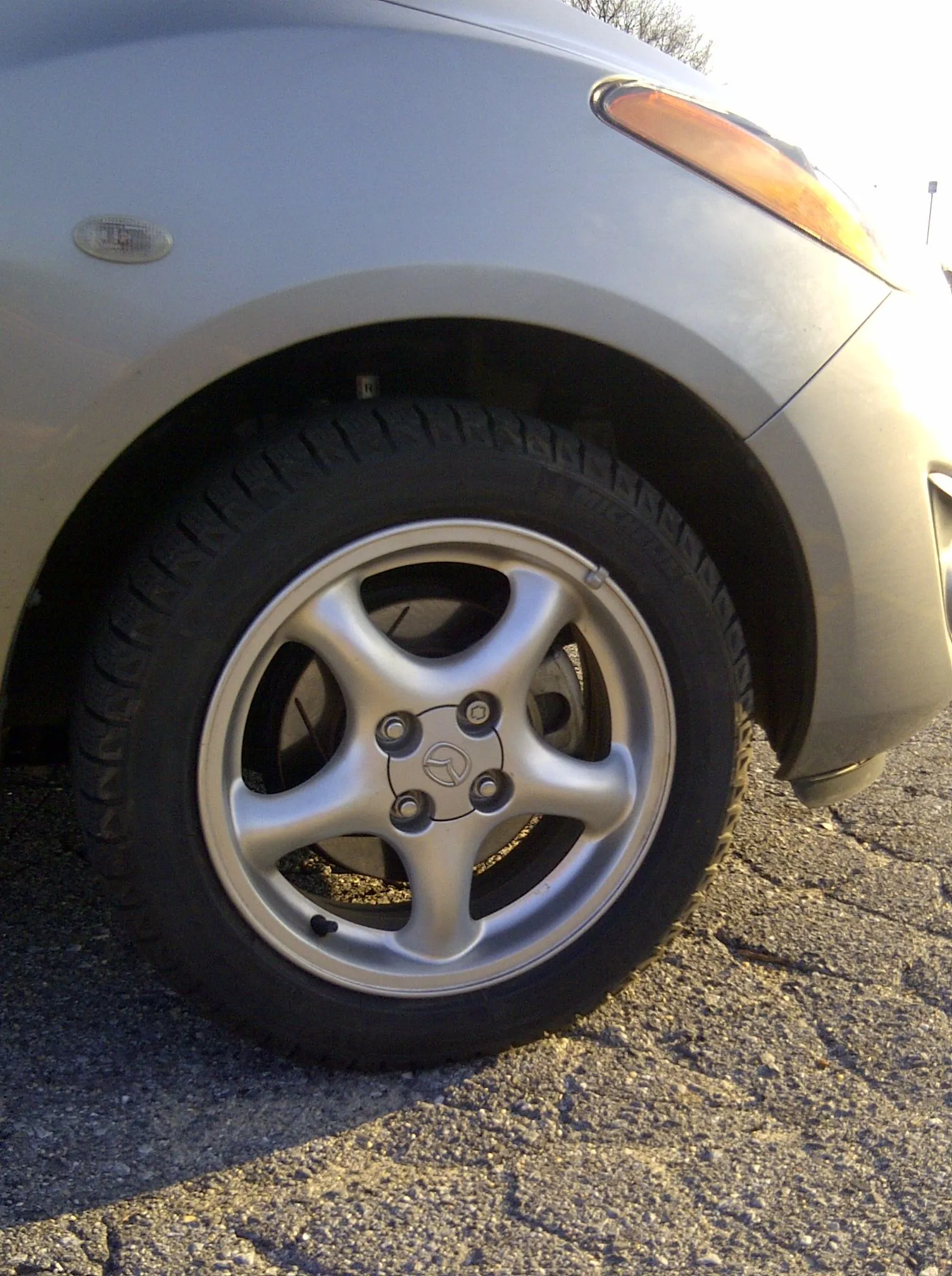

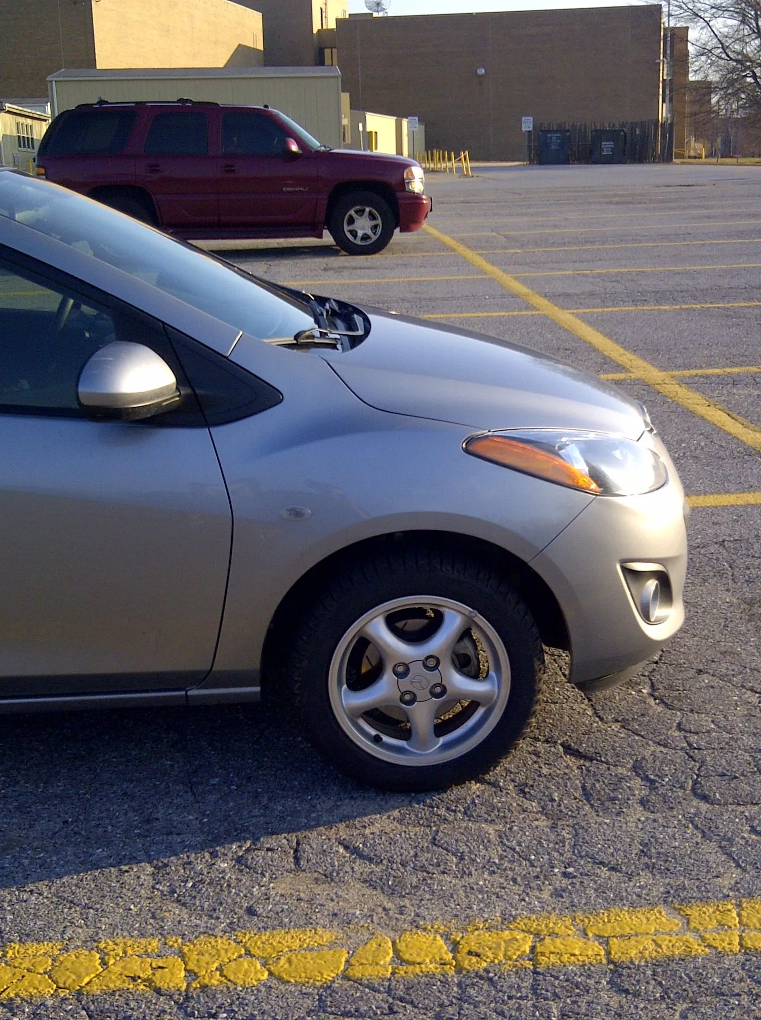

I have replaced my stock rotors/pads with Powerslot slotted rotors and Hawk HPS pads.
Can you post a picture of the rotors on your 2 . I was thinking of getting the Powerslots , I want to see what the Ecoat finish looks like with some miles on it . Thanks
Used a blackberry torch camera instead of a point and shoot but should be good enough.
Thanks for pics . The rotors are nice I like the look . I was wondering how long the Ecoat would resist the eventual rust all rotors seem to get .
