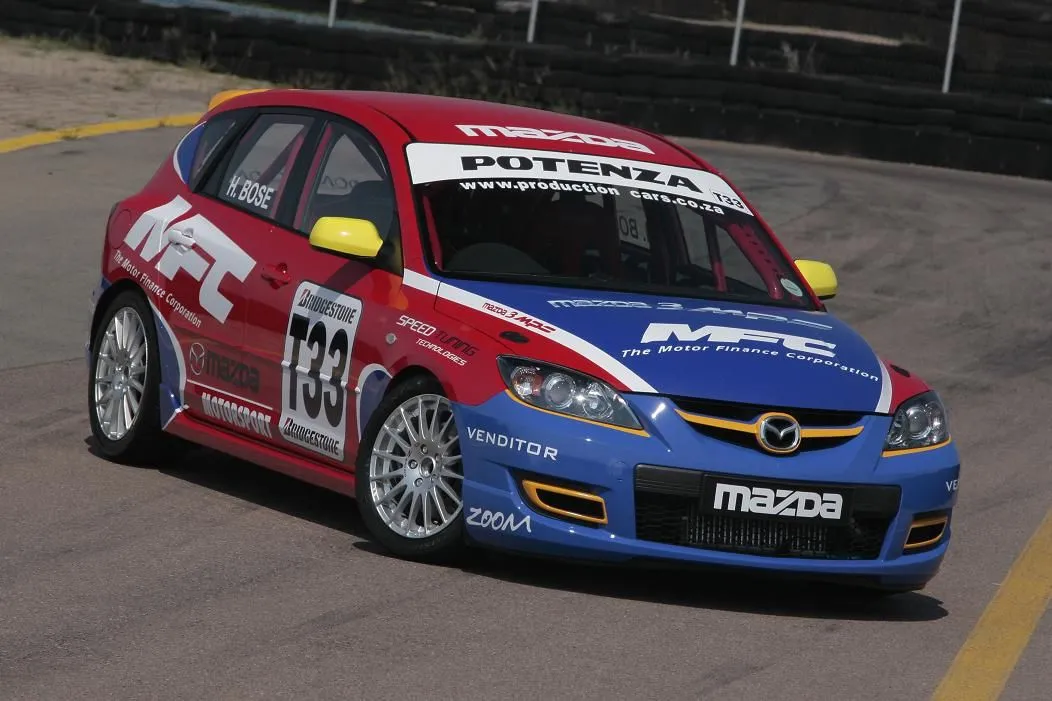

I am surprised more tuning companies have not picked up on this car, where are the fully built Mazdaspeed 3 racing teams? Very slow to market. Kind of like the recent Civic si boo
When do you think the replacements for the failing mounts will be out? Dunno if I want to replace the rear mount without replacing all the craptastic mounts.
i have to send them some pictures of the side mount where it contacts the battery tray, then we should see them all done
what you talkin bout captain?
the car pictured there is run by a professional race team, powered by parts from us and from cp-e. they have what i believe is CP-e's first front mount intercooler for the MS3 as well as our manifold and fuel pump, corksport downpipe, mazdaspeed air intake.
