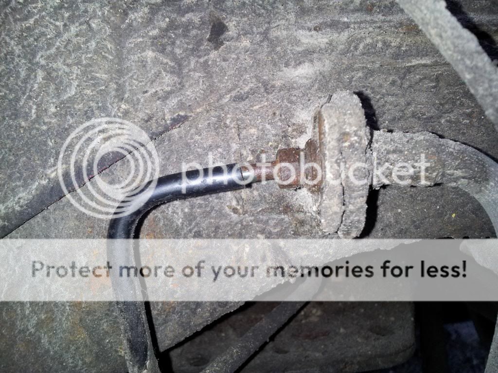

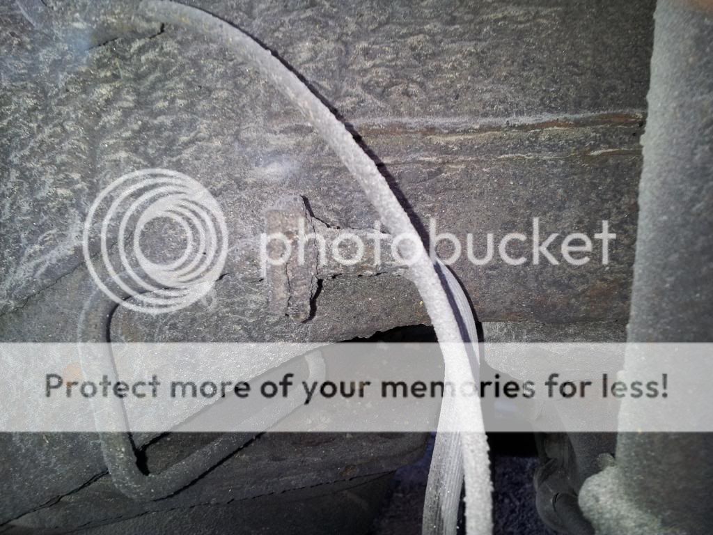

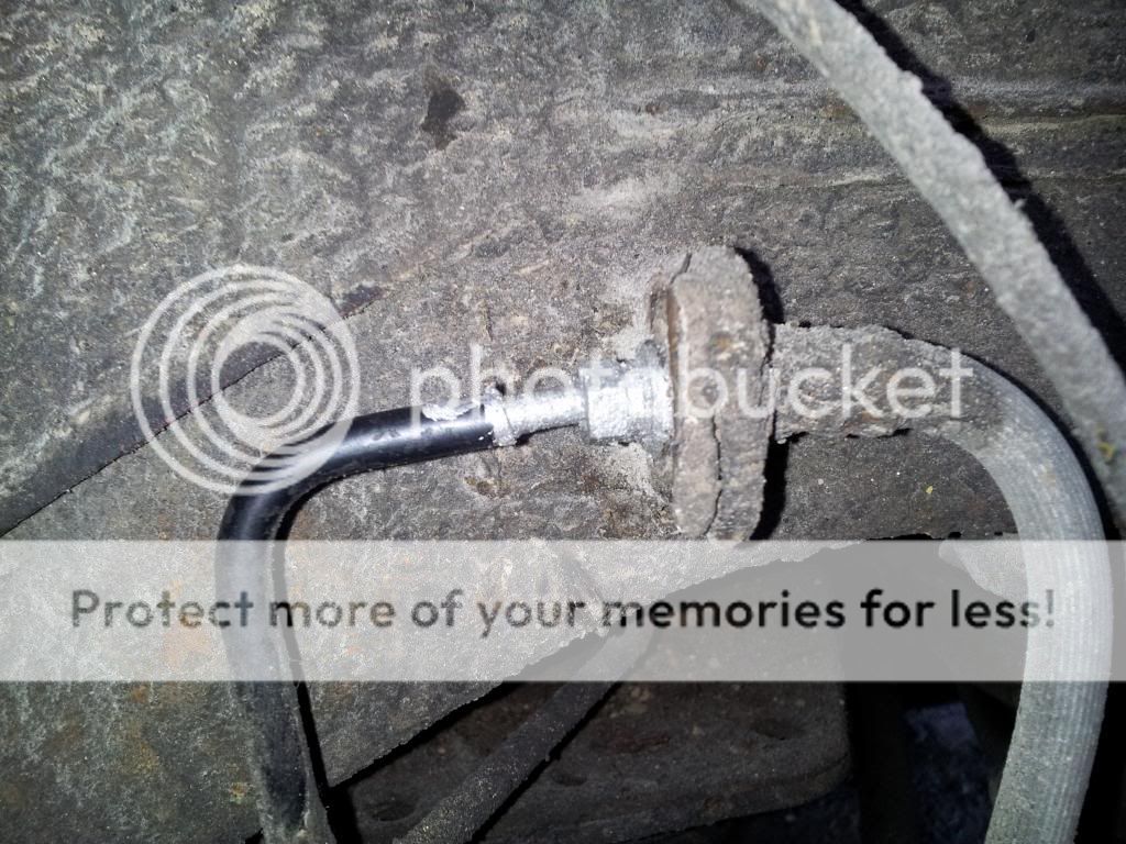

At least now our car has plastic fuel lines (for the most part) and plastic coated brake lines. (as compared to my 1985 Mazda 626). But I noticed that the plastic coating stops about 1/4" from the connection point on the struts. That is definitely the weak spot,... keep an eye on those spots in particular,... clean them up and put some heavy grease on them like anti-seize.
EDIT: The connection point isn't on the strut,... it's on the frame:
I'm really glad we don't have all metal lines then. With all the problems with rust, I would've started to be pretty scared about stuff like that.

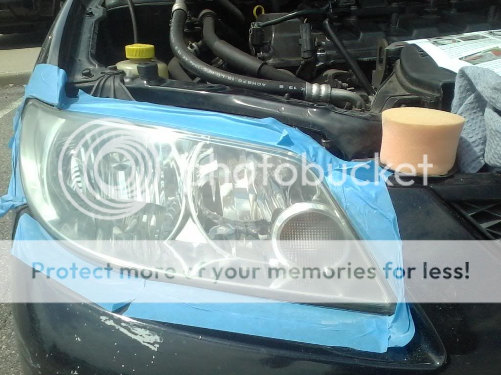

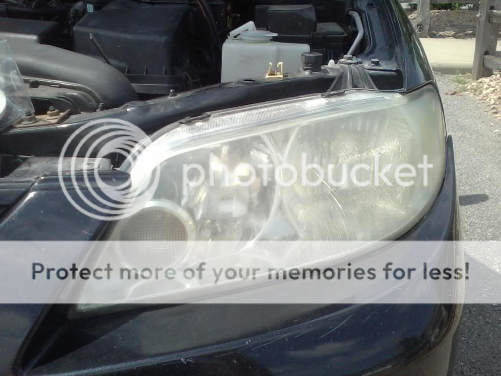

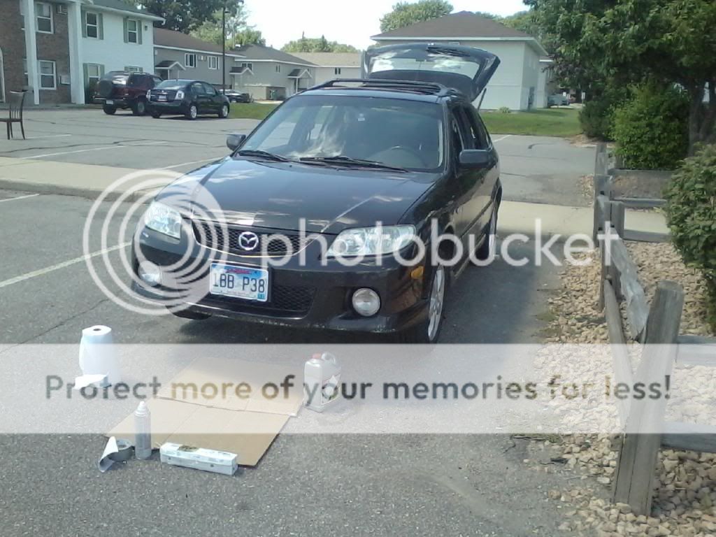

Got a couple things done yesterday! I restored my headlights (had to redo some fine sanding today on one of them), and they almost look like new! I ended up using the 3M Headlight Restoration kit, and it works really well! This sadly shows off the scratches on the inside of the driver's side headlight, and I have no clue about how those came about or what to do about them. But they look a lot better now, and it only takes about 20 minutes each light, if that.
Here's before:
And after:
I haven't had a chance to use my lights since then, but I also adjusted them so that they are aiming at the same spot, instead of having my driver's side light way higher (sorry if I blinded anyone with my lights). So hopefully tonight when I'm delivering they prove themselves.
I also did the mod for the foglights to be on with the parking lights, and I have to say it looks pretty sweet! Never realized how bright my fogs were until this mod.

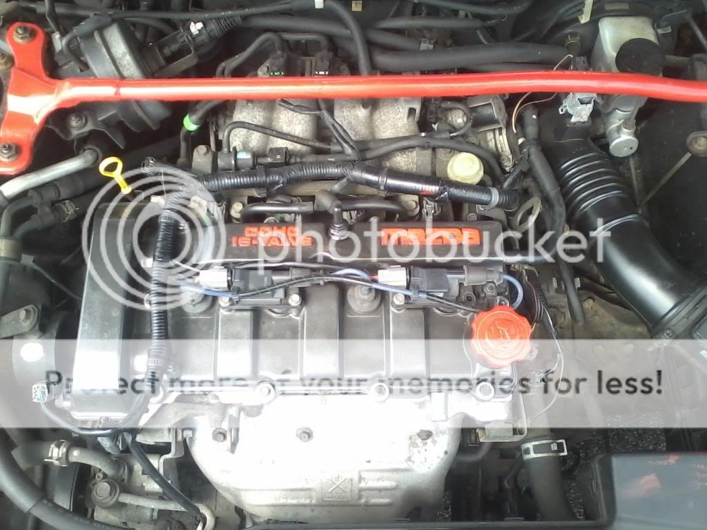

What I've done with my valve cover so far. I still need to touch-up the lettering though:
Looks good! In fact, those fog lights are pretty bright... brighter than mine. For one thing, I noticed that all of your foglight housing illuminates, whereas only the bottom half of my fogs light up due to the "hood" that partially cover the bulb. Are those aftermarket fogs?
Talk to Bastian about steelies on the P5. (He ran them in the winter IIRC) I'm thinking of getting a set for the winter and plastidipping them a vibrant color. Just cause. I'll try and get a set of snow treads too obviously. But at the end of the day, its up to you about what you do with your car! :) I'm going to give the 3M restoration kit a shot though, after seeing yours and many other peoples results, the lights look really good!
If you have a factory alarm and leave the switch on for the fogs, they'll flash at ya. I like it cause its unique. In the dark its pretty cool.
Those are the stock fogs I'm pretty sure, but I noticed tonight that there's a sliver on top that doesn't light up due to the housing. It never seems that bright though, because they get overpowered by the low beams, as they should I guess. Even though I kinda doubt it, do you know if that was a difference in the 02.5 to 03 model, or did you have to replace your bulbs?
KingOfSpades007 do you know if the factory alarm was an option? I have the keyless entry and it doesn't flash the fogs. I've heard some people goin back and forth on other threads and never really heard a definite answer on what the difference was. It would be cool for them to flash in the dark though! And I remember seeing Bastian's steelies, and they didn't look too bad! I feel like since my car is black and I might not have my rust repaired before winter that it might be better to go that route. Plus, it's only $35, which isn't that bad for me being a delivery guy. haha
But I defs recommend the 3M kit! I need to spend a little more time on my driver's side light, since I kinda rushed it. But it really does help! Delivering last night in the pitch black (despite the full moon) I could really see a difference in distance of my lights. Not so much in brightness though, which could be good for oncoming traffic.

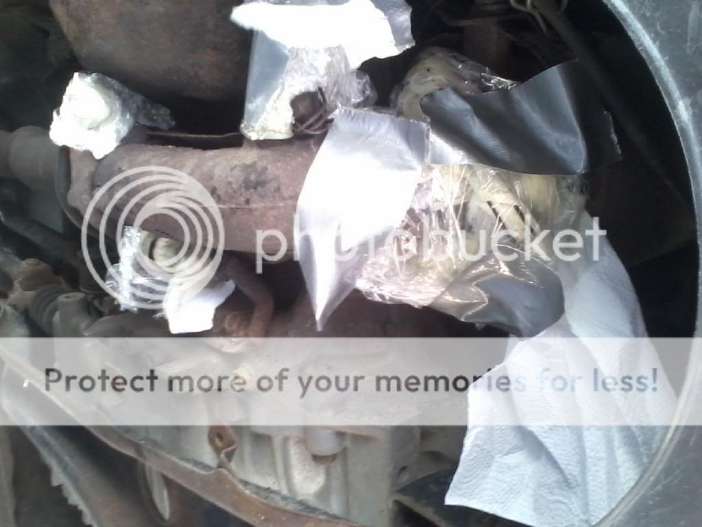

I'm still trying to fix my exhaust, but am struggling to remove the current pipe. I've been battling it for over a month and now I had three options left. I recently tried to use Evapo-Rust on it (and on my frame rails, which didn't really work) and I haven't had a chance to try and remove the pipe yet, but it doesn't look like anything has changed. You're supposed to soak paper towels in the fluid, wrap them around the rusted parts, and wrap it in "plastic sheeting", which I can only assume to mean saran wrap. So this is what it ended up looking like:

I also Seafoamed the engine, but I may need to redo it again, because I couldn't get the Seafoam in through the brake booster tube (I was working by myself). I did get a little smoke show going from putting it into the oil and gas tank, so here it is, although you can see to the right all the smoke coming out my exhaust leak (that's what I'm checking halfway through). Hope you enjoy:
I also did an oil change and changed the plugs and he's runnin a lot smoother now! Now I only need to fix my exhaust and hopefully that gets rid of the vibrating shifter. I can definitely tell which plugs were affected when my coil pack failed a couple months ago:
