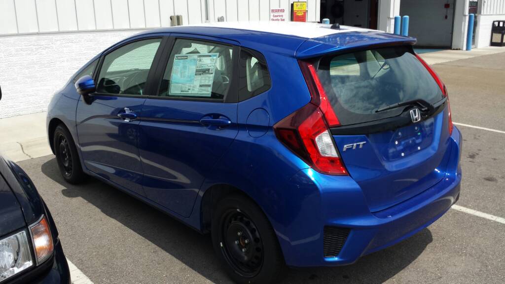

I think I'm finally gonna be getting the Fit tomorrow, and so Ozzie will be getting a much-needed break. My hope is that I will be able to refinish my rims (winter and summer) during this time, fix my exhaust leak, and look into many rattles that have made themselves known lately. I'm also trying to decide whether or not to go ahead and do clutch/tranny work. I wouldn't do it myself, but my clutch will need to be replaced soon, my 5th gear synchro is getting a bit worse (has always been touchy) as is my reverse synchro, and I thought for a while that my 3rd gear synchro might be getting a little weird (was stiff for a couple weeks). I'm just about to cross 175,000 miles, and wanna make it to 200k, but I'm starting to get a little worried. Heading into senior year, and my finances are gonna be shrinking a bit (cutting down hours and leasing the Fit), so I'm kinda torn. Thoughts?
