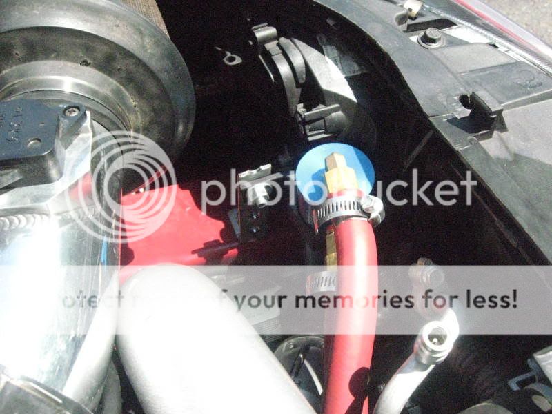

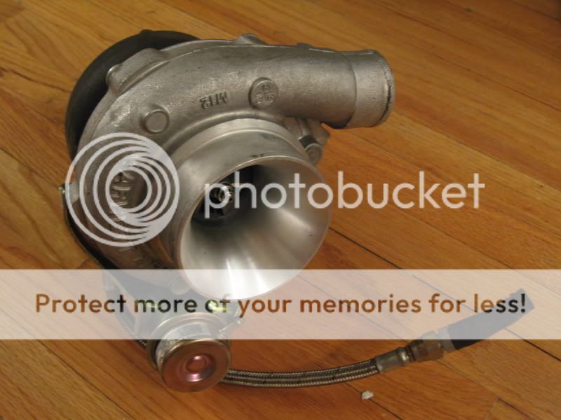

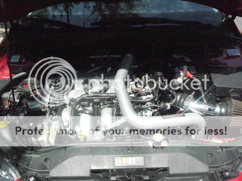

Sure, Here are some crappy pics.
Engine bay
FMIC
Catch Can

The 30R
