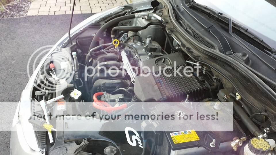

Here's my take on the ECU/Big Ass plastic box thing that drove me nuts after I installed my Corksport SRI. So I cut it off! This summer I will remove it, clean it up a bit with JBWelds, a grill for the hole on the side and make mounting brackets.
View from the side
[/URL][/IMG]
