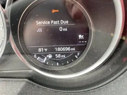

2nd Gen CX-9 High mileage club, how's it holding up?
Here's one for sale with 180,000 miles, looks new.
