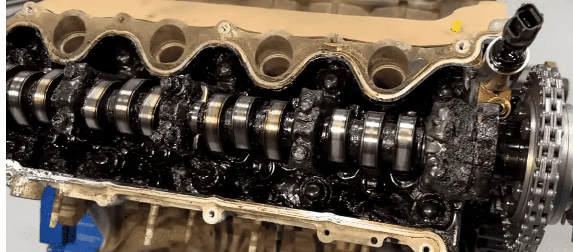

It took more than 8000 miles without an oil change to destroy this engine, but without oil changes this always happens. No warranty nor extended warranty nor manufacturer goodwill will repair this. Change the oil every 7,500 miles with top quality oil (it doesn't need to be synthetic) and quality oil filter, or every 3,000 miles with cheapo oil and filter.
IMO 8,000 miles won’t destroy an engine like the picture showed unless a really crappy non-synthetic oil was used.
Remember Toyota has been using 10,000-miles OCI for the last many years, and with a super-thin 0W-16 oil.
UOA from Blackstone Lab frequently suggested the used oil still has another thousand mile of service life after 7,500 miles on CX-5’s 2.5L NA.
