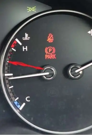

Hello! Occasionally, the temperature gauge rises above half (which corresponds according to the scan tool to 100 degrees Celcius or 212 F). Last week the temperature was around 230 F, no coolant leaks and the rad fans were working. The dealer tells me it's normal when it's hot outside...

It would be a big plus if you could either get a picture of the reader with ECT at or very close to 230°F, or perhaps capture it via live date recording. If you get that evidence, then you could open a case with Mazda Corporate, who would almost certainly ask your dealership to diagnose this abnormal issue.
