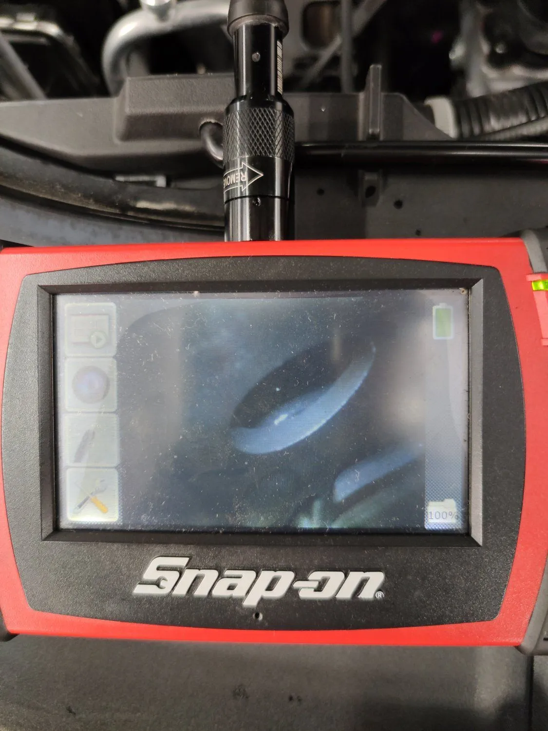

Update:

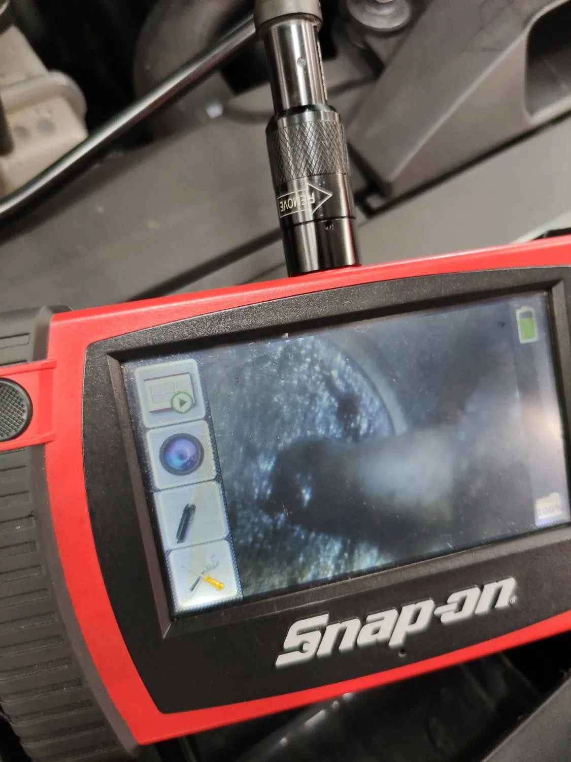

I was able to scope one of the intake valve with cylinder inspection scope, take a look.
manifold itself is clean
The intake valve has carbon build up on them, it is expected of course(direct injection). This is not that severe or anything.
Note: this was after i ran cleaner through the intake, but i mean its prob not that bad in the first place.

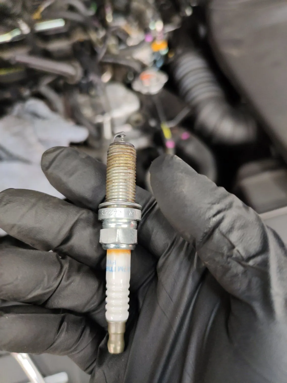

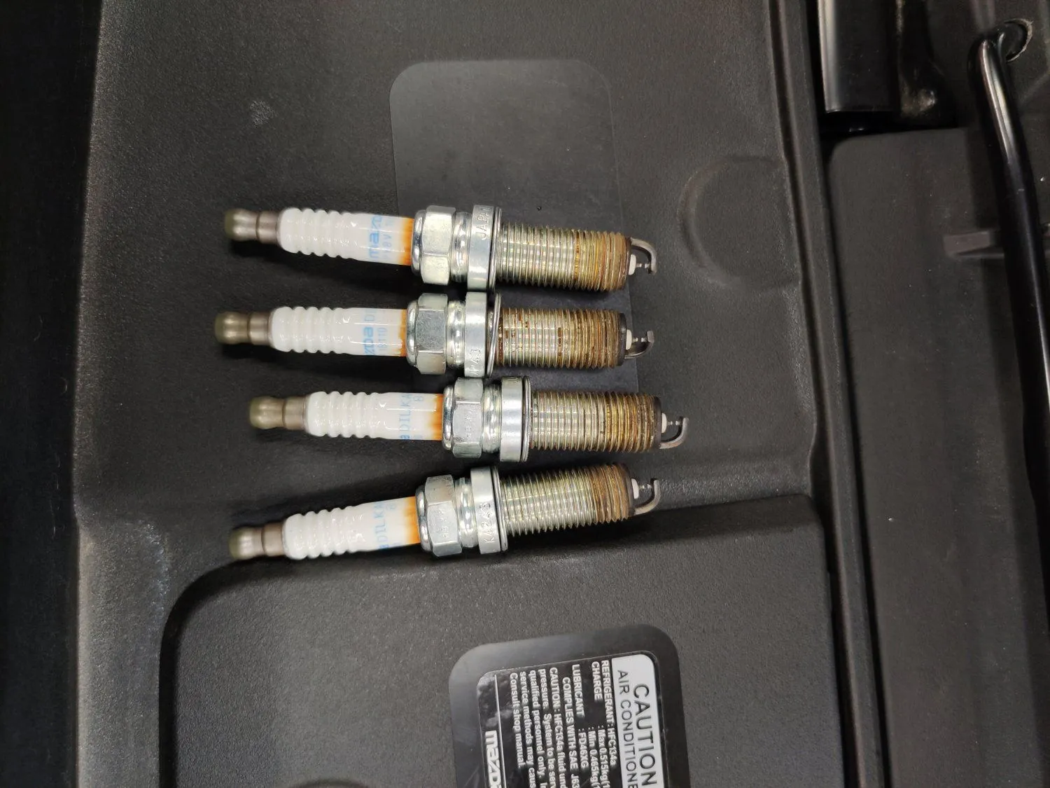

Misfire is still there of course so i pulled coil and plugs after work.
take a look
Coil are in excellent condition, so i did not take any pictures, i inspected cyl#3 plug in detail, as you can see it has no cracks and the gaps is consistant on all plugs so i see nothing wrong with it.

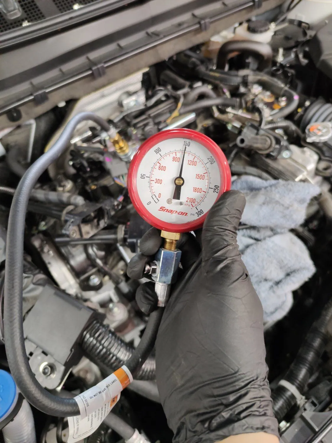

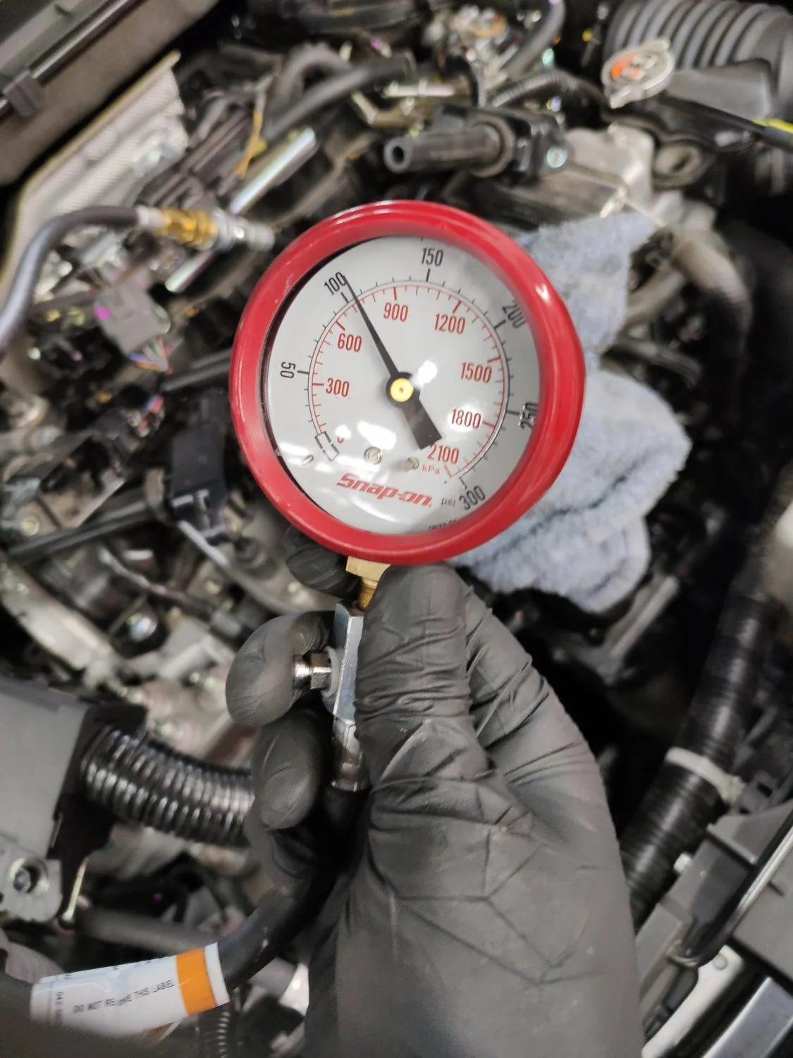

With everything removed, i went ahead and performed compression test, again i tested the result twice to make sure it was correct so here it is.
cyl#3
cyl #4
As you can see, cyl #3 only has 110 psi,comparing to cyl #4 which had 150 psi. it is lacking 40 psi of compression and yes i did compression test on all cylinders to verified.
This indicates possible valve seal or piston ring failure, it is unknown why this happened and again the dealership refuses to do anything and told me to monitor it and wait for CEL(check engine light).

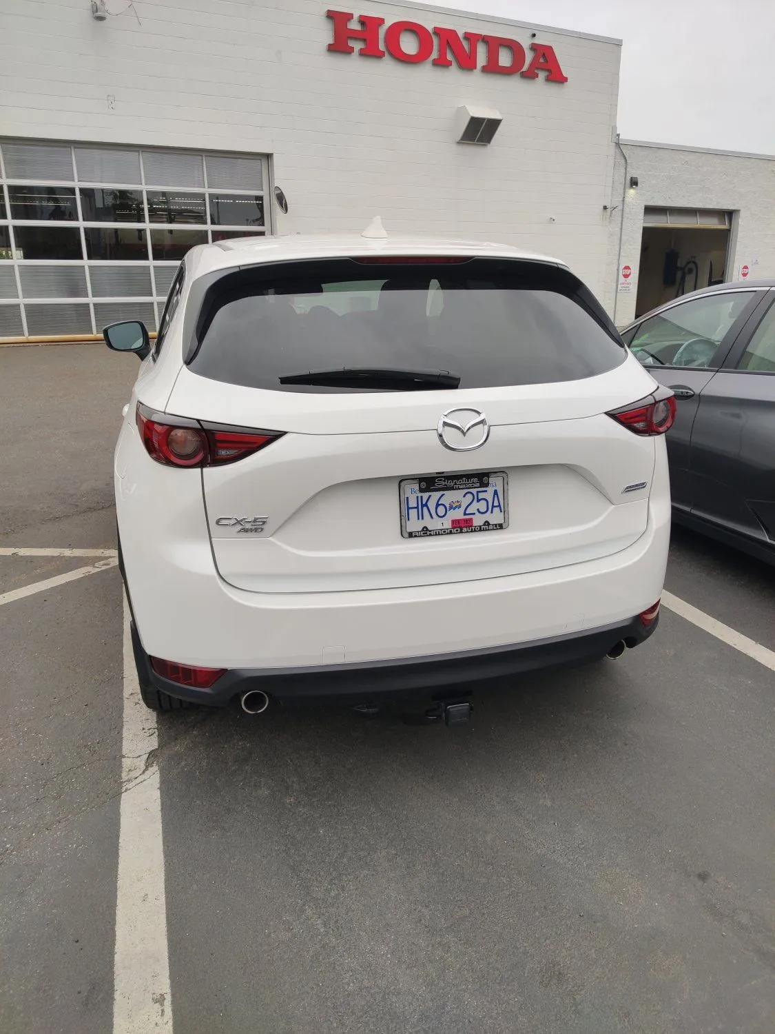

This concludes the story and my cx5 for now, I will be picking up a 2020 possibility next week or so, i still need to take off the trailer hitch, mud guards and hitch harness.
here is some pic of this beautiful beast
Love those black rims!

Update:
take a look
View attachment 225372View attachment 225373
cyl#3
cyl #4

This concludes the story and my cx5 for now, I will be picking up a 2020 possibily next week or so, i still need to take off the trailer hitch, mud guards and hitch harness.
View attachment 225376View attachment 225377View attachment 225378
