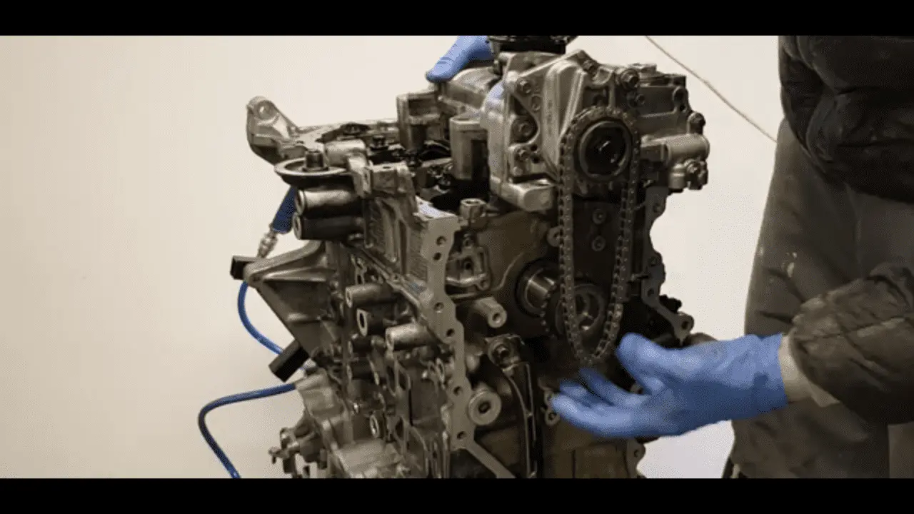

No, the oil pump on Mazda’s SkyActiv-D 2.2L diesel has a dedicated chain which is not the timing chain. The oil pump chain would break without warning and the engine is ruined because of oil starvation. See the link I posted above in another thread. Those Mazda 2.2L diesel owners in Taiwan are trying to push the government to force Mazda Taiwan having a recall on this problem. The same they did successfully on sudden overheating problem.
In this picture the Mazda 2.2L diesel is up-side-down showing the huge oil pump and its dedicated chain:
Yes and that huge oil pump has a box filter which needs replacement in some cases. In order to replace it, oil pump has to be removed from the bottom part and dismantled.
