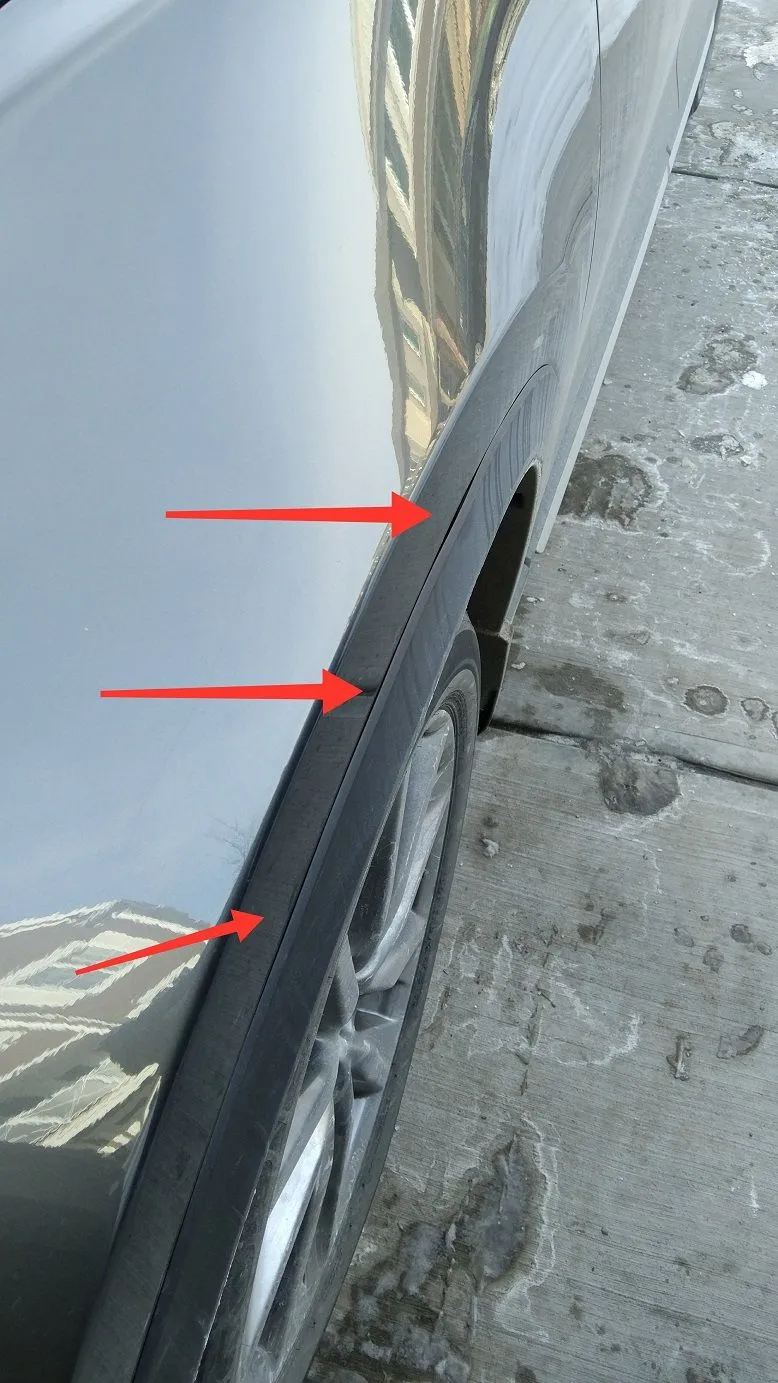

A few days ago, I noticed that my front two fender liner/guards started to either deform or begin to come loose. There are visible gaps that most would not notice, but when comparing to a brand new CX-9 on the dealer lot, the issue is clear. Immediately up front, the dealer agreed that this wasn't normal and ordered the parts to replace it.
There are only a couple of things I can think of. Either the dealership that did my first oil change somehow messed with the fender guards (unlikely since you don't need to touch those to do the oil change), or the guards somehow warped or came loose due to the change in weather. Anyway, parts have been ordered and will be installed as soon as they come in.
Here are pics of the gaps (same on both sides). The rears do not have this issue.
attachment.php
My CX-9 recently started showing signs of this gap, similar to @sm1ke, but on both front fender trims. What can I do to fix this gap? Do I have to replace the entire trim piece?
I replaced the entire piece on passenger rear. Kids damaged from putting ski boots on while resting feet on door sill. Bought online. Parts came with all clips. Easy install.
