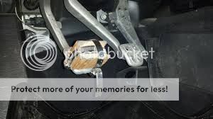

I did find a humorous (at least for me) temporary fix...see below...(toilet)
I will check with some mechanics I know about a fix.
