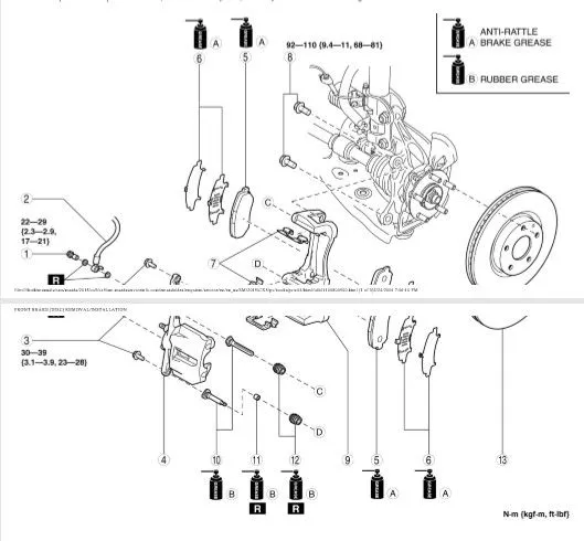

Anyway, bedding the brakes in is a way to break them in. This is a bit of a long read, but details everything, scroll down to "prevention" for the actual process: http://www.stoptech.com/technical-support/technical-white-papers/-warped-brake-disc-and-other-myths
In a nutshell you're creating enough heat quickly to apply a transfer layer of pad material onto the rotor surface as well as burn off paint and resin from the manufacturing process. Once it is allowed to cool properly the two mating surfaces will bite nicely and you'll be getting the best performance from your new products. Some folks will argue this is overkill for commuter-based street pads and rotors. However, even just simply driving around town does a similar process, but not as effectively. The first time you have to make an emergency stop will get that transfer layer on and unevenly. Chances are you'll feel it as vibration or judder some time later.
The hardest part is finding a stretch of road where you can do the deceleration maneuvers consecutively without stopping.
