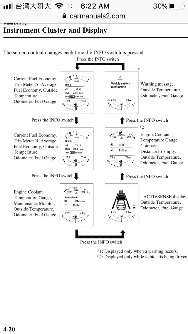

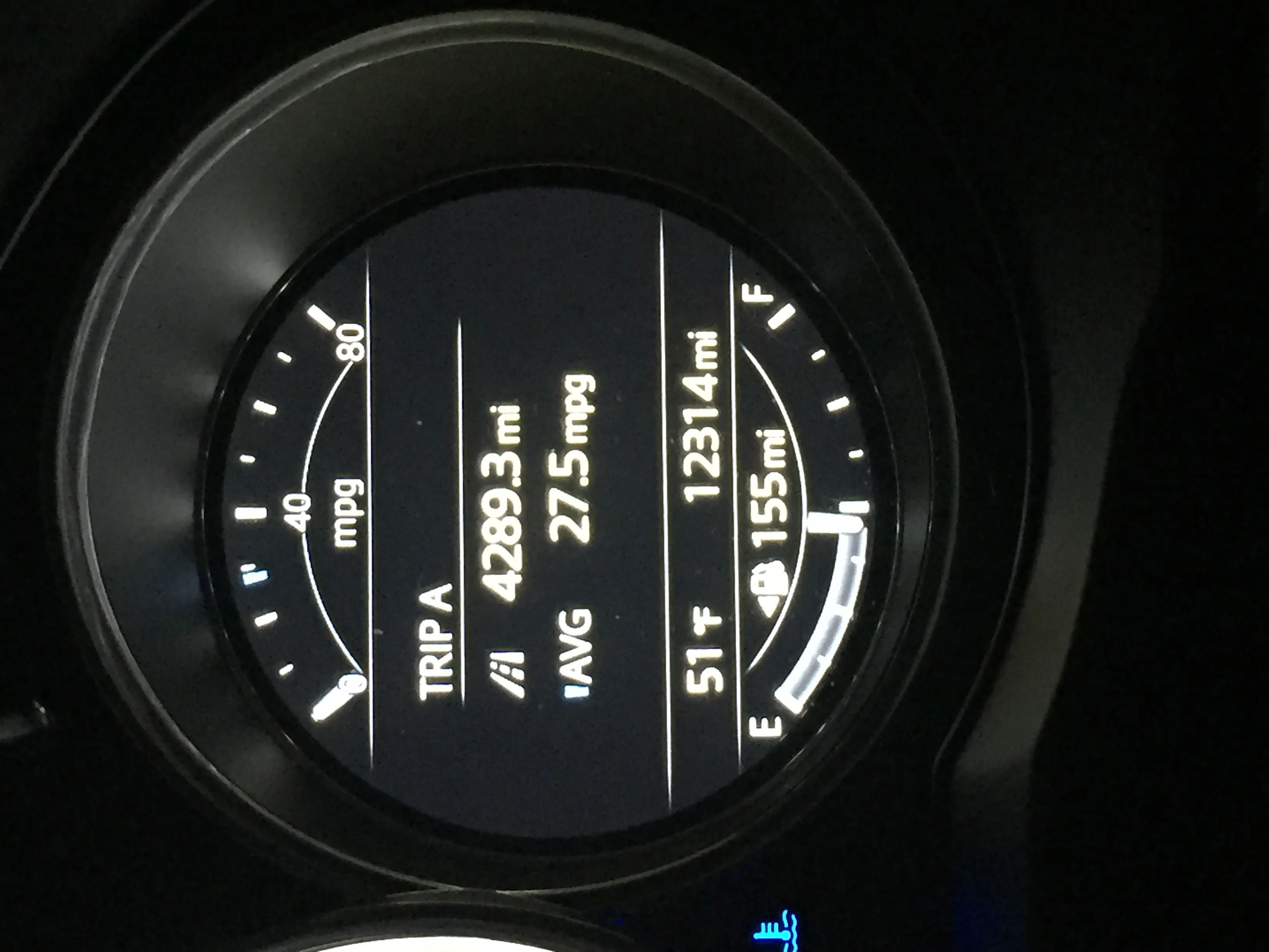

Mine just has the little gas pump. Is yours a 2018 cx-5?

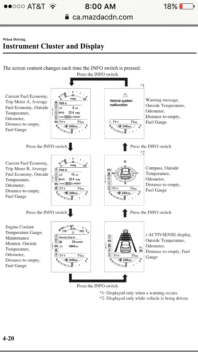

Yep, youre right! 2018 CX-5 has eliminated constant Distance to Empty display just above the fuel gauge! I definitely like the way of 2017s with constant Distance to Empty display just above the fuel gauge; and a much nicer compass! Another reason to get 2017 over 2018 CX-5 in addition to cylinder deactivation!

Yep, you’re right! 2018 CX-5 has eliminated constant “Distance to Empty” display just above the fuel gauge! I definitely like the way of 2017’s with constant ”Distance to Empty” display just above the fuel gauge; and a much nicer compass! Another reason to get 2017 over 2018 CX-5 in addition to cylinder deactivation!
2018 CX-5 Instrument Cluster Display:

Just noticed, miles to empty is on the compass screen.
Problem solved!
Problem solved!

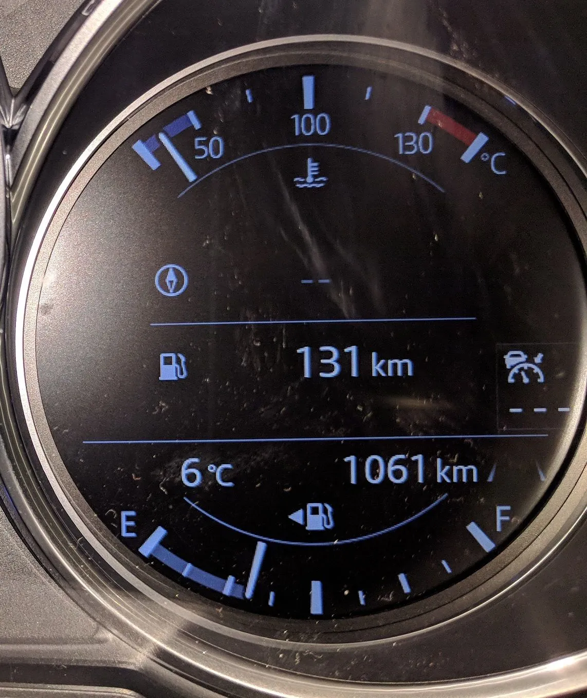

Thats the only screen to show Distance to Empty. You have to move away from other info to see it. I think it should be displayed constantly like 2017 serving as a secondary low-fuel warning. Thiss what the OP wants but unfortunately his 2018 CX-5 simply cant do it.
Here's what it looks like on a 2018. I am parked on P2 of my condo garage, so no compass reading could be obtained. The estimated remaining does not show on any other screen.
Kilometres (kms) are 0.6 of a mile. I should get about 520 km on this tank or around 320 miles.

Wow. I'm completely perplexed as to why Mazda would eliminate the DTE in the fuel display. The only thing I can imagine is that people were confused with so much information in front of them. Now, for 18, you have to scroll through displays to see DTE. Strange.

I'd like engine temp to be always visible, too, but it's not. Maybe Mazda does think it's info overload. OP wanted to know if MTE could be visible on Trip A or B for the 18, and we discovered that's it's not. But is is available elsewhere. Like it or lump it.
