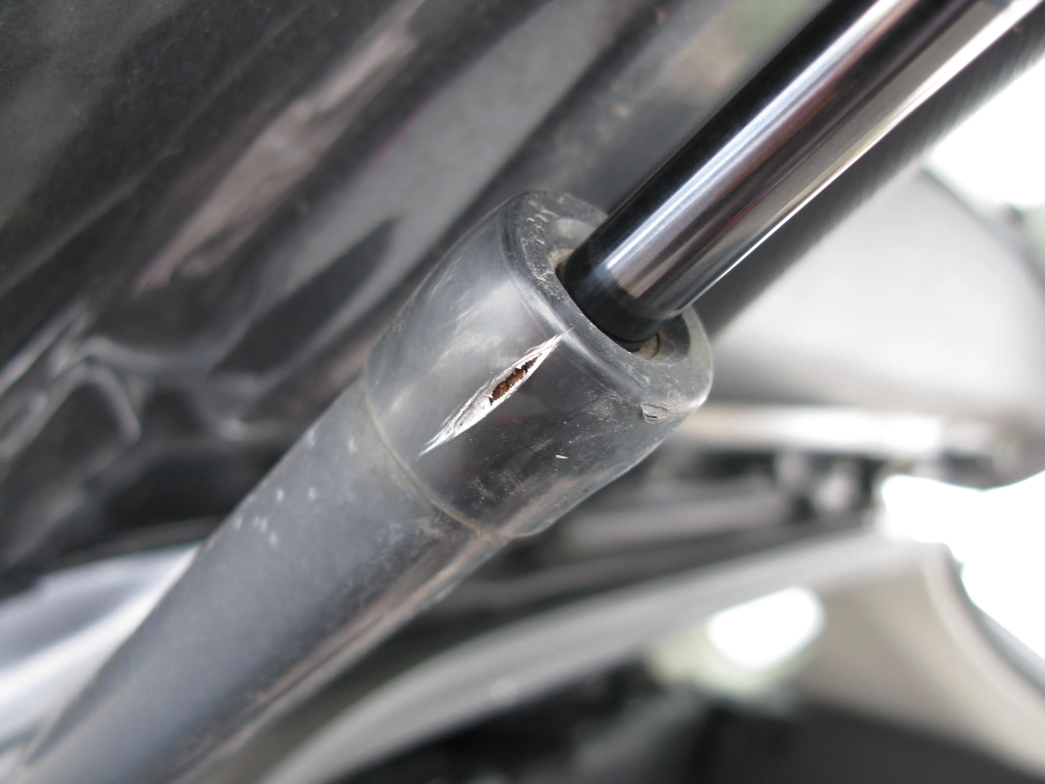

I had a back and forth with MazdaUsa about when the parts for this recall would be in. They said sometime in April. I went to have a look at my dampers and saw the end cap splitting, see picture. I called my Mazda dealer today and told them what was going on. They set an appointment on Monday, they're going to take dampers off a newer CX5 and swap them with mine because parts wouldn't be available until May. I suggest anyone with an older CX5 go out and take a close look.

Here you go MADAR, I posted your pic up for others to see...
That looks ugly! I see what looks like the salted road spray has been trapped under the plastic endcaps, and the rust heave has actually split the plastic end cap!

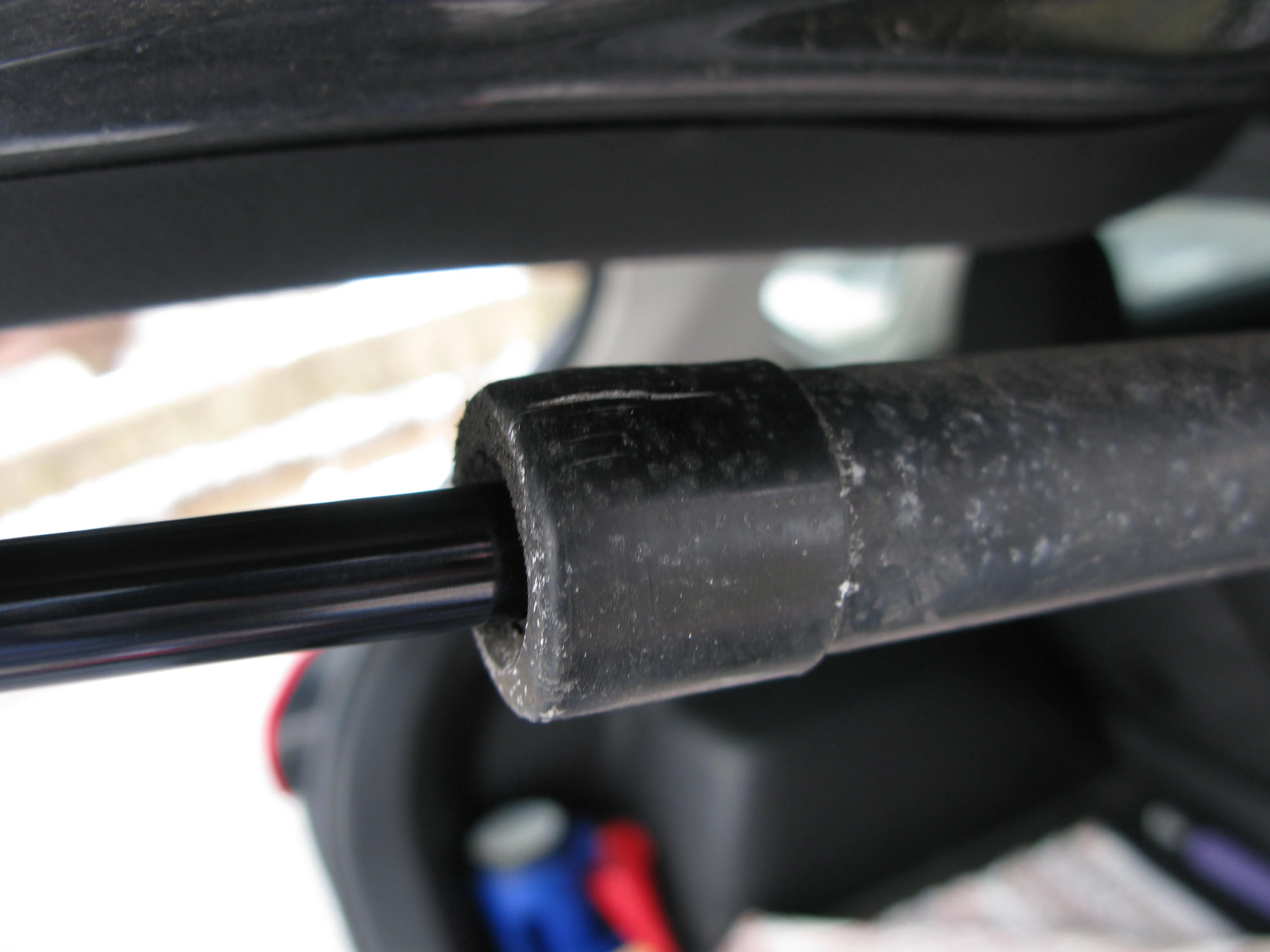

Makes me wonder if they used struts from different sources. Mine are pristine after 44k miles and 4 Minnesota winters. Always garaged though (unheated). Is that the difference?
<a href="http://s13.photobucket.com/user/minnesotaart/media/DSCN1670_zpse4kkomm4.jpg.html" target="_blank"><img src="http://i13.photobucket.com/albums/a296/minnesotaart/DSCN1670_zpse4kkomm4.jpg" border="0" alt="Left photo DSCN1670_zpse4kkomm4.jpg"/></a>
<a href="http://s13.photobucket.com/user/minnesotaart/media/DSCN1672_zpstvicjpia.jpg.html" target="_blank"><img src="http://i13.photobucket.com/albums/a296/minnesotaart/DSCN1672_zpstvicjpia.jpg" border="0" alt="Right photo DSCN1672_zpstvicjpia.jpg"/></a>
Good point, I see yours is a SHOWA brand...known for motorcycle shocks...
attachment.php
You're right. I was wondering what could cause a split like that but forgot that rust takes up more space than the original metal.

Yeah, a lot of salt worked its way up there. I put on 70 miles a day during the week and the crap from the road gets washed up in there. The thing is badly rusted under the cap. Vehicle is always outside. If this is what Mazda is talking about then they need to light a fire under some ones butt and rectify their parts situation.
