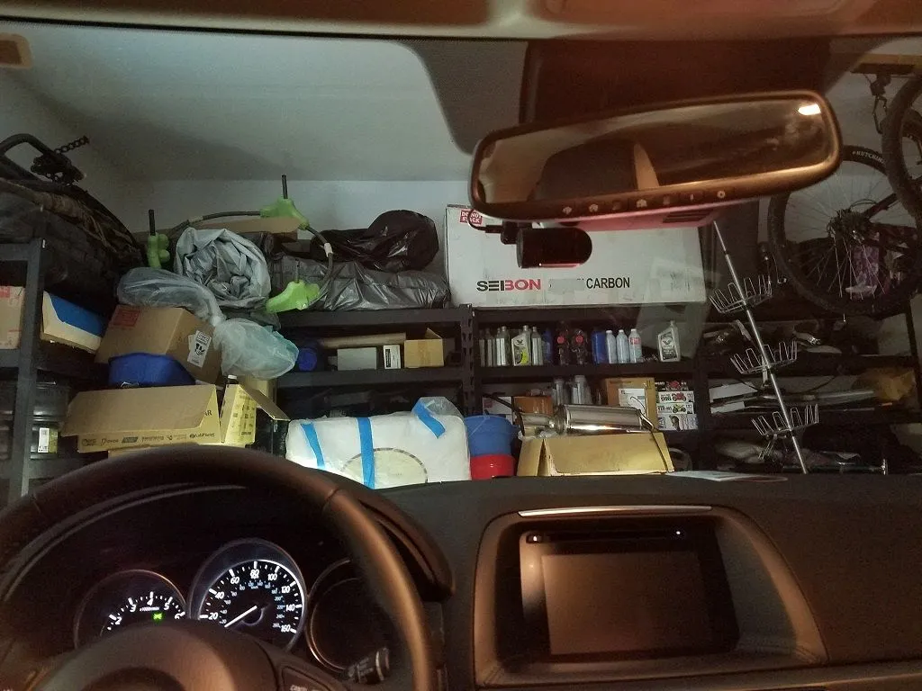

I installed a mini 0805 in my wife's 2016.5 grand touring over the weekend. I ended up using a 15' micro-usb cable up behind the rear view mirror, then right along the passenger side headliner, down the passenger a pillar, down behind the glovebox and then out into one of the two usb plugs in the center console.
All the radar/sonar stuff took up a lot more space for mounting, so here is a picture of where I ended up mounting it.
I have the same thing as you and in the same spot. I power it from the mirror and stuck the 12v to 5V adapter in the ceiling. There is a July 2016 firmware out, if you are not aware of it.
