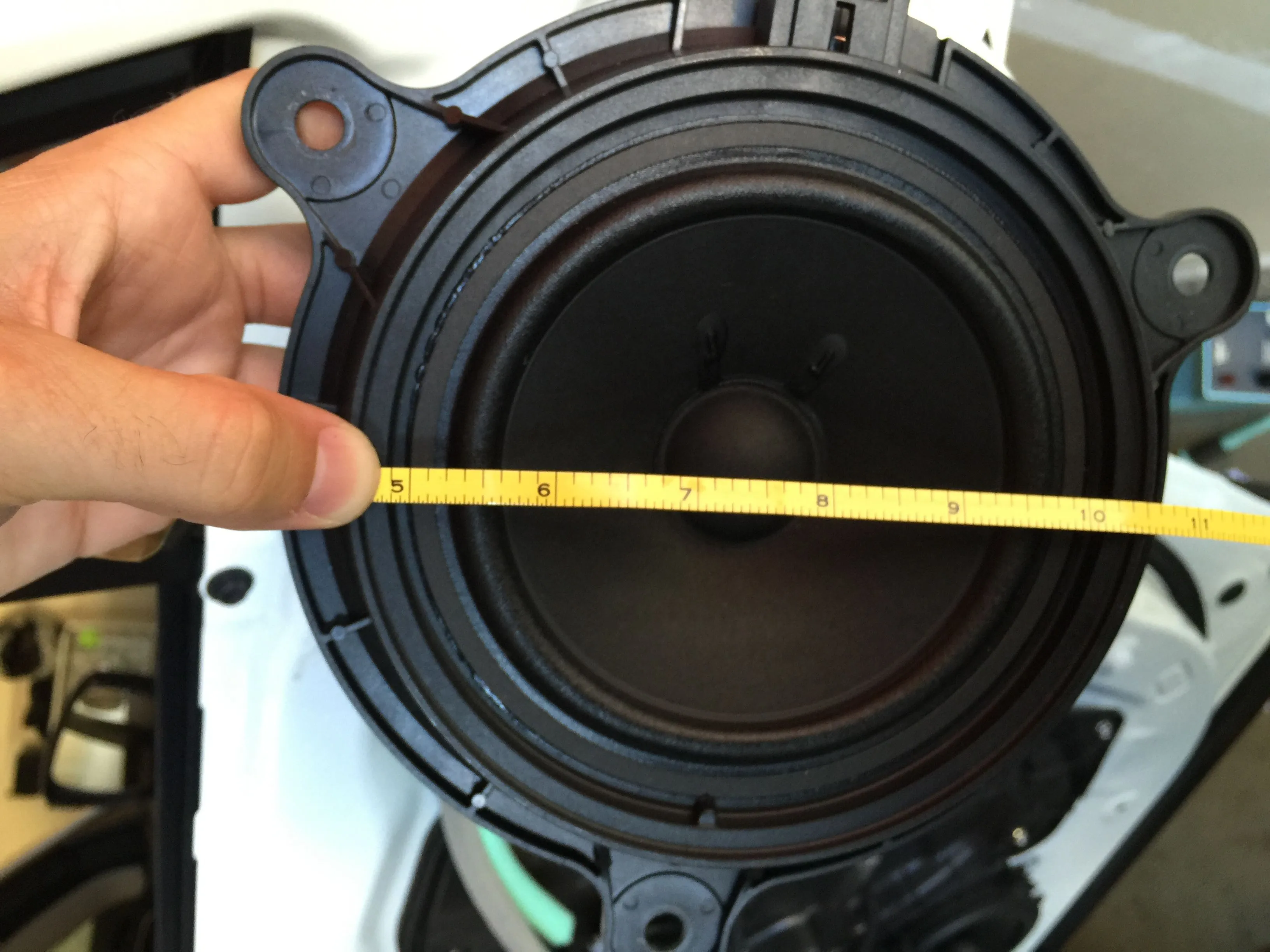

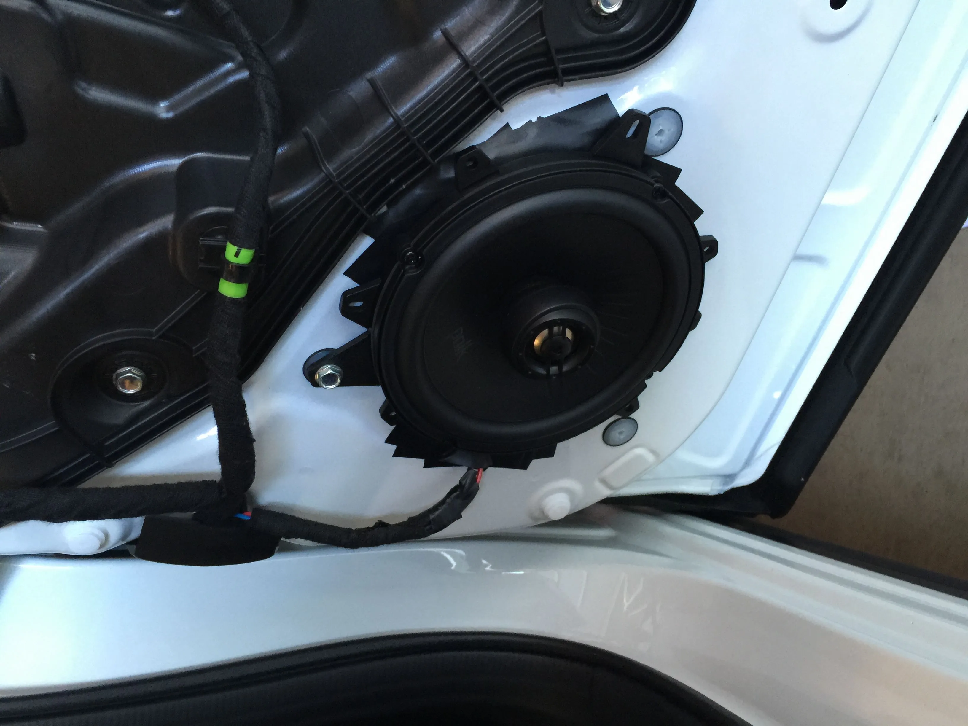

Here are some pictures of the rear door speaker install I did. I replaced the stock 5" (?) speakers with Polk dxi651. Polk adapter plate was only able to capture two screw holes.
Thanks for posting some pictures of your work.
RLCarrington said he had to get OEM speaker mount grommets for the rear door speakers, and drilled/installed those for the 3rd hole that did not line up.
These rear door Bose speakers are 5.25" midrange speakers. Now I'm confident that these 9 Bose speakers on 2016 CX-5 are very similar to those on new Mazda6 less two 1" tweeters located in the instrument panel. Boy are these Bose rear door speakers piece of crap or not? Cheap paper cone with nothing else to improve the high notes! Wish I can see pictures of those 9" Bose Nd front door woofers and 3.25" mid-range dash Twiddlers.

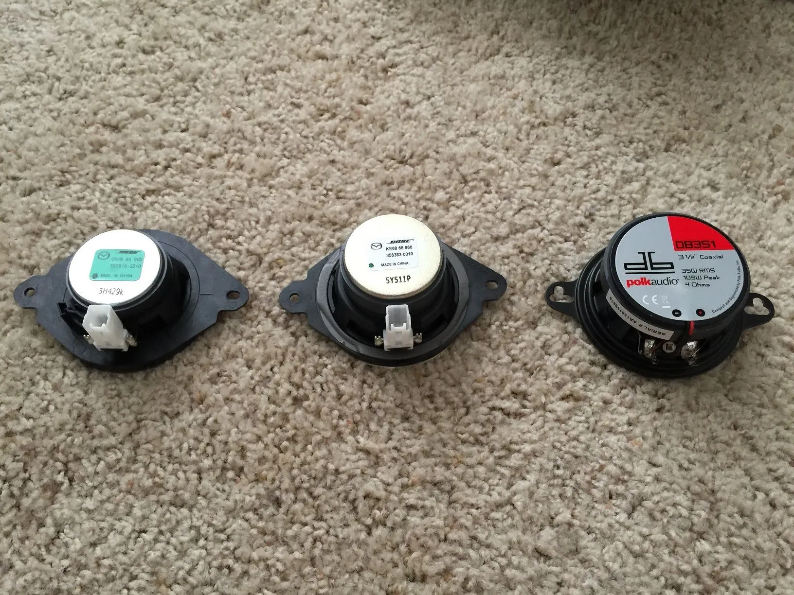

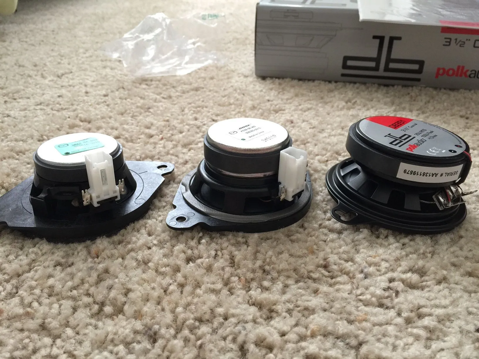

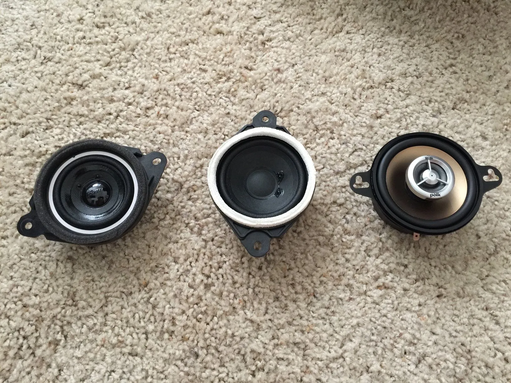

Here are some comparison pictures of the stock bose left/right dash speaker (shown left), the stock bose center dash speaker (shown middle) and the polk db351 (shown right). The polk weighs the most obviously, the center channel bose speaker weighs slightly less, and the left/right speaker weighs 1/3 of the Polk. The bose speakers have a much smaller woofer cone too, so I wouldnt say they are truly 3.5" speakers.
Personally Polk speakers have always been good to me so I was happy to use them. The specs are good and build quality is good. Infinity speakers are also pretty good, but I'm more of a Polk person.
2016%252520CX-5%252520Bose%2525203.25-inch%252520%2525288cm%252529%252520Mid-Range%252520Twiddler%2525C2%2525AE%252520Dash%252520LR-M-Polk%252520Audio%252520DB351_03.jpg
2016%252520CX-5%252520Bose%2525203.25-inch%252520%2525288cm%252529%252520Mid-Range%252520Twiddler%2525C2%2525AE%252520Dash%252520LR-M-Polk%252520Audio%252520DB351_01.jpg
2016%252520CX-5%252520Bose%2525203.25-inch%252520%2525288cm%252529%252520Mid-Range%252520Twiddler%2525C2%2525AE%252520Dash%252520LR-M-Polk%252520Audio%252520DB351_02.jpg
Thanks for your time taking those great comparison pictures. It's hard to see, are stock Bose speakers sealed from the back (the magnetic side)? These stock Bose dash speakers are actually smaller 3" (8cm) metric-sized speakers. Since many people had done it, Polk Audio 3" DB351 should be able to fit in without problems. Like you , I've always liked the sound quality from Polk Audio speakers and I'm going to order 2 sets of 2-way coaxial PA DB351 replacing these crappy mid-range Bose dash speakers.
