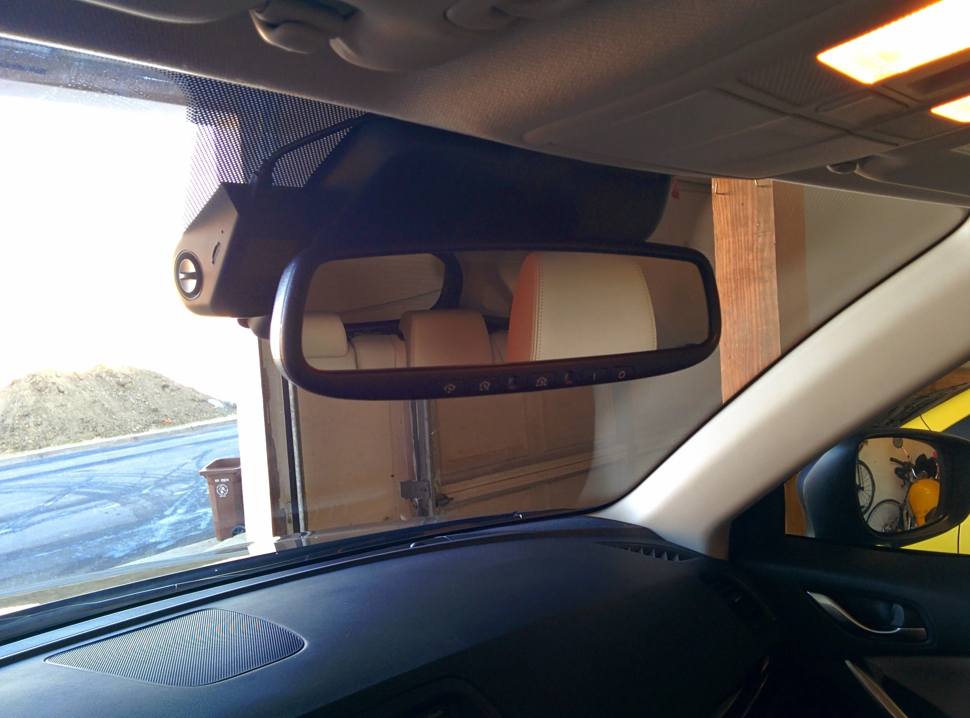

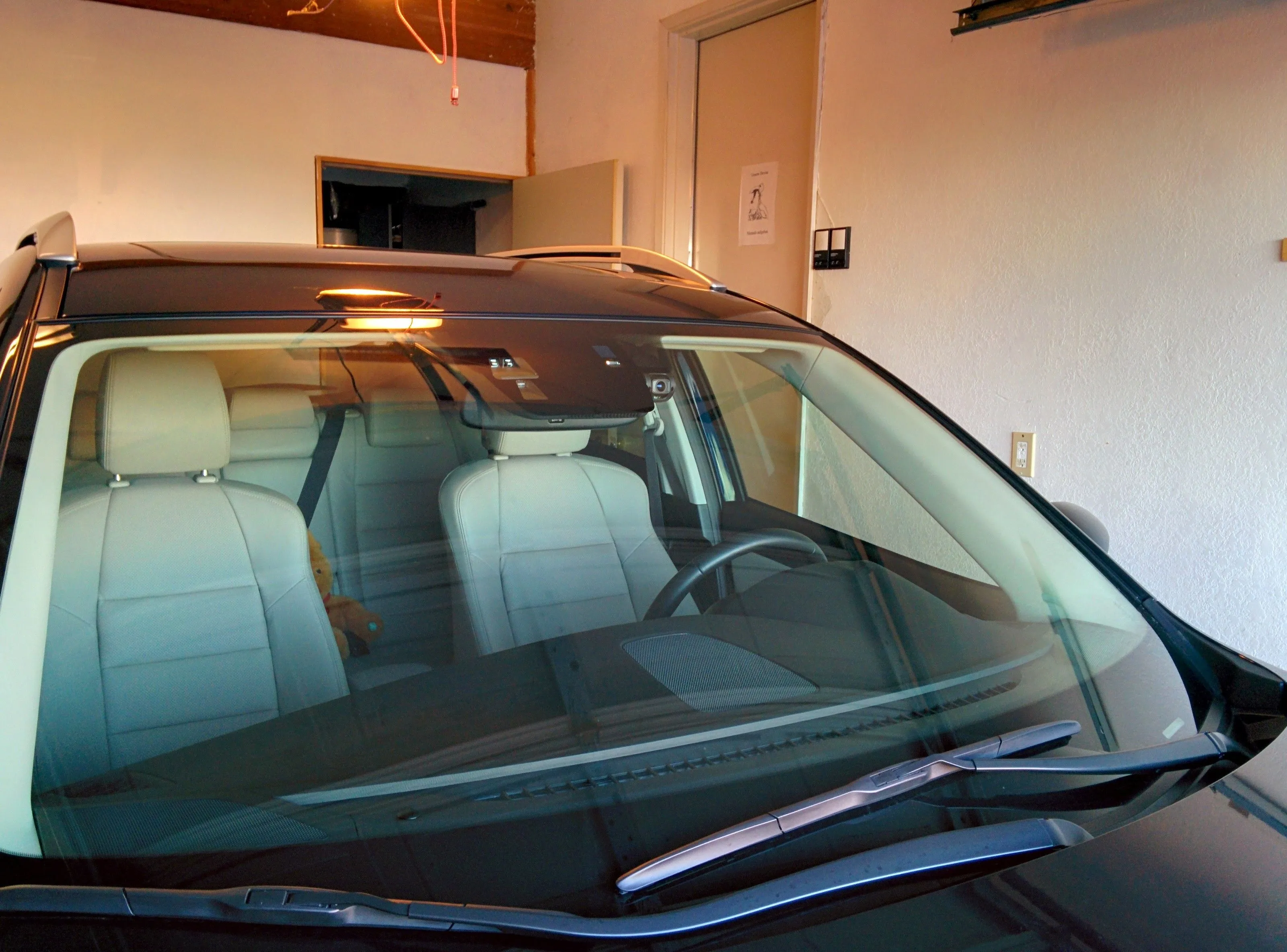

I have had a Mini 0801 mounted on the sensor cover for over a year now. I have just removed it and waiting for the new A118 to arrive.
I will place it next to the sensor on the left side where the black spots are. I believe this shape of dashcam is the best for the future, for placement, etc..

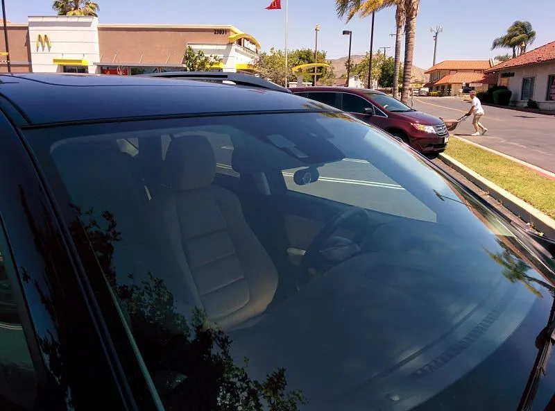

Weird coincidence...... I have the mini 0803 mounted directly in front of (behind?) the rear view mirror; can't even see it from the driver's seat, and blends in well from outside the car. The temporary wiring to the cigarette lighter can be *very* well hidden, and I see no need to permanently wire it.

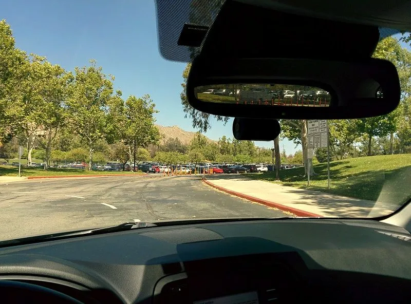

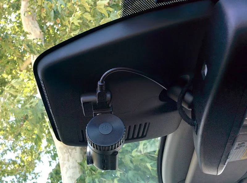

Here are the photos of my Mini 0801/0803 mounted. I've taken it off last week and waiting for the A118.
Thanks! I think I would mount it next to the mirror and higher up. Do you have both the mini 0801 and 0803? if so, which is better? I have been reading reviews that show the 0803 has a clearer image & better night vision, but there have been a lot of reported problems with it shutting down/not starting and even MELTING. I would want to avoid that headache and go with what appears to be a tried and true 0801 where all the kinks have been worked out.

It's mounted that way because of the huge sensor cover area. On the sides, because of how the 0801 is shaped and works, it was the best place for center view and coverage. The camera points to the right from the mount, so putting it on the left side of the sensor area, it would be way off center, and putting it on the right side it's too exposed.
I have the 0801 original. My friends have the 0803. Their mounts seems very sturdy and tight. Mine is loose and wiggles, and with the heat, if I don't check it once in a while, it'll fall off when i make a huge wide turn. No melting issues and I live in southern california.

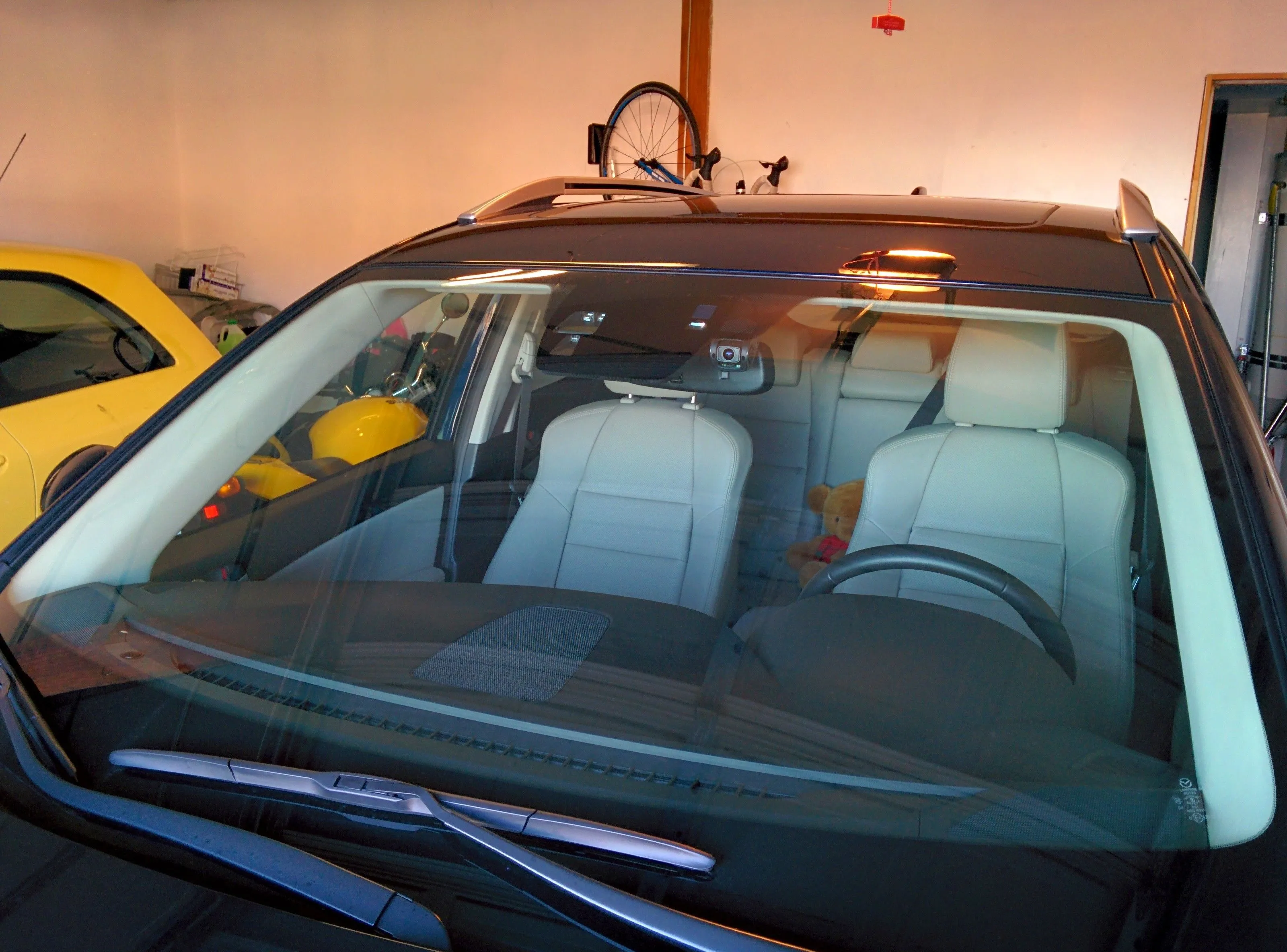

I've had the A118 since August and I think it works great. I have it mounted to the left of the rain sensor cover with the camera lens lined up directly below those black dot things. I didn't hard-wire it in, but instead routed the wire through the headliner, and along the passenger pillar, and have it plugged into switched cigarette lighter until I feel comfortable hard-wiring it at some point. I put some electrical tape over the blinking red light because it's annoying while driving, and I know it's on because the screen will stay on for a about a minute after turning the car on. Otherwise, I never notice it while driving.

That's awesome, That's where I plan to put the A118 also. I'm going to try to put it up a bit higher so just the top of the lens is right underneath the black dots.
