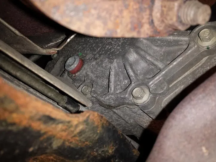

Hi guys, I'm new to the forum. I had a 2008 Mazda CX9 GT with 32500 miles on it. I just changed the rear differential oil and while I'm at it. I wanted to change the transfer case oil too, after spending 30 minutes looking for the drain plug, couldn't find it... help me please. Oh I did find the fill plug though. Any suggestion will appreciated. thanks

Dapple08, is that a removable cover that the fill plug is screwed into in your picture? I am thinking that cover must be removed to drain fluid. I had a rear diff like that on a Jeep some years ago. It makes job a little harder but still doable by a home DIY mechanic.
